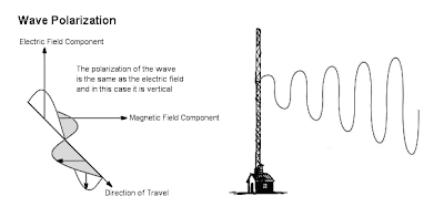

  17. bwilson4web
    29,111
    16,552
    It may be time to review Faraday's Law as applied to ferrite core antenna: RADIO-TIMETRAVELLER: An Unassuming Antenna - The Ferrite Loopstick
    Radio waves have both an electrical component (E) and a magnetic component (H). They are 90 degrees in relation to each other and also 90 degrees out of phase. Looking at a signal eminating from a typical vertical AM broadcast tower, the groundwave electrical component (E) is vertical, or perpendicular to the ground like the tower, and the magnetic component (H) is horizontal, or parallel to the ground. Receiving antennas respond mostly to one component or the other: small, closed loop (less than 0.1 wavelength in wire length) antennas to the magnetic component, open-ended wire antennas and large, closed loop antennas to the electrical component.
    What this means is an electronic wave can be measured either by looking at "dV/dt" but also "dB/dt". where B is the magnetic field.
    (from Wikipedia: Faraday's law of induction - Wikipedia)
    Detecting the magnetic component is just as valid and that is what this part does:
    MPU-9250, 9-Axis Gyro+Accel+Magn, InvenSense Inc.
    I know, this is hard stuff. You have to understand calculus to even interpret the formula and understand its implications. Yet it is how all radios and how ElectroMagnetic Interference (EMI) exists.
