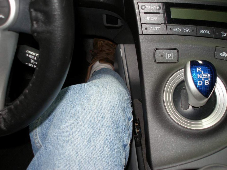

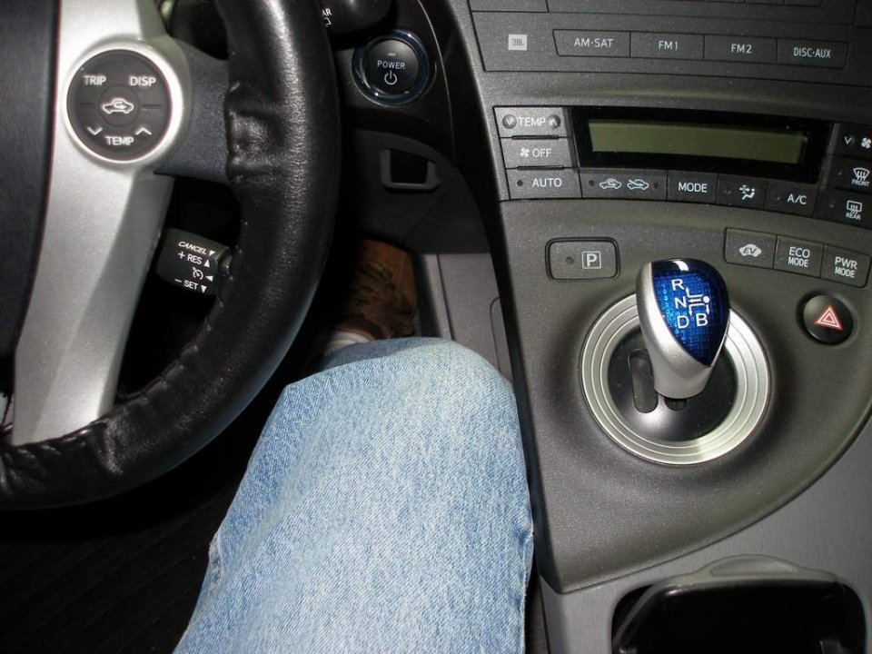

    Right leg falling over, hitting console has been just as big a problem. $20 clipped on board in $25k car to avoid the problem. Not too surprised given the console no other car has and the cheapo parts bin barely-adjustable steering wheel.
    Tall, long legged buyers beware. May not be the car for you.
    Disclaimer: Use device like that below at your own risk

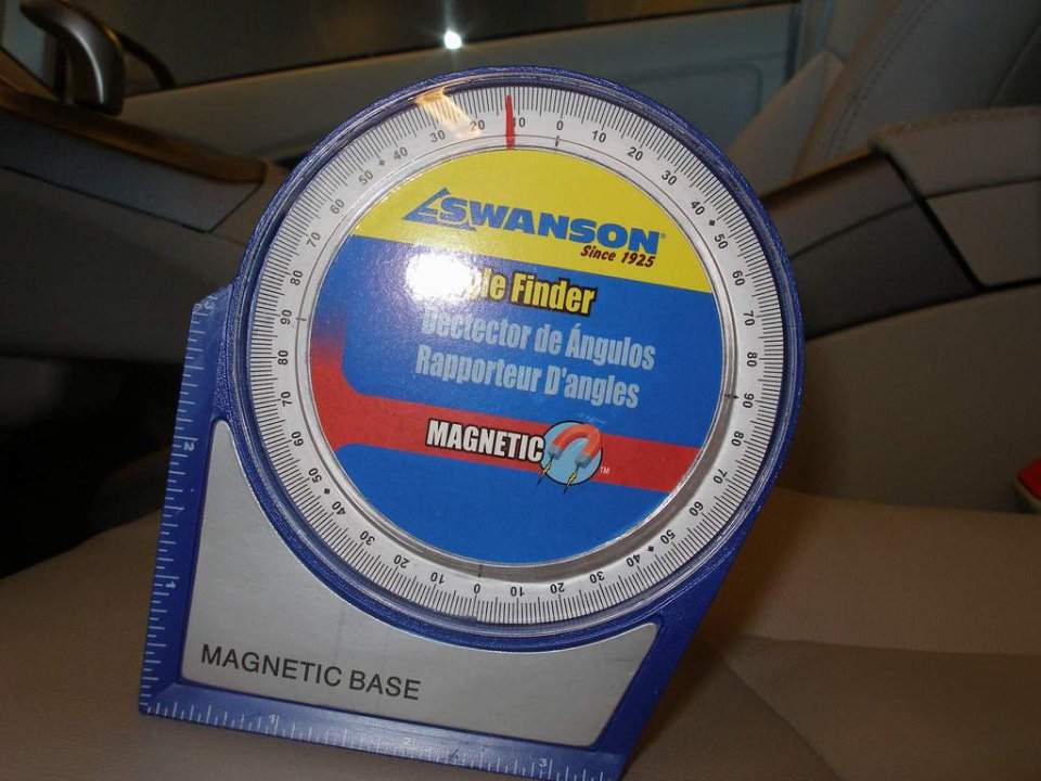

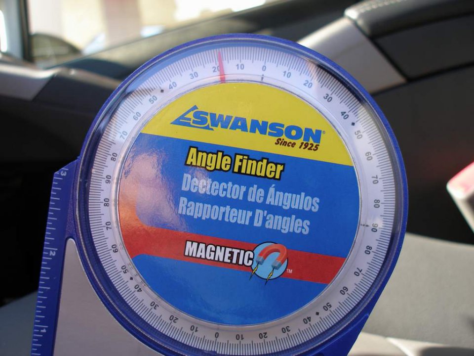

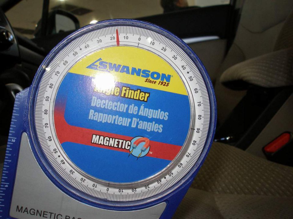

    Real quick: I'd like the front of seat cushion to go lower, but for that, need the power seat (that's the 7 and 8 in the 8-way power seat. manual seat only 6-way ... :oops: ).
    ** speaking of manual adjust seat below**
    Tooks some pics with angle finder on front section of seat bottom (in showroom 2013 Prius liftback Two with aftermarket leather) with height adjust full up (12 deg *tilt) to 19.5 deg tilt at height full down. Lot of variance compared to 2013 Civic whose seat tilt varies only 16 to 18 deg.
    * tilt: angle of seat bottom cushion relative to horizontal
    Prius: 12 to 19.5 degree tilt
    Civic: 16 to 18 degree tilt
    Corolla seat also varies a lot like Prius 13 to 20 degrees.
    I'd like to see a Prius seat with nearly constant tilt through height range, like Civic and Accord.
    Height adjust, fore /aft movement and tilt variance all in one height adjust lever is a bit much. Scrap the 8 deg tilt change :)
    2013 Prius seat tilt @ height full up. See how angle finder goes much closer to seatbelt latch in next pic (did not slide seat). Height lever changes height, tilt, fore/aft ... what a devilish lever. :eek:
    Prius seat tilt @ height full down.
    2013 Civic Hybrid seat tilt @ height full up. Varied to only 18 deg @ full down (pic later).

    Ah, so with your 2012 Prius Four, you have the full power Softex driver's seat.
    Interestingly, my tilt angle of my seat is currently about 18 degrees which is the same as the power seat height adjusted full down* and the seat bottom tilt flat as possible, BUT, there is a difference between the two:
    tilt in Prius plug-in advanced. full down seat, least tilt
    in both cases with steering wheel tilted full down, the distance between the seat cushion front and bottom of steering wheel is ....
    with power seat: 7.5 inches
    my seat: 6.75 inches between front of seat cushion straight up to bottom of steering wheel.
    What does that mean to me?
    >> The power seat offers more knee room under the steering wheel. It is impossible in the manual adjust seat to create 7.5 inches between the front seat bottom straight up steering wheel, so....
    Less room for knees / legs in manual adjust seat.

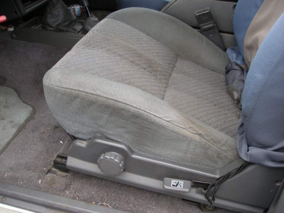

    Toyota uses a seat design methodology to vary the seat tilt through the height range, but the tilt is not adjustable in the manual seat at a given height. I've seen this in Corollas also back to at least 2006. It's not like no other mfr. does this, but Toyota is in the company of Chevrolet Cruze as it's seat tilt varies like Prius manual seat.
    I've already mentioned Civic and Accord (maybe the entire Honda line) driver's seats keep a much more constant tilt through the height range. Everyone has a preference and the Honda way is mine.
    If I lower my butt down in a seat, I want my knees to be able to lower down also. I don't want a seat forcing 'more than plenty' of leg support due to seat tilt.
    Here's some high seat tilt in my 1988 Toyota SR5 4X4 pickup. This could cut off circulation. Yes, it's all the way up, but all the down is just flat enough to not squeeze the legs.

    Cycledrum, I love that gauge !! Much better than my level and wood blocks. :)
