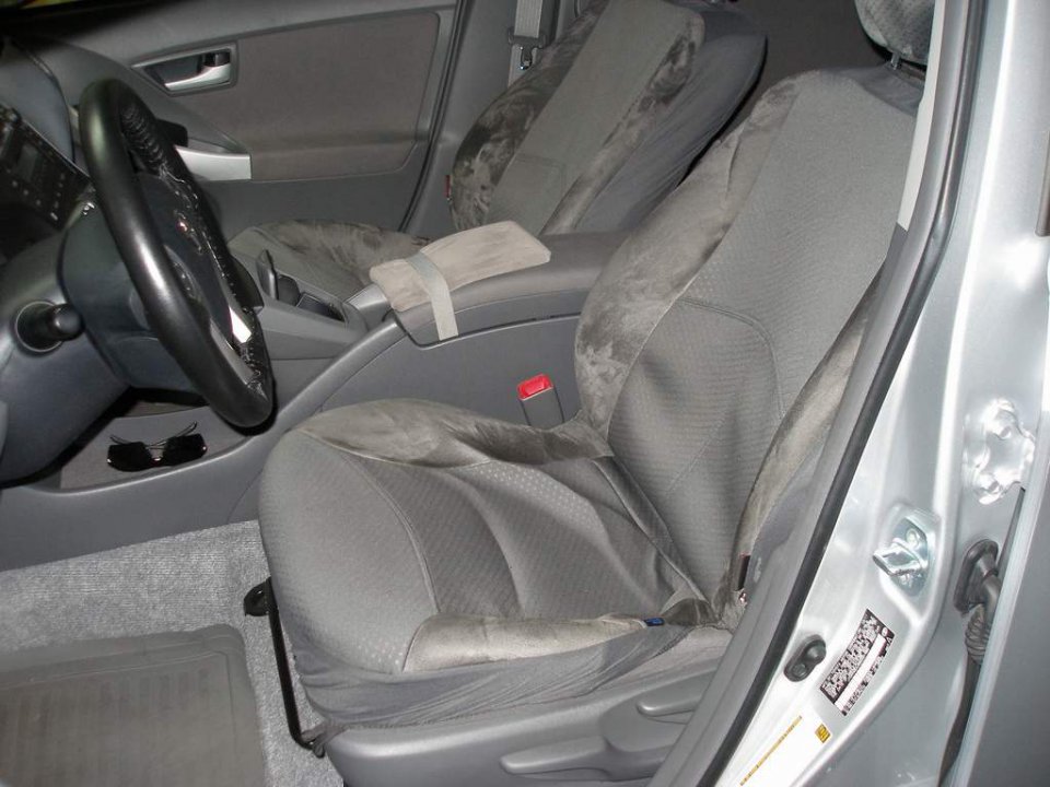

    Hello, rmi, I too have found it difficult to get comfortable overall in my 2011. Seat has always been fine, but the limited steering wheel tilt and telescopic range are a nuisance in this car. btw, I'm 6'2" tall with long legs, 36" inseam and apparently average sitting height. how tall are you if you don't mind me asking?
    I will tell you what I've found and I hope something helps. It may not as everyone is different.
    Being tall, I adjust the steering wheel by loosening lever, pulling it fully towards me and tilting it full down. It doesn't tilt much, maybe under 1 1/2". Only 1 1/2" telescope too.
    Hear me out. At lower height adjustment settings, the seat bottom has a lot of tilt (back of seat bottom much lower than front).
    I CANNOT put the seatback bolt upright. At that setting, the angle between seat bottom and seatback is too small, the seat feels terrible, like sitting in a hole or bucket.
    I PUT the seatback just far enough back to acheive and acceptable angle between seat bottom and seatback. At that setting here's the challenge ....
    With seatback set, seat slid back for my long legs (2 forward from full back), lowered down a lot (4 pumps up from full down) ....
    The steering wheel points towards my upper chest, almost to my neck and it's clearly awkward to steer that way. Any thing like what happens to you??
    The solution has been to raise the seat 9 pumps up from full down. Still slid 2 clicks forward from full back, same seatback angle, don't know seatback clicks, but just far enough back so I don't don't feel jack knifed. Needed to add 1" thick foam pad on center console rest right knee. It's weird, but works. In midsize sedans I'd be resting shin on center console anyway (standard center consoles allow that. Like to see 4th gen Prius with it).
    I can't speak about lumbar issues as i don't need much.
    Ok, so lumbar area juts into your lower back and your shoulders don't get support.
    Is it possible the seatback is too far forward for you? As mentioned before, this can easily happen (to a tall person) because the steering wheel doesn't tilt down much nor pull very close to tall driver.
    If I may suggest, use the steering wheel position as a guide. It doesn't adjust very much, but put it in the best position you can. If should be pointing towards your sternum. You may need to raise the seat up higher than you normally would so the wheel is lower relatively to your body, but I'm speaking from my perspective and don't know yours.
    If you can post up a picture of your seat setting, that would help.
    It might help me if you could state your height, inseam length. Also number of clicks forward of seat sliding and number up pumps up on height adjuster. If you can count the number of clicks of seatback forward, that would help.
    if seatback too far forward, it can cause major discomfort in lumbar area, also make your legs feel pressed onto the seat cushion.
    If you were to put the seatback a notch or two back to 'just far back enough', then raise the seat height so the steering wheel is pointing towards your sternum, might that help?
    Here's how the seat is set in mine. At 9 pumps up on height adjuster, see how there is still a fair amount of tilt in seat bottom cushion. The seatback is reclined a bit, definitely not bolt upright and must be there or I feel something like jack knifed in the car which hurts legs and lower back. Had to raise seat up 9 pumps so the steering wheel not pointing towards upper chest. Things are better, might settle down and be good from here, but it's been FAR too hard to get comfortable. For me, the seat is good, but the steering wheel sucks in this car.
    Hope I didn't take over your thread, but speaking from my perspective, hoping something sticks. Feel free to post up pics of your seat situation too, I won't make fun.
    setting: wheel full down, scoped out, seat slid 2 clicks from full back, 9 pumps up, seatback reclined about 4 clicks from full forward.

    OP, I've had a couple shorter drivers, like 5'2" sit in my car and adjusted up drivers seat for them. Both of them said it seems like they should be leaning to the left a bit while driving. Appears to me either the seat or steering wheel is pointing a bit to the left. Easy to see just look down at front edge of seat / wheel. Probably doesn't make a difference but it is what it is.

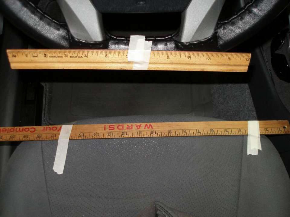

    Both front seats not only don't point forward, they also are tilted. You can test this by looking at your car from about ten feet in front of it. Took me a while to notice it. But I'll bet that in itself doesn't make the seats terrible. But I know from doing long drives in the car that they are, in fact, torturing me. When the 2015 comes out, it will be the first thing I look into before I decide.
