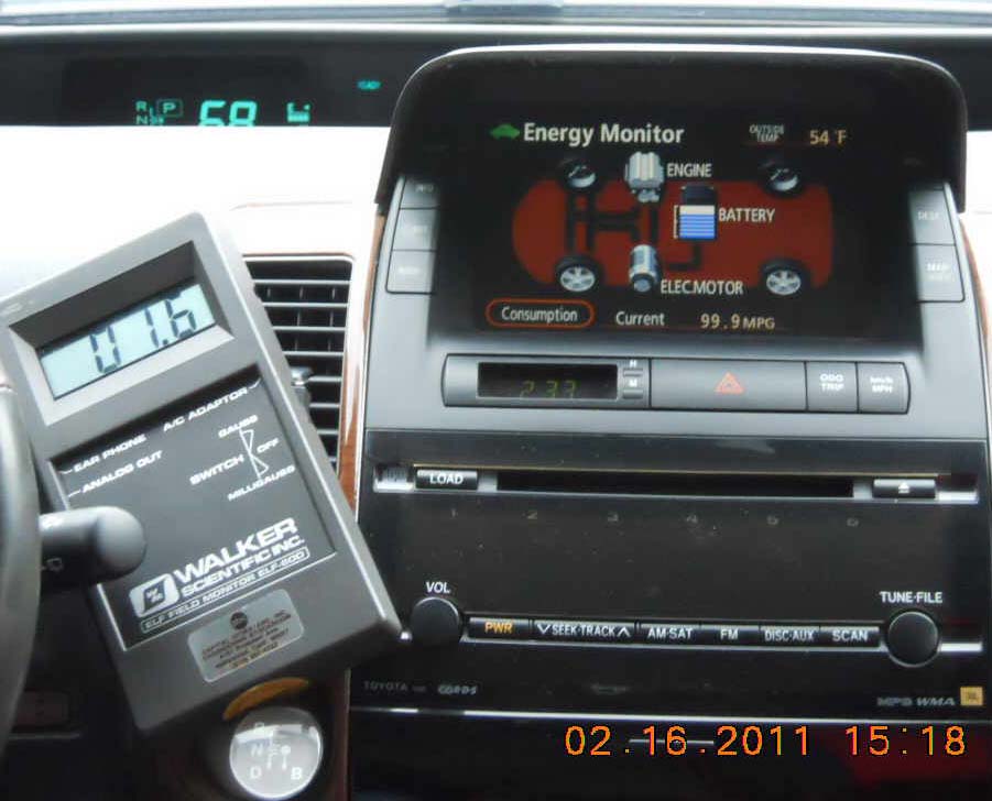

    KK6PD _ . _ . / _ _ . _
    Mar 24, 2008
    4,003
    946
    118
    Los Angeles Foothills
    Here is a shot of my MFD showing WARP STEALTH going downhill st 68 MPH!!
    No arrows at all!
    PriusCamper likes this.

    Looks good KK6!!
