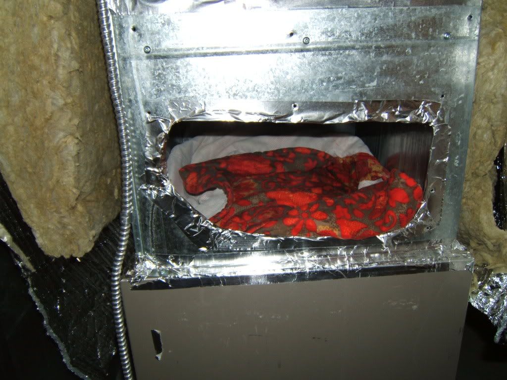

    Ok, I now have a Photobucket account.
    This is how my furnace looks.
    http://i653.photobucket.com/albums/uu256/jayman_photo/HVAC photos/DSCF0185.jpg

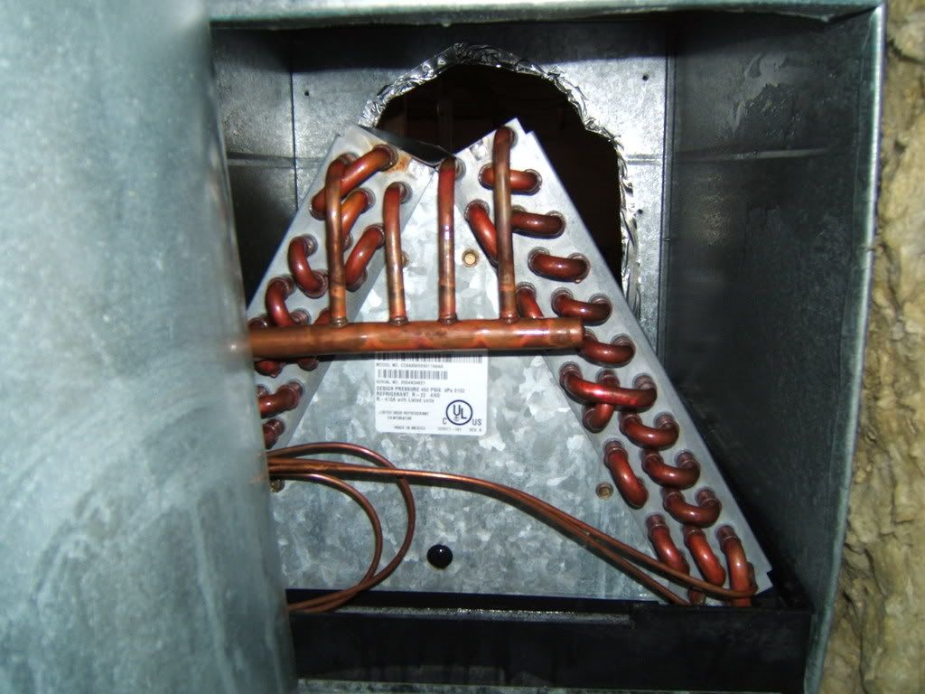

    This is the front side of the e-coil. Typically this side is easily accessed by opening a panel.
    http://i653.photobucket.com/albums/uu256/jayman_photo/HVAC photos/DSCF0723.jpg

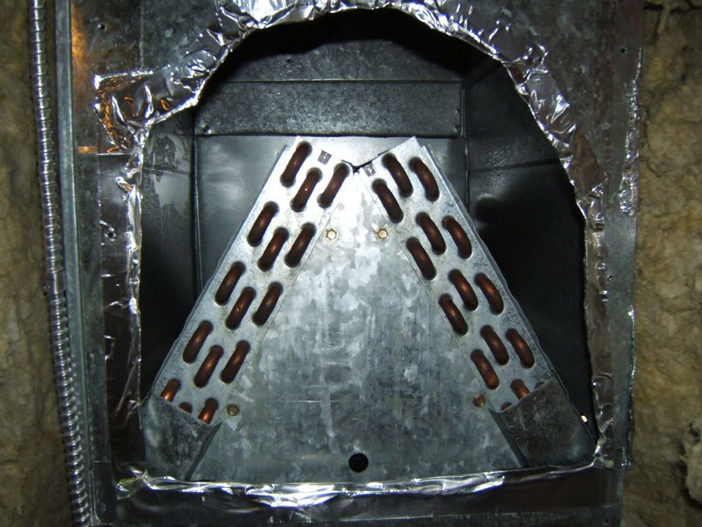

    The backside, I had to use a sheet metal tool to cut my own access. You obviously have to be careful you don't hit the refrigerant tubing
    http://i653.photobucket.com/albums/uu256/jayman_photo/HVAC photos/DSCF0718.jpg

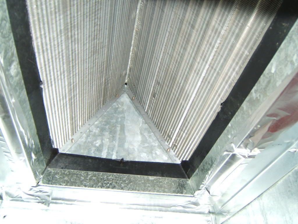

    The most important access is UPSTREAM of the e-coil. I had to cut my own access hole. With the blower off, entire furnace off, it's important to put something in there, like an old blanket, to protect the heat exchanger from possible chemical drips
    http://i653.photobucket.com/albums/uu256/jayman_photo/HVAC photos/DSCF0721.jpg
    This is the underside of the e-coil. I've seen plenty of them that are completely caked with dust and dust bunnies, cat fur, etc
    http://i653.photobucket.com/albums/uu256/jayman_photo/HVAC photos/DSCF0722.jpg
