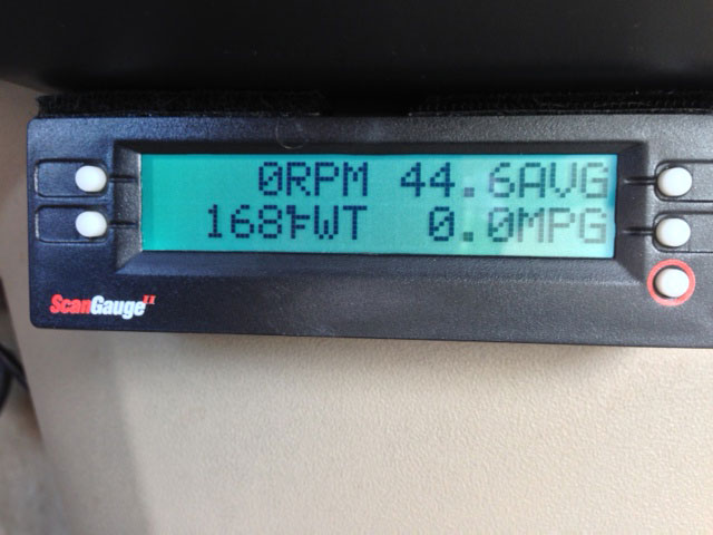

    Letting the ICE warm up for 1 min before blasting off has made a huge difference. that, combined with better understanding of the 4 phases, and utilizing them to glide more has improved my early commute tremendously. My SOC isn't fluctuating, and my mileage has improved.
    This morning, same 3 miles:

    Two things I noticed that aren't normal.
    1 - Driving with a dirty MFD
    2 - Driving while recording video
