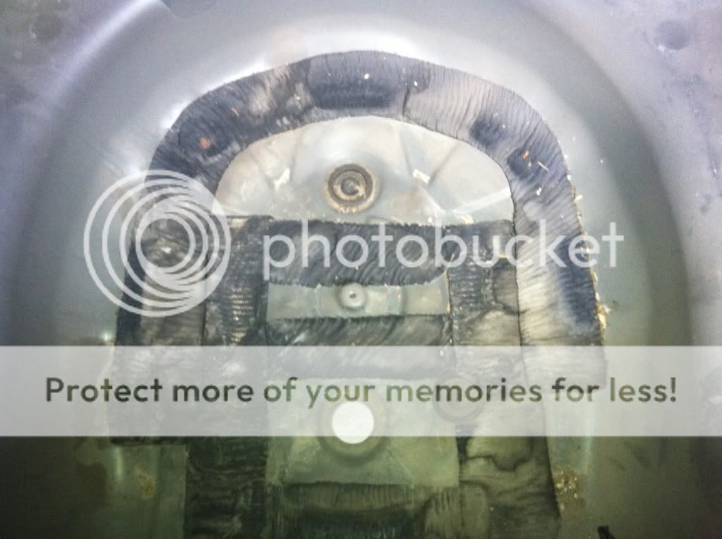

    I crawled in the back and ran water down the back of the car. Here is where mine was leaking just below the rear break light. I am on the way to the dealership to see if I can get this repaired under warranty.
    Here is where the tire holder was staring to corrode! I spent the afternoon scrubbing the scum out of this area and off the tire.
    And where the wiper motor was starting to corrode as well.
    I am glad I caught this early. It took over an hour to get the tire out of the well because the screw holding it in had corroded in place. Glad I did not have a flat!!
    This should be on your annual checklist..

    Looks like missing a plug also or it was removed to drain?

    Just removed to clean and drain!
