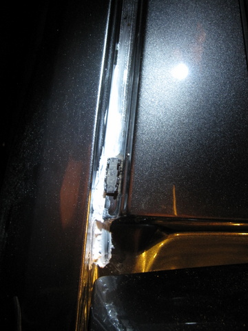

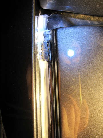

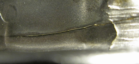

    Found a leak in my 2009 prius in the tire well. did the following to fix it:
    * Removed the two plugs in the tire well (so if there are future leaks the water just go down the hole.
    * Removed the plug under the left storage compartment plastic bin so that any water there also drains.
    * Found a hairline crack in the weld joint in the upper left quater panel corner. This was the main leak source. Applied marine adhesive 5200 fast cure (from home depot) to the area and then painted over with touch up paint. This fixed the main leak.
    * Found some separation in the sheet metal joint under the hatch lid - remove the rear tail lights to access this area, and applied 5200 adhesive there as well.
    So far leaks seem to be gone, but will watch the area. 5200 is good stuff for this - sticks well and remains flexible.

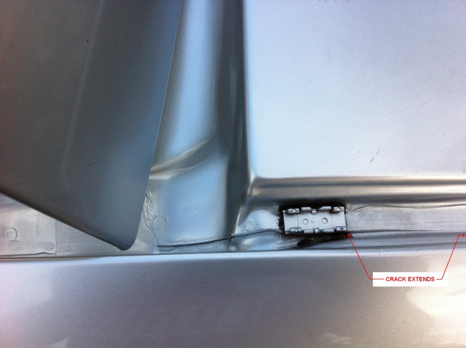

    If interested, I've been researching an interior flood in the wife's 2008. Here's what I found today, as posted on my thread:
    Here's an update. Someone earlier suggested I check the spare tire well for water build up. I secretly thought he was nuts (sorry), but I thought I would check every lead. Guess what...it was flooded to capacity back there. So I tore everything out to try to find out why it was full of water (after sucking it out with the wet-vac), and to figure out how it was also filling the floor pans. Pulling out the rear seat first, I found water soaked into the bottom of the padding; easily 8 or ten inches higher than floor level. I ripped out all the trim and found water at an even higher level....up in the quarter panels. So, I took to the hose, and started soaking the car on the outside, while all the trim was removed. Here's what I think was going on based on water leak test performed. Refer to photo: there are two grommets, for wires (et al) to pass to the hatch, at the top of the rear deck frame (in red). Water is apparently getting in through them (they are loose fitting, man), channelling down through the frame rails (path in yellow) and literally raining down behind the trim panels, collecting in the wheel well (blue). When enough water had built up around the tire over a long period (she didn't even remember there was a spare in there), it overflowed. With no other place to go, it started running under the rear seat (soaking the padding) toward the front of the car, and spilling over into the floor pans. That's where it sat, soaking into the padding. When utterly saturated, the level on the floor finally got high enough for her to notice pools. What a trip. There is no leak in the front of the car anywhere. All the water came from the damned trunk. SOB. Now; I have to figure out how to fix it. Maybe simple gasket sealer. I tell ya'.....this one was baffling, but I'm fairly certain I solved the mystery. image.jpg image.jpg
    Blackwing likes this.

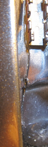

  15. kfhaggerty
    kfhaggerty New Member
    Apr 27, 2014
    16
    Westfield, Massachusetts
    I went out there just now; two pairs of eyeglasses, a flashlight, and a toothbrush to clean the area. It's tough to be certain if they go all the way through, but I have hairline cracks in the exact same locations - both sides. I'm going with black RTV sealant (I have some already). I'll slather it into those little cracks and seal underneath the grommets. Thanks. I looked earlier today right at that spot, but the cracks are so slim, I missed them on first inspection.

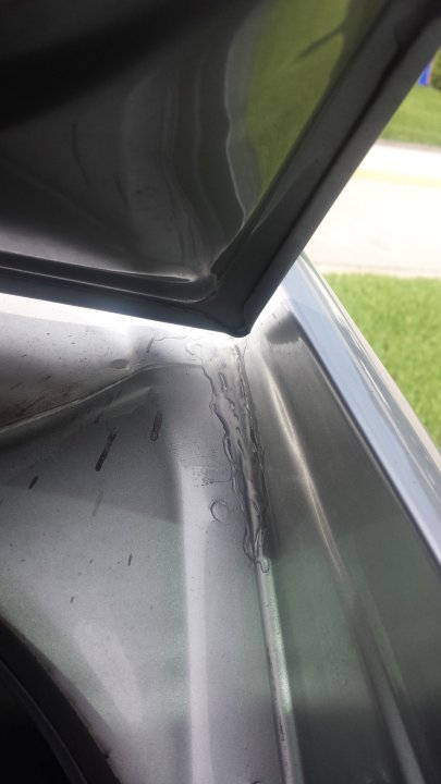

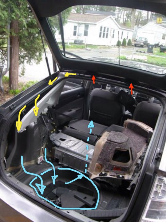

    I have a 2008 Prius (Original Owner) and for the past few weeks I have been finding water on my rubber mat which covers the entire back hatch area. I kept thinking some water must have dripped off the hatch when I opened it after a rain, but then with every rain I would look inside and try and see if I could find the leak and nothing. Then one day, I found water dripping out of my hatch light on the drivers side of the hatch area. I popped out the light and stuck my fingers up in there and the backside padding of the panels were all wet. After searching YouTube videos, I found a video of a guy with the same problem overseas and then I found this thread. Both confirmed the cracks in the roof area as the cause of the leak, but just to be 100%, I took apart the entire back hatch area and ran water from a hose onto the roof (right above the crack) and watched the water coming from that very same area. I put clear silicone over the entire crack and about 3 inches further in both directions, waiting an hour between coats to ensure a good coverage.
    I did not reassemble the car as of yet, as I want to go about a week in the FL rain to ensure it is fixed. Well, about 4 hours after I sealed it up, we had a severe thunderstorm which dumped about 7 hours of heavy rain down upon my car. So far so good and the silicone hasn't even fully cured yet as the tube states 24hrs to fully cure, 1 hour for tack drying.
    Luckily, I found this rather soon, my 12V battery was sitting in a pool of about 4 inches of water, my spare tire was completely submerged in water and the area under the cargo area to the left of the spare tire was also flooded. All that from a week of rain storms.
    My question to everyone, is what is Toyota going to do about this? Right now I would like everyone who has these same cracks and water intrusion to either post here or notify me in email as I am getting ready to contact Toyota Factory in Japan with a major complaint on this. Silicone is not a permanent fix as far as I'm concerned and I don't think this is an isolated few cases as I have 4 friends that have the same generation Prius and I called all of them today and asked them if they had water in the back and they all did! Yes, I told them the source of the water, but we all need to stand together on this and get Toyota to pick up the tab on this issue.
    Thank you for the post as it was very helpful to me in confirming this issue and thank you all in advance in contacting me so we can stand together on this issue. If Toyota is unwilling to do anything afterwords, I will take it to the next phase and I'm sure Toyota does not want that publicity especially after the Gas Pedal/Floor Mat issue with sudden acceleration.

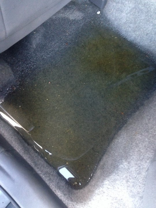

    I have not read all the posts here, but just noticed the carpet on rear passenger, behind driver is soaked with water! Car has been closed during rainy days, have not had rain in days, did not go through car wash recently, and car is garaged kept. I soaked up the water in napkin, and cannot tell from the smell where it is coming from, did not smell anything. Seems "soapy." Any thoughts before I go to the dealership again? I have an 07 and bought used, close to 150k miles.
    AltraStache likes this.

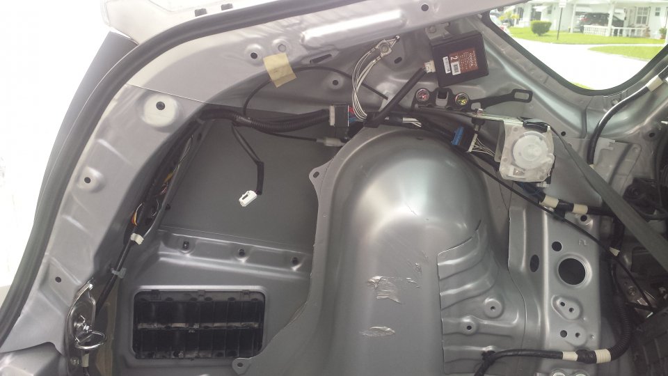

  20. anti-gas
    anti-gas Reduce, Reuse and Conserve
    Feb 28, 2008
    56
    South Florida
    Bobby T,

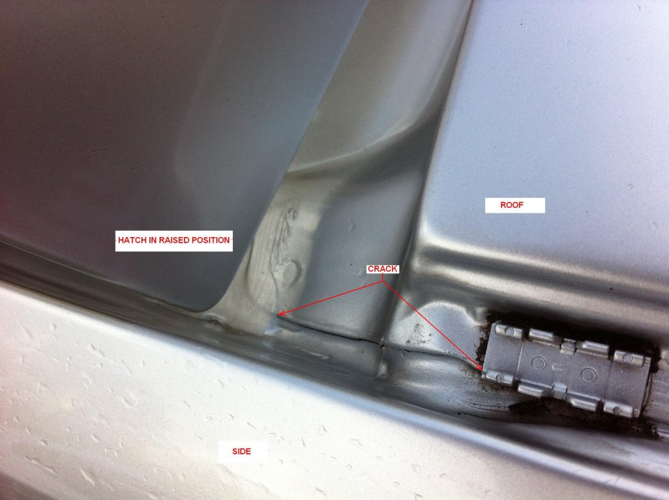

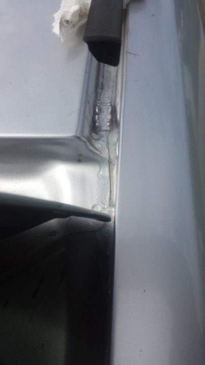

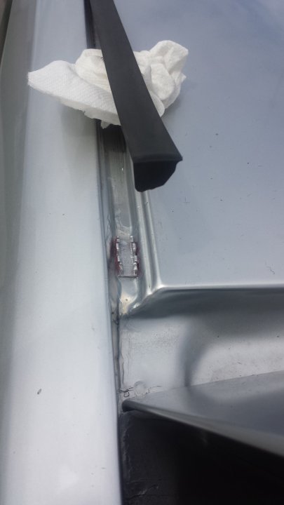

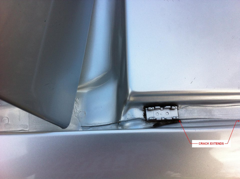

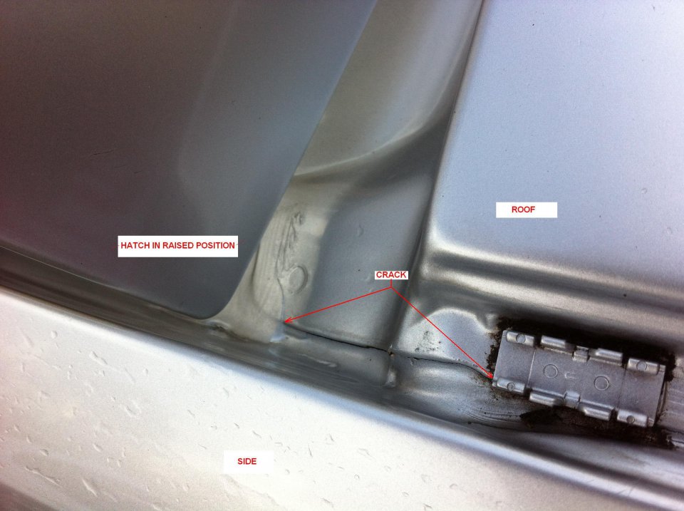

    The problem is the weld seam on the roof opens up allowing water to seep into the channel which runs down both sides of the hatch area and ends up at the lowest level of the car. The battery well, tire well and the drivers side rear well under that small hidden storage compartment. When those wells fill up, then your hybrid battery, back seats and the rest of your car is doomed! Easy fix! Clear windshield silicone, very lightly spread over the cracks and the surrounding area. Before you silicone, wash area with plain water and a paper towel and get it all super clean, then wipe down with denatured alcohol to remove any residue so that the silicone can make a superior bond and not come up prematurely. Very thin light coat, let dry 1hr. Apply 2nd and 3rd coat with 1 hour intervals if your really paranoid like me. Let cure for 24 hrs and do not get wet or drive the car if you can help it. The longer it cures dry and without movement, the stronger the seal. That's it! My leak is 100% repaired. We had a torrential rain 1 hr after the 3rd coat and for the next 3 days and not a single drop of water intrusion..
    After some investigating, I have determined this is a manufacture defect which affects almost every Generation 2 Prius and maybe more. I have 5 friends with this same Gen2 car. I called them and they all have the same leak, I then went to 3 different Toyota dealer lots and checked their used vehicles 2006-2008 and they all have the same crack. So what does that tell you? I have a call into Toyota on this. We need to stand together and make Toyota cover this and any damage caused by this defect.
    Here is what's happening, the water seeps into those 2 cracks, it runs through a metal corridor which has several round body holes where it drips out of. Some exits early and soaks the padding on the backside of your trim panels, the rest rides the wire that exits on the 12V Hatch lamp and it drips down the outside of the lamp. On the other side, same thing, only it drops on the battery clamp and then fills up the battery well. It also will make it's way down to the taillight access panel and just above the battery and soak the panel then drip inside onto the carpet through the panel. Once your two side wells fill up, it overflows into the spare tire area affecting the back hatch latch and then overflows into the hybrid battery and then your back seats and the rest is history. I was lucky, I caught it early within 3 weeks and only minimal damage. No damage to the electronics, just surface rust starting and smelly panels which I sprayed with a bleach/water spray and let dry in the hot FL sun for a day.
    Please spread the word so that others can fix their car and hopefully let everyone else know what to expect. If you don't have the leak, you will soon, if you have fixed it, then check that area every few months and just make sure the silicone is still on there good. I think this should hold and last the life of the vehicle. I plan on keeping mine for as long as it will run.
    BTW: Look at the image of the drivers side back of the vehicle where the panels have been removed. You can see the wire hanging with the white connector at the end. This is the rear hatch light. The water will run down this wire and exit into the hatch area, the rest of the water runs down that gutter up at the roof line and drips everywhere along the way soaking everything. That little black box on the wall is the keyless entry sensor, (VERY EXPENSIVE) it gets water dripping right onto it. So there you have it folks, get busy inspecting your Prius and save it!
