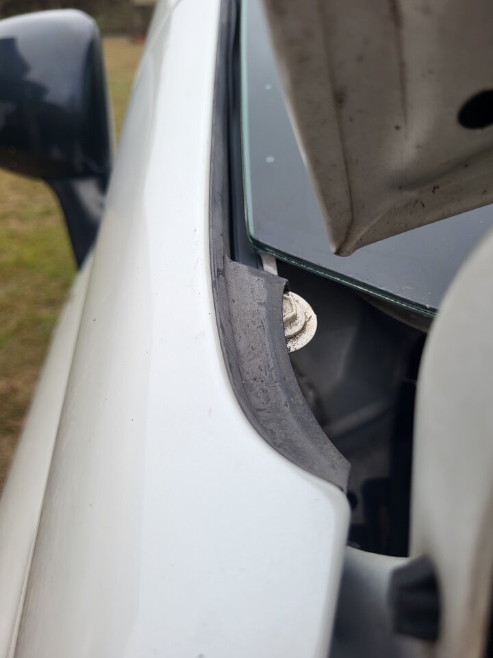

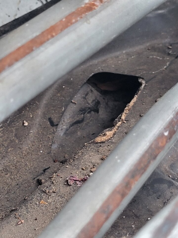

    It seems that the problem is not a clogged drain. I have included a picture of the drivers side drain. When the window is installed, a tall bead of sealant was laid down but there is also also a rubber seal applied to the edge of the window. I have included a picture of the seal on the passengers side towards the bottom of the window. I am thinking that the seal around the window was not installed properly.

    Safelite is coming back out to reinstall the windshield. Does anyone have the Service Manual description of how the windshield should be installed? In particular, I am interested in the seal that goes around the edge of the windshield and how it should look after it is installed. If you have a good picture, that would be appreciated. Thanks for the help … Michael
