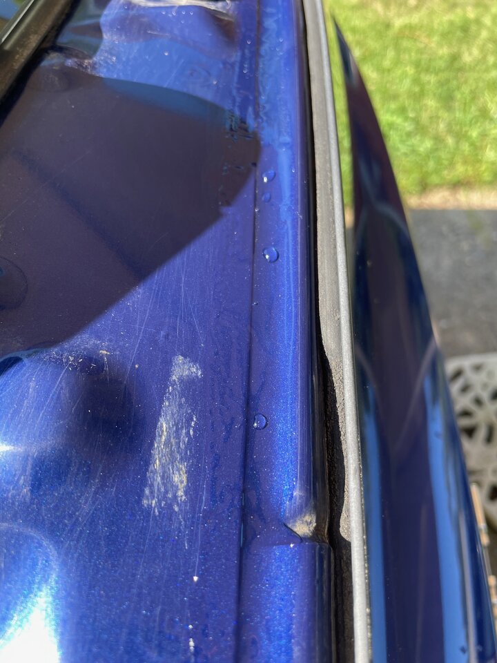

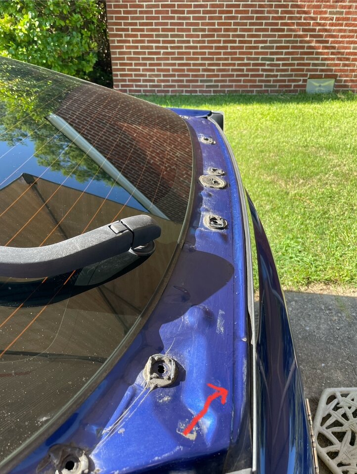

    Since no one commented on this I just came back here to say that I got the spoiler off using some helpful instructions I found for the Gen 3 which I tried to include a link to but apparently I am not allowed to do that. Then I found a hairline crack in the channel just above the lower rear window which I sealed up with some silicone. No more leak! IMG_7133.jpg IMG_7134.JPG IMG_7133.jpg IMG_7134.JPG

    I don't know why it posted two of each photo. Sorry!

    I pulled the spoiler off my roommate's 2017, and it was rowdy under there— so much gunk. Cleaned it up and used gasket maker around each screw/bolt.
