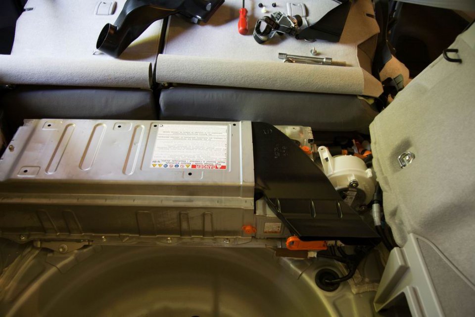

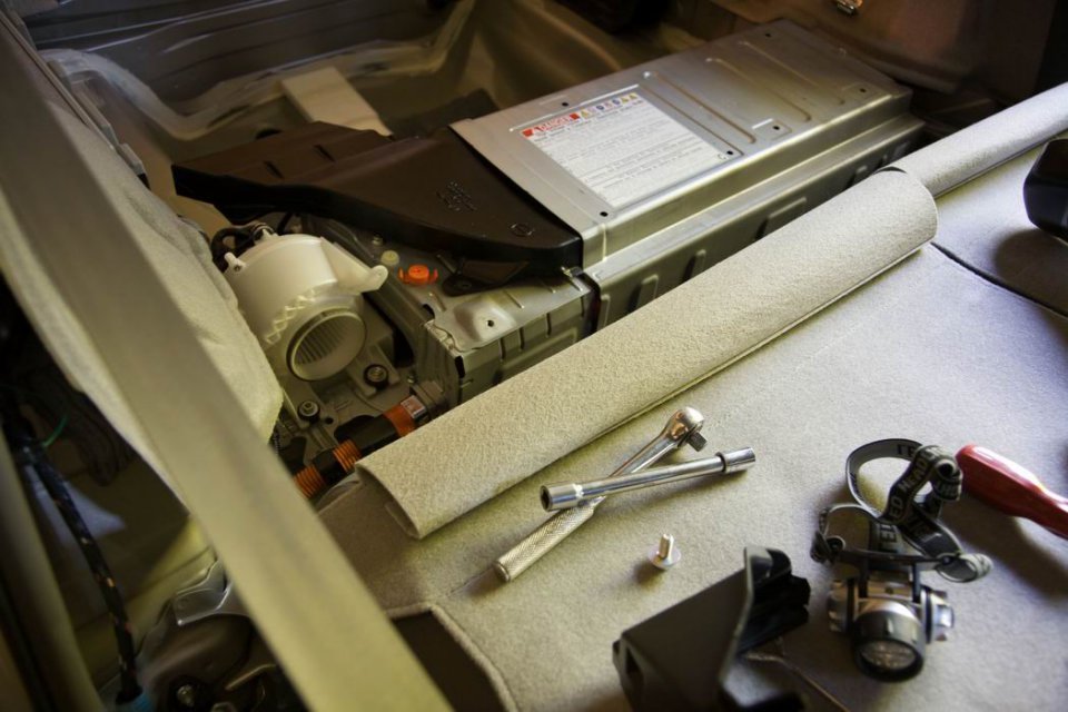

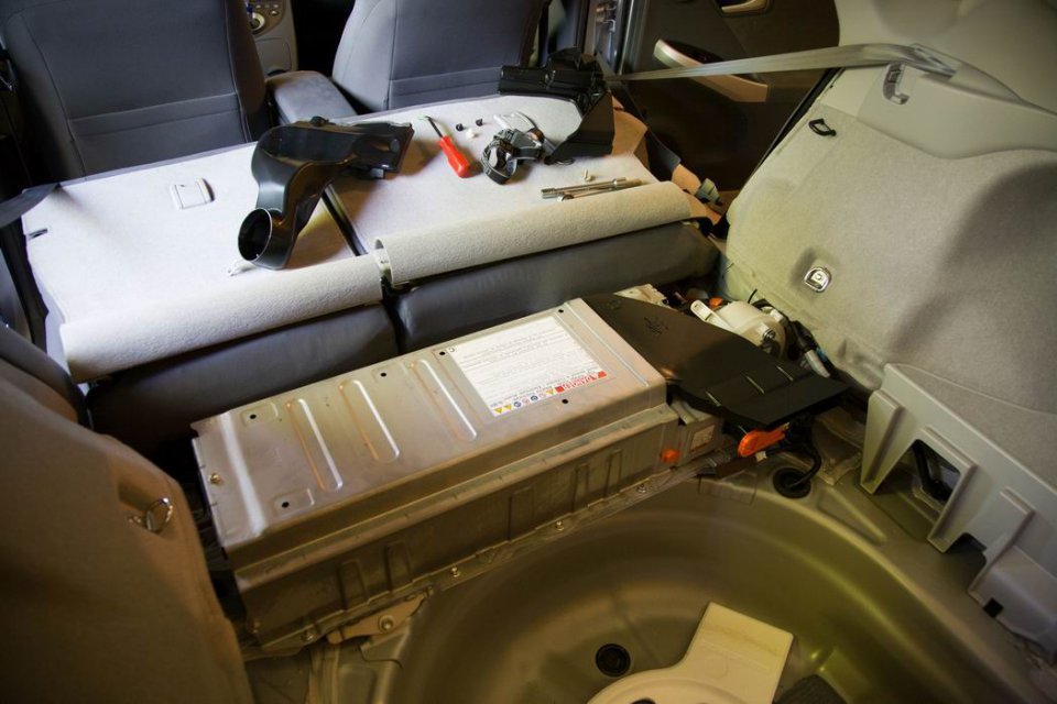

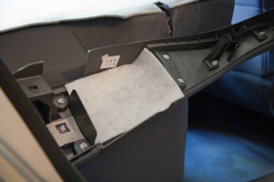

    I doubt there's any problem.
    First off, the fan behind that vent runs at various speeds, perhaps off much of the time. With a near-new car it's not likely it was running at high speed.
    Also, when the water spilled it likely just ran down the spines of the grill, nothing more. Behind the grill is a duct that leads to a barrel shaped fan, and from there air is blown across the top of the battery.
    If the fan was running, any drops, if they made it through the grill, just clung to duct surfaces somewhere along the route. And the cells themselves, at the battery, are plastic cased.
    To see what's happening directly behind the inlet grill, there's a single bolt, between the seat and back cushions, reachable with a ratchet wrench with extension (think it's 12 mm socket). Once that's removed you can pull out that portion of the seat back, with grill off. There's a few hooks on it that need to be wiggled off.
    You can also pull up the hatch area floor panels. There are a lot of tenacious fasteners. I took a look at ours, and left half of the fasteners out when reassembling, and it's still very secure.
    Here's a few pics of what it looks like:
    (the white material is over the inlet grill, acting as a filter)

    Liscifan, I think Mendel Leisk's photos should reassure you. Short of flooding there is little risk of the water reaching the battery. The filter is something of a personal choice. Some owners, particularly pet owners or taxi drivers, have found that the fan can get clogged with dust and fur. I have dismantled my fan(again recently at 100,000miles) and other than a small amount of dust my fan was clog free ( I live in a rural area and do a substantial amount of dirt/dust road driving). The filter will reduce the amount of air the fan can pull in and push over your battery, so unless you do carry pets or lots of people with clothing that sheds lint my personal choice would be to not install a filter.

    Thank you for the pictures, Mendel Liesk. It helps to understand how well protected the battery is. I am way too chicken to open it up myself. So I am going to skip that.
