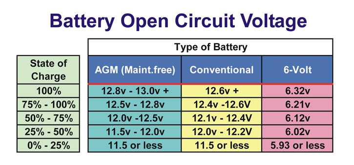

    Going by the numbers.
    A "fully charged" AGM (Battery found in Prius) should measure 12.8 volts OR higher when measured at the post's with NO load. Remember the battery is loaded at all times while the battery is connected to the Prius even in "Power Off" mode. Most user's will report approximately 12.6 to 12.7 volts if measuring the voltage at the battery or jump post after the Prius has been powered down for at least a couple of hours. Remember even opening a door will activate certain ECU's even though the Prius is still in "Power Off" condition. Voltage will vary depending on how much load is placed on the battery.
    Now looking at the OP's circumstances he/she did the following. "Pushed the power button twice AND turned on the headlights." He/she then measured the voltage while these circuits were active and found 11.75 volts with a .01 volt drop (steadily?). Again going by the numbers and various load factors IMO the measurement of 11.75 volts is really NOT bad when you consider how many amps are being pulled at that time to power up all of the devices, ECU's and the headlights at that time. Sure, it would not hurt to be a couple of "tenths" (.1 or .2 volts) higher, but IMO is still okay.
    When checking voltage as the OP did it is important to understand that any load applied will cause the battery voltage to drop. The more load you place on the battery the lower the voltage will read.
    If you truly want to test a battery to see if it is good or bad, a "load test" should be run on it. The average person might or might not have that tool, but usually will have a fairly decent "digital" multimeter.
    Furthermore, it is important to understand that IF you are only using the multimeter to test voltage as the OP is doing, consider the fact that the voltage should return to close to the level the battery read before it was loaded up as he did by turning on the lights and ignition. HOWEVER the "voltage return" will NOT be instantaneous. It generally takes a minute or so for resistance values to settle down and everything else in the system to equalize before the voltage returns to the normal value UNLESS the "auxiliary" battery (12 volt) has been drained substantially while doing a test such as turning on various items as the OP did.
    To sum it up, at this time I believe the OP's purpose of changing the battery will really only help IF the OP is concerned with longevity of said 12 volt battery. IMO the voltage is measuring fine for the conditions of the test the OP ran. IMO, I would wait until I saw the voltage level of 12.5 which the OP measured drop down to at least 12.2 or lower when testing with NO load applied including testing at the jump post or battery post while the Prius has been off for a while.
    Please refer to the following chart for a better understanding of what the voltage levels mean and how they relate to the percentage of charge also known as "State of Charge" (SOC). One other factor concerning voltage. It is NORMAL for voltage measurement to be LOWER if the ambient temperature is "cold". By cold I am referring to temperatures similar to 35 degrees Fahrenheit or lower. More information on temperature and voltage variation can be found by doing a Google search on that topic.

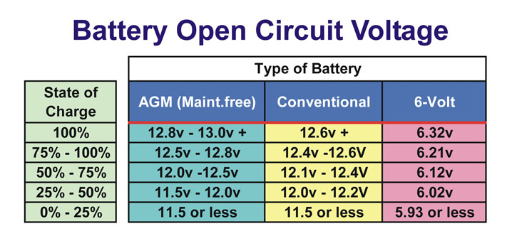

    Check it in the morning and see if it still reads 12.7 If it does, invest in a smart battery charger. If it is weak again, think about a battery sometime in the near future. FWIW, quite a few of Gen II users have been complaining about the quality of the Yellow Tops recently. Now the hot ticket battery seems to come in as the one Toyota sells. Just wanted to mention that to you.
  9. mycnam
    mycnam Member
    Jun 11, 2013
    111
    Long Island, NY

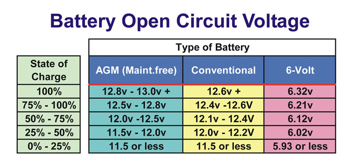

    Thanks dorunron, So according to this chart 12.7V is still not yet 100%. I drove and charged in READY for at least 3 hours today. May be that's still not long enough. Doesn't people here usually get 3-5 years life from the original battery?
  10. dorunron
    dorunron Senior Member
    Jul 17, 2011
    3,318
    1,103
    Houston, TX
    Read the lengthy first post I wrote above this in this string. 12.7 volts is not bad IF the battery is hooked up in the Prius. Even when the Prius is powered down, it is still drawing on the battery, hence the voltage will read lower than a fully charged AGM battery will measure with "NO" load. A fully charged AGM battery WILL measure 12.8 volts or higher if the battery is operating to factory specifications (IE: NEW).
    So, 12.7 is not bad IF the battery will HOLD that charge overnight.
    4 years is a average lifetime of a 12 volt battery. Some last longer than others, some don't last that long at all. It depends on how the battery is used and maintained. I have seen folks get 6 years and longer out of them, but they took good care of them and did not abuse them.
    FWIW, 12.6 is about what you will see when you measure at the jump post with a good fully charged AGM battery in the Prius. That would be considered normal. Remember even when the Prius is off, there is still a parasitic drain at all times.
