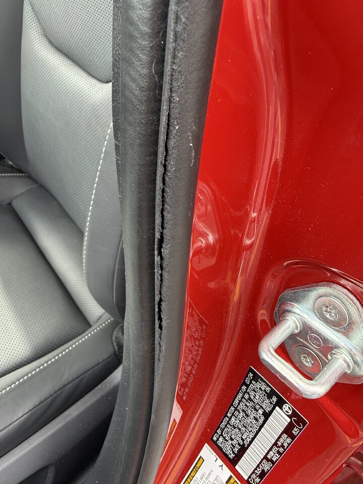

    1500 miles and got a note on my rear door recall worksheet that driver side weatherstripping was torn. I hadn’t noticed it but it is indeed worn. See photo. Anyone else have this happen. I’m ultra careful getting and out of the car. Would this be a warrantee covered item? Any suggestions appreciated. J

    I noticed mine wearing excessively in the first month I owned the car. It consists of a low quality rubber, which is quite susceptible to wear.

    Have you done anything to mitigate further wear? I put a piece of clear shipping tape over the “wound” but that seems amateurish.

    I had the same tear, same place. From the interwebs, I gather this is pretty common. I don't know what I was thinking, waited too long, and could not get it warranted.

    I had same issue. Dealership refused this as a warranty issue. I haven’t done anything to try to fix it yet. The dealership said they could put new one on for a charge.

    If anyone decides to replace theirs, please do it yourself and don't pay a dealership to do it for you. I can't think of many things easier to do on a car. Significantly easier than an oil change. <5min.
    I'd be tempted to order from Japan on this. $33 per seal before S&H from Impex Japan. $70-$80 per seal all-in from US dealerships during good sales.
    FR - 62311-47060
    FL - 62312-47060
    RR - 62331-47060
    RL - 62332-47060

    I took a look at mine and have an idea as to why it's happening. Mine(3y/36k) is also failing, though the tear isn't as long yet as the OP's pic. I think it's happening because of how the door seal interacts with the plastic door card.
    The door card is made up of textured plastic. The failure point in the seal seems to start where the seal comes in contact with the vertical right angle in the door card. I think the rubber seal gets flattened as the door closes, and the edge of the squashed seal just barely brushes the vertical portion of the textured plastic. Over time and hundreds of openings and closings, I think the plastic acts as a sandpaper and abrades the edge of the seal until it wears a slit into it.
    Assuming Toyota doesn't step in, I see four solutions:
    1. Ignore it. It doesn't compromise the car in any way, so you could just ignore it if you wanted to.
    2. Replace the seal every 2-5 years depending on wear rate. (I fully understand why this isn't really appealing to anyone.)
    3. Make sure to keep both the seal and door card clean and protected with some sort of coating that leaves a slickness that reduces friction. This should slow the rate of deterioration. I'm probably going to order a new seal eventually and then do this one from then on.
    4. Sand away the texture from this portion of the door card. Start with something like 60 grit, then go through the grits up to 200-400. Once the plastic is nice and smooth, coat it with a protectant that makes it as slick as possible. This will probably solve the problem the best, but it's also destructive and non-reversable. I don't think I'm going to do it, but maybe someone else would.

    ed2: My car has south of 1500 miles on it and is 18 mos old. I've probably gotten in/out of it 200 times. The service tech says they think it's due to the cramped cabin people are rubbing against it while entering/exiting. I've been watching closely and that's not what's happening in my situation. FWIW ChatGPT says there is a decent chance Toyota whould warranty the repair if I pursued it with Toyota Customer Experience.

    I strongly suggest that anyone seeing the same issue go to a dealership and have it documented. That's what I just did. I'm just outside my 3y/36k, so I didn't go in expecting or even asking for it to be covered, but we can't expect Toyota to do something about it if they don't know it's happening.
    The more people that show up with torn seals in exactly the same place, the more likely they are to update the part and maybe even do a recall on it.
    Ask them politely to take a photo or three of the tear and send the info up the chain to Toyota.

    Mine wore through as well; had it replaced at the first scheduled service (dealer did it under warranty).

    My 2024 Prime had the same problem 3 months after I purchased it in Feb 2024, and the dealer replaced it at no charge.
    The replacement seal felt thicker by enough that I could tell by just touching it.
    No problem as of today, 2 years later.
