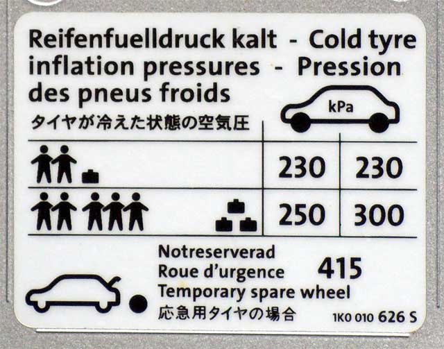

    Prius door sticker says the tire pressure just on a single condition, front 240kPa/35PSI, rear 230kPa/33PSI.
    VW Golf sticker says as attached photo.
    Ken@Japan

    I was just making sure if what Toyota tells us is correct. For example, if the answer was 70% front and 30% rear, or 50%/50%, 42/40 may not be the best idea.
    Just checking. Recalculating only if the numbers are way off of what I expect. That's all.
