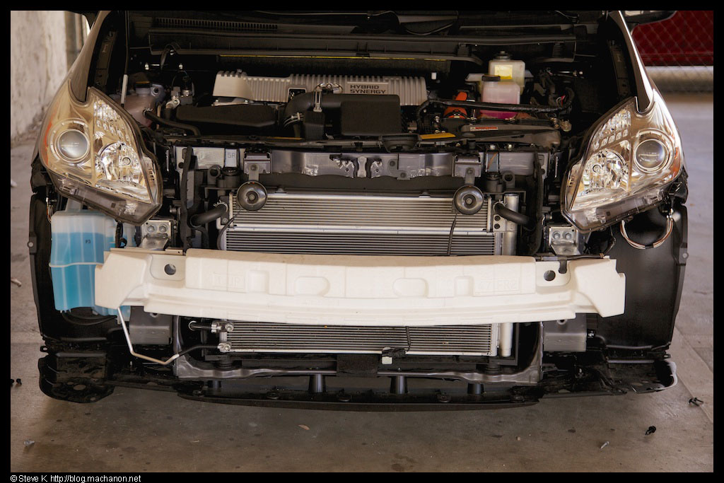

  3. Flyin2Low
    Flyin2Low New Member

    A few things:
    1) There is no such thing as "too light for safety." The Mitsubishi Mirage weighs 1800 lbs and has a 4-star crash rating; the Honda Fit weighs 2600 lbs and has a 5-star rating; our Gen 3 Priuses weigh more than 3000 lbs.
    2) The picture the guy posted is a Gen 2.
    3) The picture below, of a 2012 with the front bumper cover removed, shows no such weights. Also, I've taken 170 lbs off my car in the last couple months and had the bumper cover off several times; I like to think I would have noticed something as easy to remove as extraneous weights.
