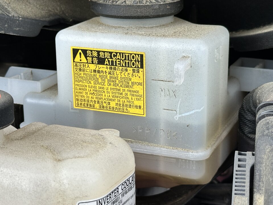

    So I had an opportunity to hear where the sound is coming from. See it too. It is the brake actuator pump behind the master cylinder.
    Also, the intake vent for my battery cooling fan was blocked with dog hair. Cleaned it all out. Should be better there.
    2 new questions have arisen.
    #1: How often should the brake actuator pump cycle on and off, when just sitting at idle?
    #2: Could a low brake fluid level contribute to it cycling more frequently?

    #1: not at all often enough to notice, unless you're sitting in the car long enough to read a book or something.
    #2: only if low enough to allow air to be sucked in. your photo does not show it that low.

    Yeah my brake fluid is below the low line and doesn’t make that noise, your brake actuator could be going out. Who knows, so many people replace their parts, I guess it’s a common parts that gets replaced.
