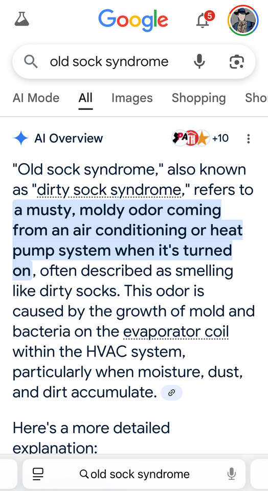

    Probably old sock syndrome

    Yep, Toyota's are known to get mildew and mold inside the A/C because leftover water is in there and then folks park in a dark garage where they can grow.
    Whenever you're about 5 minutes from home, and parking for the night, turn the A/C off and turn the blower fan on HIGH....(and don't have it on recirculate but bring in outside air) This will dry out that stuff where mildew and mold can grow. (I just had to teach this to my wife in her new Corolla....started to get that smell and I don't want to have to run the Toyota A/C refresher kit through it.)
