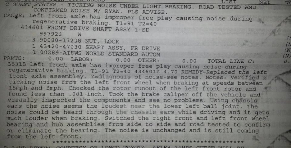

  9. si12j12
    si12j12 Member
    Mar 16, 2013
    64
    Today, while driving home I placed the car on neutral while decelerating and as soon as I shifted the lever the ticking noise went away.
    Although I have not gotten my problem fixed I will attempt to have the driveshaft assembly checked out. This is my 3rd and last try with the dealership.

    *Update*
    After taking in my car to the dealership 2 times prior the dealership stated they would replace the drivers side "drive shaft" the 3rd time around.
    They hope it fixes it and so do I.
    A final update will come once I pick up the car along with my impressions and copy of work order.
  12. si12j12
    si12j12 Member
    Mar 16, 2013
    64
    It has been fixed!
    Hope the noise does not come back
    Here is picture of the invoice.
    Hope it helps out any one else.
  13. bisco
    115,379
    52,814
    excellent! thanks for getting back to us, that was quite an ordeal(y)
  14. mrstop
    mrstop PWR Mode
    Jun 22, 2012
    740
    329
    109
    Cincinnati, OH
    Thanks for the detailed invoice. Glad to see a thorough diagnosis of the issue!

  16. Chris S
    Chris S Active Member
    Aug 18, 2012
    323
    111
    Gilbert, AZ
    Thanks for the detailed info!
    Now I'm definitely convinced this is my same issue and maybe I can make the dealer understand. It'd be nice if this info gets passed around Toyota now that there "official" documentation.
