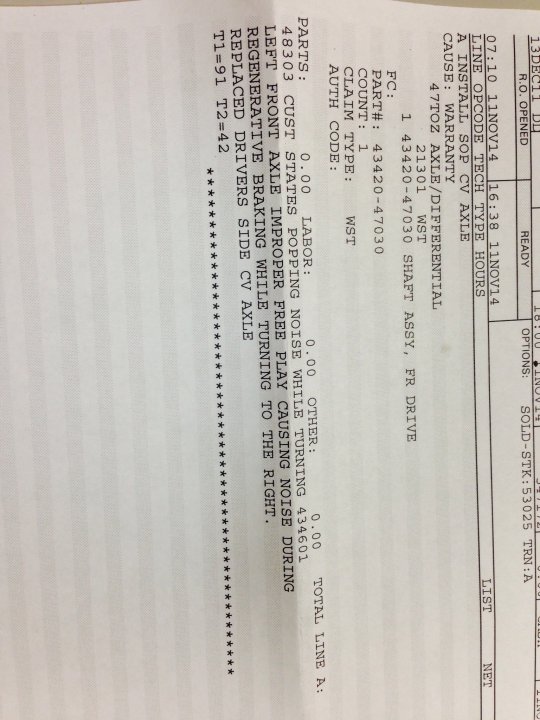

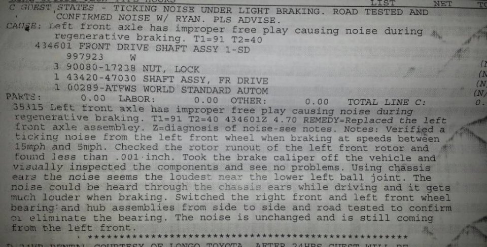

    Thank you for posting a copy of your invoice. Although my dealership did hear the noise, I had to show them a copy of your invoice in order to get them to diagnose the problem and agree to replace. A copy of my invoice is attached, perhaps it will help someone to get their issue resolved too

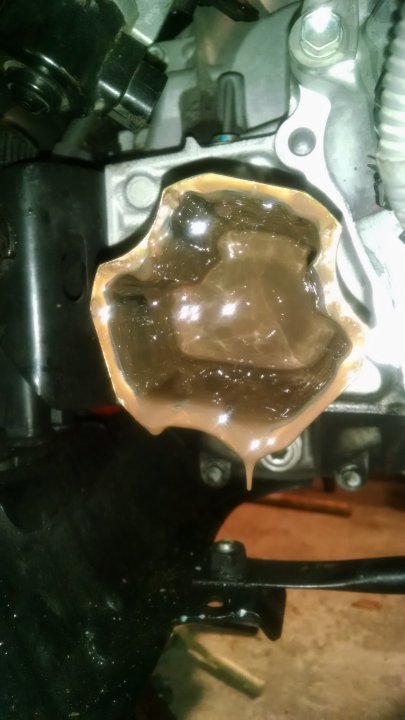

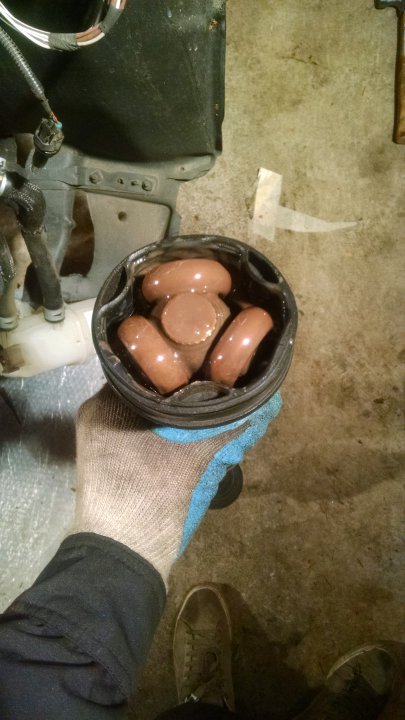

    I saw some pics of the CV joint grease posted in another thread (http://priuschat.com/threads/opening-engine-after-knocking.147677/#post-2106434). The grease does not look like the traditional CV grease that I'm used to. It looks very thin and less viscous. I'm wondering if Toyota is doing something different to get a bit more efficiency? However, it may be at the expense of durability.
    [​IMG] [​IMG]
    I have used Raxles.com axles in my lowered Integra for years. If the Toyota products are failing, it may be worth contacting them for replacements or advice.
