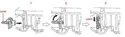

    I currently have a 2006 prius gen 2 and ot needed some welding on the rear arches
    So as per the advice i dissabled the traction batery and the 12v battery
    After the welding was finished i reassembled everything in the correct order
    When i tried to start the car it wouldn't start pass the inital ignition
    So after this i has an rac guy plug his laptop in and it threw these error codes

    Would that indicate the high voltage interlock is not closed properly, triggering all the other DTCs? I know it is a common mistake.

    But first remove and reinstall the hybrid battery interlock switch. And don't forger the third step of pushing it downwards after the leaver is turned.

    The amount of replys is amazing thank you guys youve solved it
    The hybrid interlock wasnt pushed down and being a first time prius owner this is my bad oops!
    After clicking it down the car came to life with 0 faults

    I noticed in the OP, every code was listed twice, so it wasn't nearly as huge a list of codes as it appeared.
    The P0A0D was about the interlock switch, and that's a code logged in the hybrid-control ECU, which naturally means the brake ECU will log C1259 and C1310, because those mean "hey, did you hear the hybrid ECU has a code?" The B1421 is just the not-sunny-out-when-you-read-the-codes code, the U codes are all comm errors and usually come in groups (if A says "hey I can't talk to B", chances are good B will also say "hey I can't talk to A"). Along with the brake pressure and HVAC servo codes, I would guess those got logged because, with the interlock open, the car didn't go READY, and enough time was spent wondering "why won't it go READY" that the aux battery got deeply drained at one point. That's my story, anyway.
