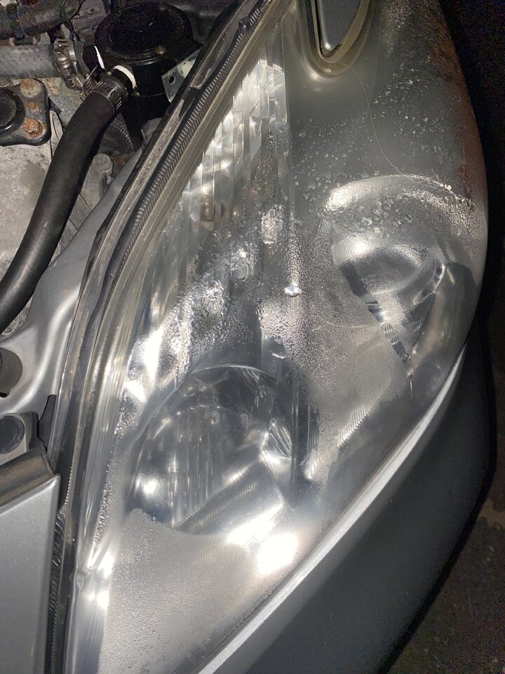

    Seems as though both my headlights have excessive condensation inside the lens. I recently polished them so it became more obvious. I have had the 2012 for less than a year it definitely had some front end damage
    any suggestions for good replacements or things to do to keep these in service?

    Drill a 1mm hole in the back of each (top of reflector) so the water can evaporate /
    Decades ago it was almost mandatory for all the cars I had....

    see aftermarket head lights (non LED) on Amazon for about $115 USD, and genuine Toyota on Amayama are around $300 USD.

    Come to think of it don’t some headlights have a vent with a short rubber tube?

    They absolutely do have a rubber tube with a 90 on it connected to a little vent tit maybe plugged

    Make a little adapter for your AC vacuum pump to lil to run pump 20 min

    I checked my 2011 headlights this morning. Yours are like mine. I still have the OEM headlight lenses, so yours appear to be OEM.

    Don't drill a hole at the top where water can get into it.
    There is a leak at the seal, somewhere.
    Using a vacuum pump would help, it will take a while though.
    pulling the bulbs out and using a flexible stick with a rag secured to it so you can move it around
    and get as much of the water out as possible, then leaving the bulbs out until it dries.
    Then seal along the edge where the clear part mates to the black part will keep the moisture out.
    Unless there is another leak somewhere.

    I ordered a pair of headlights and some led headlights bulbs to give those a try. I do hate not repairing the oem headlights but I would like to limit downtime
