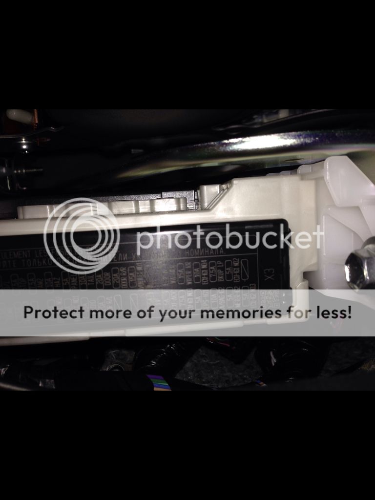

    ChapmanF, I found the instrument junction panel box.
    This thing is really jammed up in there. There does not look like any way to access this without removing it. I believe the bolt to the right might do the trick but I'm not sure.
    Unless you can give me any more insight I think this is turning into a project that is just not worth the trouble.

    The bolt you see probably isn't the only one. :)
    You might not have to move the junction box though. There are connections on most of the edges. The bottom edge is all fuses, as you see. The edge facing forward (against the firewall) is where the engine wiring and floor wiring plug in, there's probably no getting to those without moving the box, but you don't need to.
    The edge facing the rear of the car is where the instrument panel connectors, including 3A and 3D, plug in, the ones you'd be concerned with. I am guessing as soon as you find how that section of the instrument panel plastic pops out, below and to the left of the steering wheel, you'll be looking right at the connectors you want. That's how it goes in my Gen 3. They do like to clamp the wiring harnesses very securely, so you'll probably need to loosen at least one clamp to have enough slack to unplug anything.
    My techinfo subscription's used up for now, but that's where you can find the repair manual instructions on how the instrument panel plastic sections go together and come apart.
