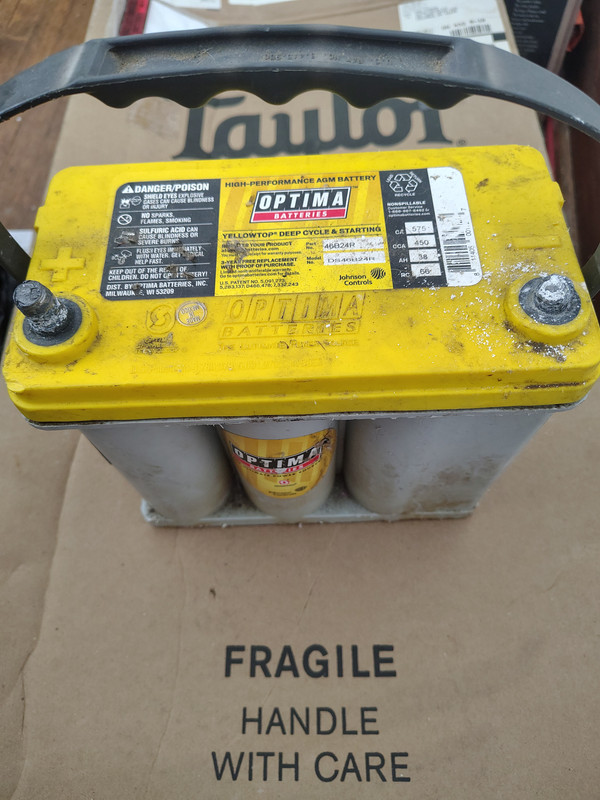

    @Tombukt2
    do you know if this is a resuscitatable battery?
    I've had it sitting for several years so I know its dead not to mention the post is broken. Always wanted to tinker with it but have so many other things to tinker with I forgot about it.

    No but it's a good core. You'll avoid the core charge and won't have to return to get a refund.:D

    In theory traditional 12V batteries can be fully restored if the case can be opened so that the lead plates can be chemically treated. Or I guess mechanically if a thinner plate is acceptable. The trick is resealing the case so that it never, ever leaks. When the top is off the battery posts can be replaced. After all that work it will be as good as new - but not better. To make it better (more capacity) the plates would have to be made larger. That might just be possible with an optima battery since the plate is rolled, but I have never heard of anybody actually doing it.
