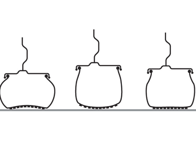

    The Tire on the left is under inflated, it will wear out on the outside edges, it has less contact with the road than the tire on the right, so will stop and steer worse. It may well feel most comfortable, as it can absorb bumps due to low pressures.
    The Center tire is over inflated, it will wear out in the center, it also has less contact with the road that the tire on the right, so will stop and steer worse. Ride quality will also be worse. While fuel economy may be improved, I do not recommend over inflating.
    The tire on the right maximizes stopping and turning with very good fuel economy and not much degradation of comfort.
    Sadly, the 'ideal' varies by tire, not just by Pounds per Square Inch. My Goodyear Integritys wore near the edges until I ran them at 42f/40r, but same sized Goodyear Authority Fuel Max tires wore out in the center even at 38f/36r. They just did not like as much PSI. Someone watching tire wear is the only true test, but I would start at 40f/38r and watch for wear.
    (These tire are not in the same order)
