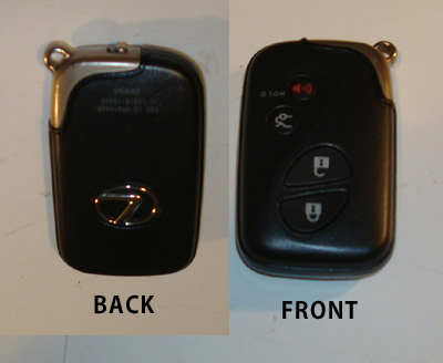

    Got it to work!
    I ran techstream and did an ECU reset.
    Executed the SKS registration utility option and BINGO.
    The used Lexus and two OEM fobs registered for a total of 3 of 7 possible for the car.
    The Lexus key fob FCC ID: HYQ14AAB works great.
    IMPORTANT NOTE: Always get new/used fobs that match the FCC ID code to be added to your car.
    Not bad for a $45 ebay purchase.
    Thank you for the support on this.

    Great that the Lexus keyfob works. I wonder if the tsunami caused a parts shortage for the Prius that they solved by using the Lexus part? Can you get a Lexus mechanical key cut according to the Prius design?
    Does the Lexus trunk button do anything? Like pop the trunk, or maybe turn on the air conditioning while the car is turned off?
    Is the range of the Lexus keyfob any different than the usual Prius keyfob?
    If you really want a Prius style keyfob, the Lexus circuit board fits in a Prius case. Good luck getting a Prius keyfob for less that $50 or $60...

    Those are great questions and ideas. I will do some side by side but by all accounts the ECU is from a Lexus and my original fobs are electronically identical to the used ebay one.
    The mechanical key; I might be able to mod my extra cut key I got from a guy on this site to fit the used fob.
