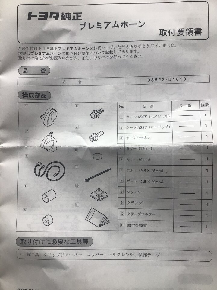

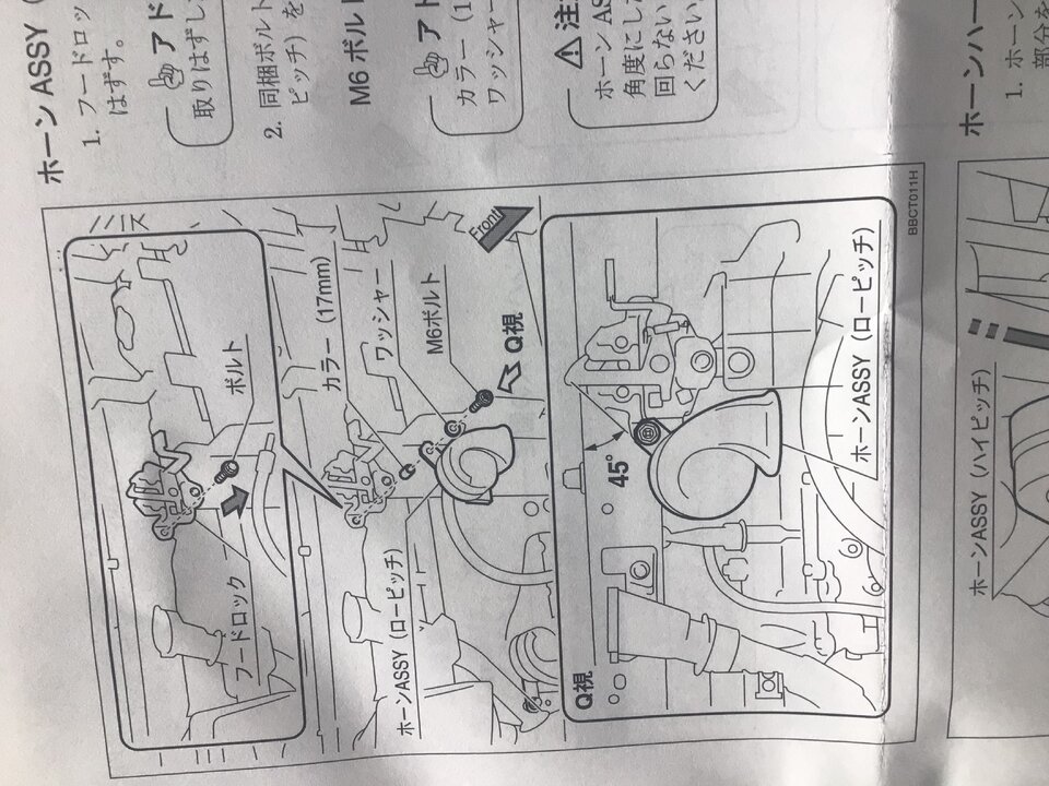

    The bolt holding the original horn is M8 x 15mm.
    I agree with Hammersmith and recommend that you consider getting the Toyota “Premium horn” kit, part number 08522-B1010. It’s high quality, good sound, not that expensive (eBay) and it comes with everything you need including the wiring harness splitter, 2 horns and all the required hardware. The only downside is that the instructions are in Japanese and for a different model.
    I made a short video showing the installation of this kit:
    https://youtube.com/shorts/XwnIUXTjHBI?si=r8AkyuJKkF19u-gp
    I mounted the second horn using the passenger side hood latch bolt (M6 x 15) but there is an alternate mounting location on the passenger side radiator support, similar to the original horn mount on the driver’s side.
