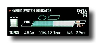

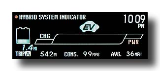

    On thing that might have caused confusion for the first salesman is that the SOC display on the Plug-in acts as if there are two batteries. It starts with the "logical" EV battery that goes down to "zero" when down to 1/2 to 1 mile of EV remaining and then goes back to "full" on the "logical" HV battery. You can tell which is which in that the HV battery shows the SOC in stripes and the EV battery is solid.

    ONE BATTERY 4.4kWh Li-ion battery pack, charged either by external power or regenerative braking
    Even though the computer screen shows an EV mode charge with a solid battery and a HV charge mode with a solid battery.
    Why does the display show the battery different in different modes if it is the same battery?

    To better depict what's available before & after depletion.
    Otherwise, the gauge would be worthless at times.
    It's pretty obvious when you actually observe it firsthand.

    Just to clarify for the OP: When the traction battery is depleted, the ICE will only charge the battery within a narrow range to support hybrid vehicle (HV) behavior. It behaves essentially like a non-plugin Prius in this case. The two different kinds of displays are for the purpose of illustrating how the system is currently managing things: as an EV or an HV.
