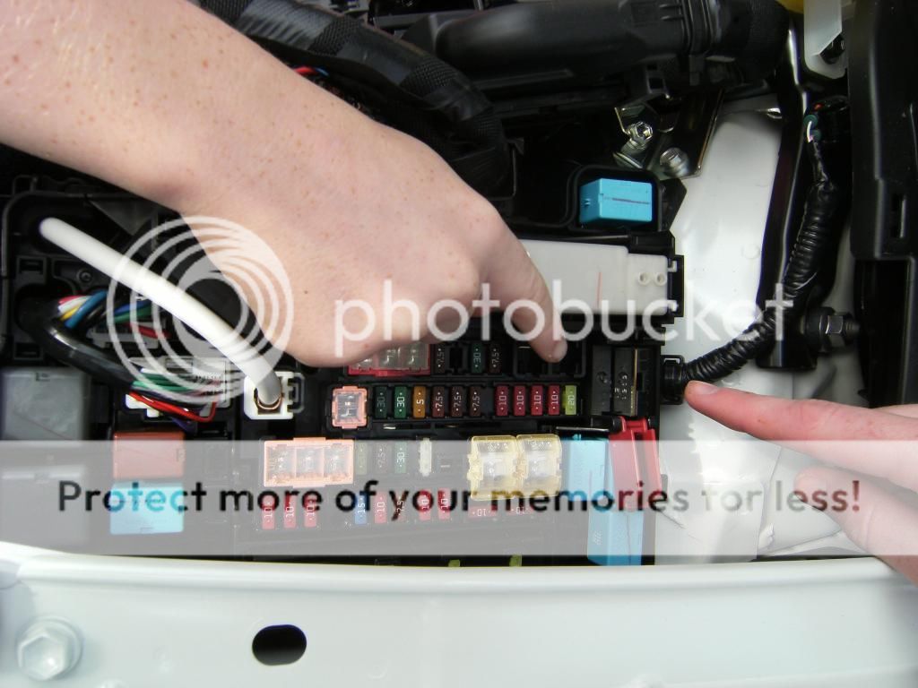

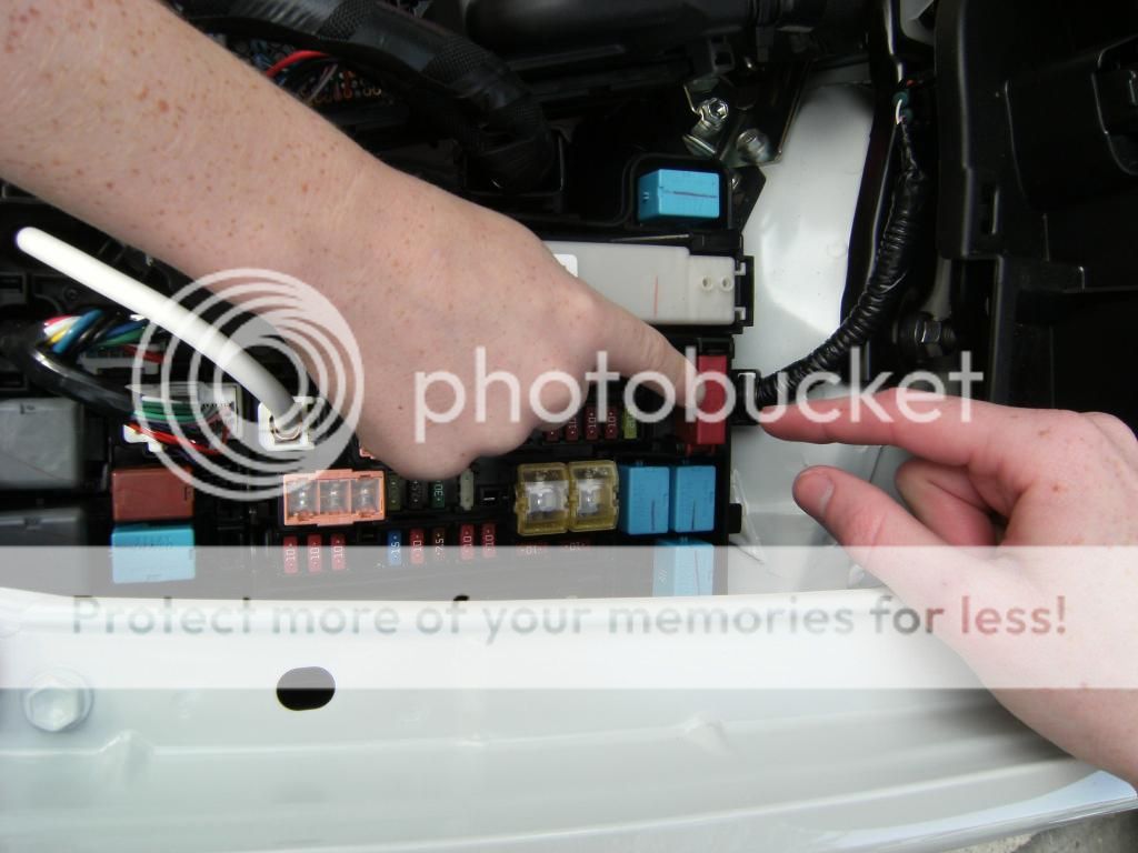

    Where are the jumper terminals in the PIP, again? I don't want to have to wade through the owner's Bible to find the info. It's kind of ironic that I can't use my higher-tech lighter socket "jump starter" cable on a dead Prius, but have to use actual jumper cables...
  8. El Dobro
    El Dobro A Member
    Jul 12, 2011
    7,106
    3,282
    Inside the fuse box under the hood, there's a red cap that pivots open to access the positive terminal.

  10. donbrownplug
    donbrownplug New Member
    Jan 23, 2014
    2014 Prius Plug-in
    PRIUS_PIP_POSITIVE_JUMPER_COVERED
    PRIUS_PIP_POSITIVE_JUMPER_UNCOVERED

    Thanks for the pics. Hope I never have to use it. Is it ok to use a battery tender on the aux battery?
