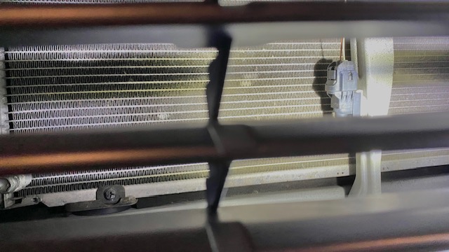

    My Prius looks amazing inside and out for its age. It really looks like it's maybe a year or two old I kid you not. I was just looking at the front of the radiator and it looks really good there as well. 33k miles JDM import from Japan. So it's only a matter of the plastics and rubber and hoses holding up.
    My thinking regarding the shield isn't about MPG, it's more about things as well as water splashing into the engine bay. I like the corrugated plastic idea.

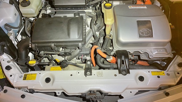

    Thinking about the statement I made earlier, it's almost like saying I'm 60 and I look like I'm 18. So I thought to take some pictures of the most wear area of the car.
    Tombukt2, I'll look into the aftermarket shield then. Probably better than nothing.

    Yep the car is clean as a pen If it looks that good under the hood I would hope the outside matches sometimes not. All the clips you want I'm not sure in Canada because I haven't been there long enough to visit auto parts stores but generally over in the section with the bolts they'll be this dorman brand or I can't even think of the other names of the fastener manufacturers but if you have one of your broken ones in your pocket you'll find the match dorman they come like 3:00 to a package kind of a rip off online you can buy a box for $21 and a red tool and it'll have about 15 or 20 of the kind you want and then it has the door panel pieces and the sockets that go into the door panel itself and a bunch of other ones You buy the kit according to the brand of car like Toyota and then you get this box and this red tool that helps remove the door panels in the various fasteners You can also use the fuzzy washer type based on the size hole that you have that you're trying to fill 5/16 etc those work very well too you just push them in and forget about them there's nothing when you're ready to pull the panel off you can just take the red tool put it under the head get it started and pull it out with your hand No need to worry about any fastener getting to a certain position so it can pull through and all that.

    Thanks for the links Mendel. I'm also missing the radiator support cover (that big black piece in the engine compartment) is of any importance? I would think not.
  11. Mendel Leisk
    61,585
    42,366
    That’s more cosmetic. Still your engine bay looks really clean/neat…
