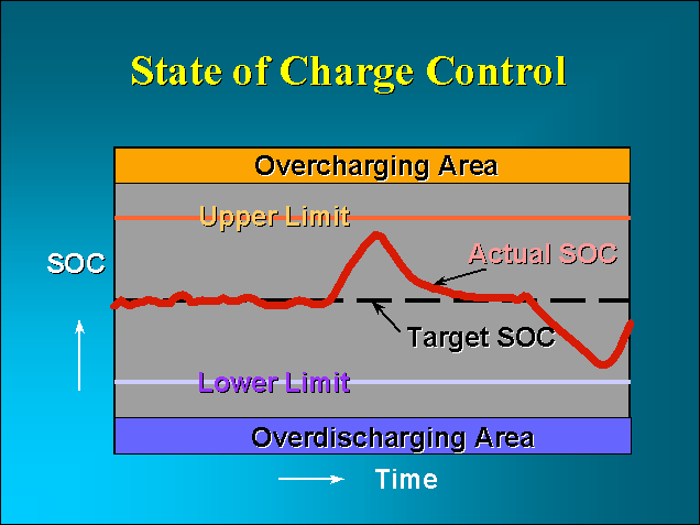

    When all 8 bars are full, the battery is at ~80% SOC. When all the bars are empty its at ~40% SOC. By default the controller tries to maintain the battery at 60% or about 6 bars (scale is non-linear). The car will not normally charge above six bars unless you do something to add more charge than it was expecting like drive down a long hill, or decelerate off the freeway. After that the car will quickly use a little more electric drive to burn off the extra charge and get the battery back down to 60%. As you approach 80 or 40% the car gets much more aggressive about moving back towards 60%.

    Please refer to following chart which shows how the battery SOC is maintained.
    Anyway, the whole presentations are worth to read.
