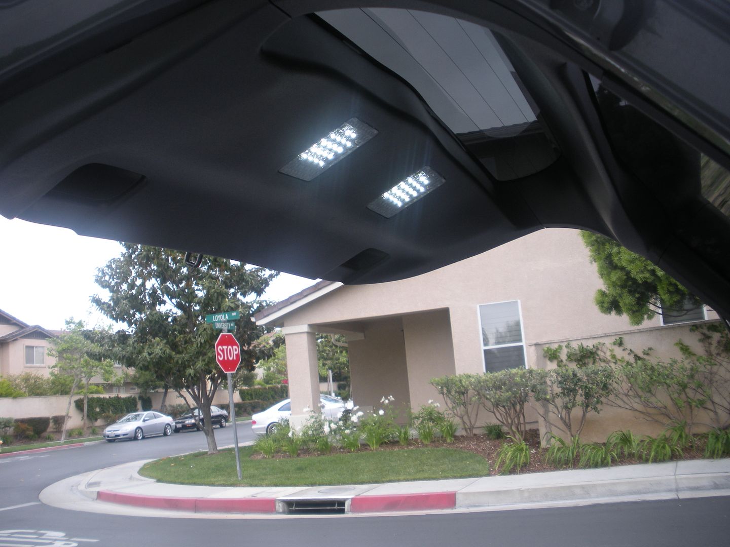

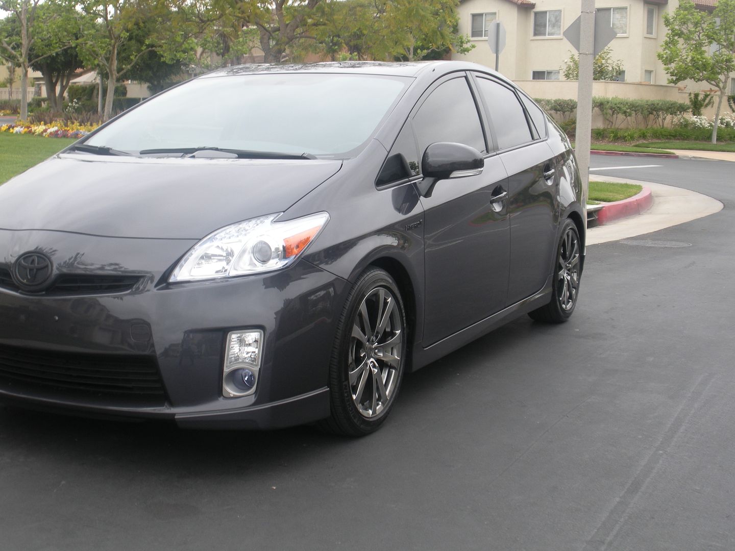

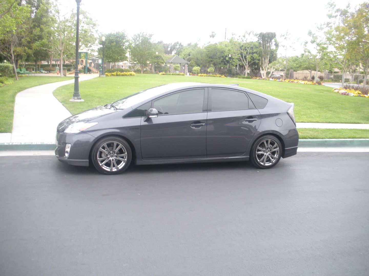

    Took some pics outside today...and Put my car up For Sale today.
    A pic of the rear hatch LED's...

    Are these the actual color? They look way better then the ones with a slight blue tint.
    Would you mind sharing the link?

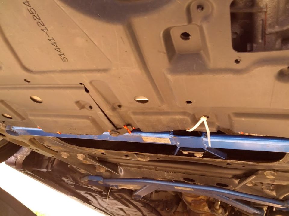

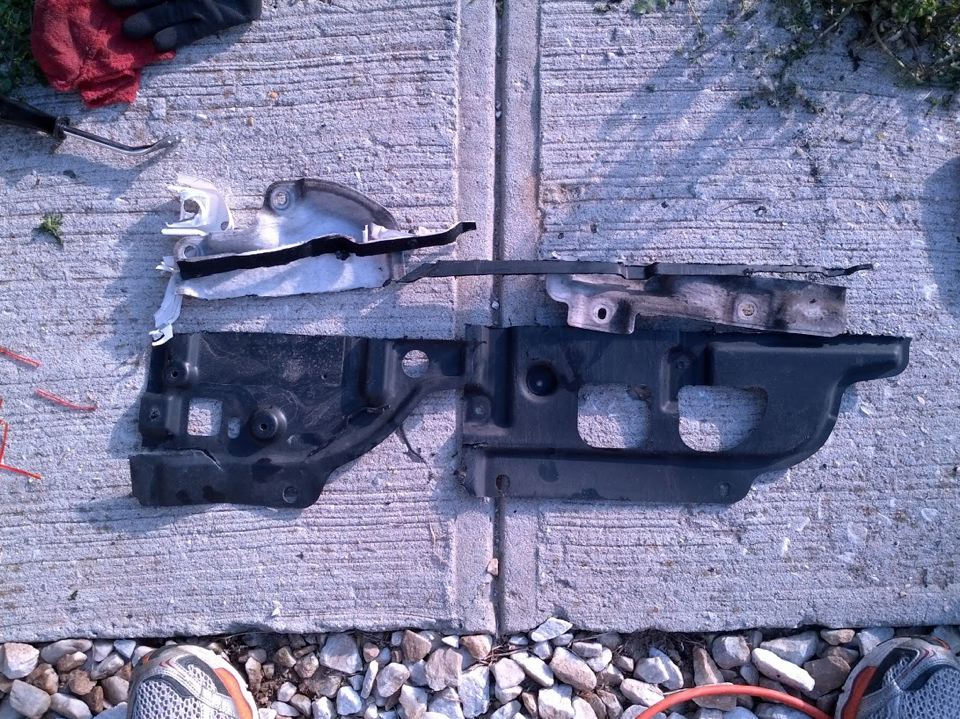

    Here are some pics of the undertray I modified.
    Pic of the fat I trimmed off. I used a Dremel with the cutting wheel and a sanding wheel to try to clean up the cut.
    Pic of the under tray mounted, it fits flush up to the Cusco bracket. Also, I relocated the popit bracket that secures the flap to perform oil service.
