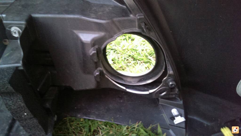

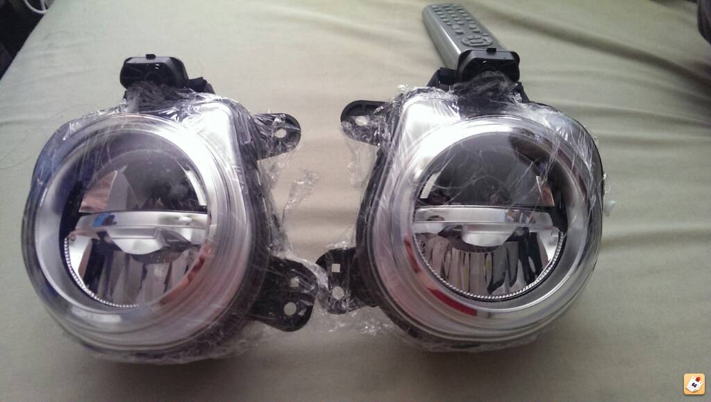

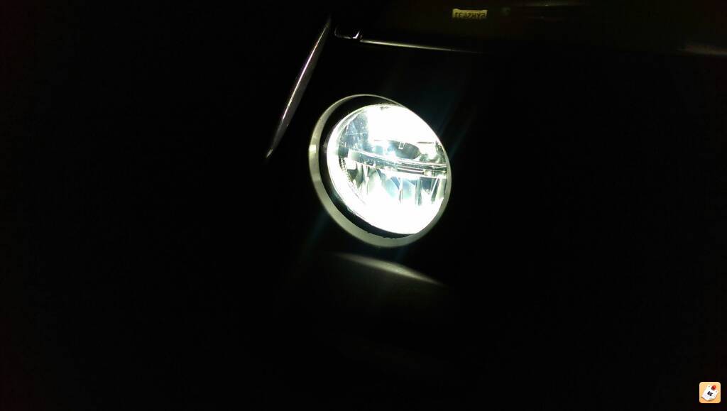

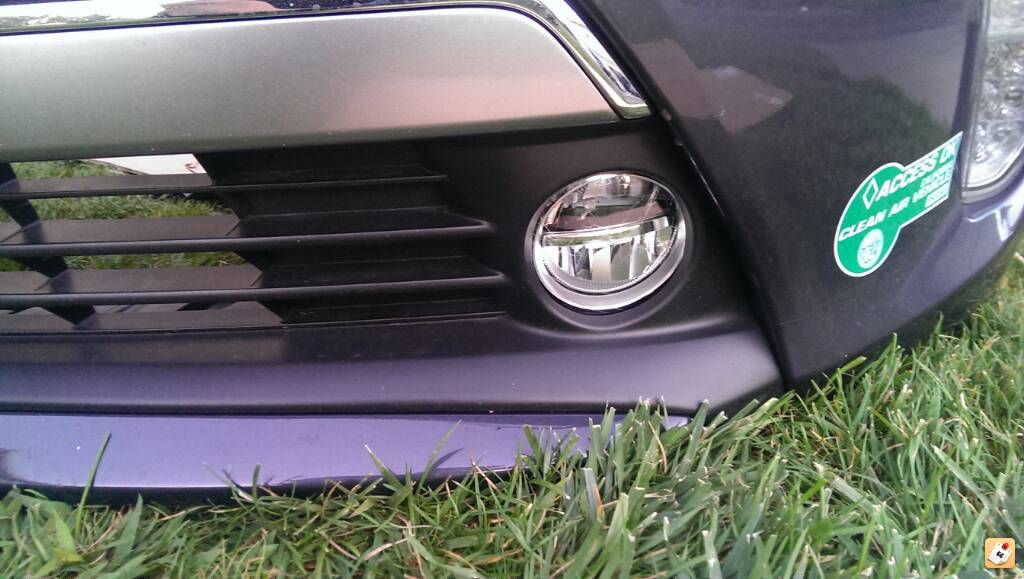

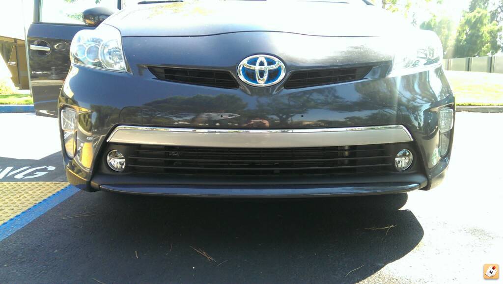

    Just a something I am working on...haven't had a chance to hook up the wiring or adjust alignment. Won't be able to do that for the next 2 weeks..

    Oooh what fogs are those?

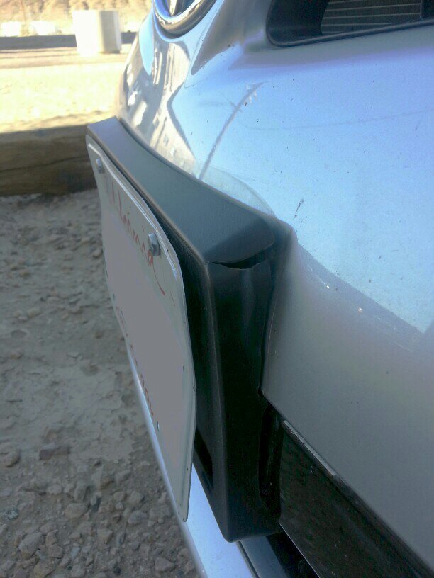

    Someone backed into me at the target parking lot

    Bloody hell! What a way to ruin a day.

    I might get a dash cam now

    And dont forget the BumpShox.......your pics shows is not even a light bump.

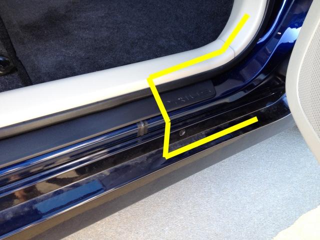

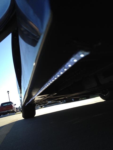

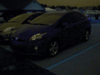

    On my old Red Prius 5, I had installed a set of white LED ground effects lights under the rocker panels tied to the JDM Mirror puddle lamps. My wife actually like this mod, so I installed a set on this car for her as well.
    PRO TIP: by connecting JDM Mirror puddle lamp ground wire to the dark blue wire in the 'A' Pillar; even if the interior dome lights are turned off, the puddle lamps outside will still work!
    Note: GIF Converter hosed the colors, but you get the idea... (ha ha, just noticed: the Red car looks Blue, & the Blue car looks Red!) :)
    [Red Prius]
    [Blue Prius]
    [Under car LED's]
    This is how I ran the wires:

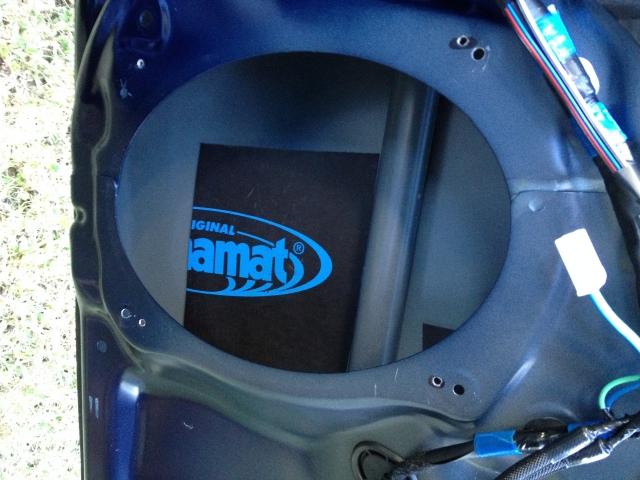

    I was also going to replace the front door speakers and dash squawkers. I got a set of Infinity Reference X REF-6502ix from Crutchfield for the front doors (their recommendation). They come with the plastic Scoshe 6x9" to 6.5" adapter rings and Toyota speaker wire adapters ($89 total). They did not come with sheet metal screws though, and they email the master sheets so the cost of printing the generic Prius install instructions is on the customer now. I paid more than I wanted expecting to get a plug-and-play install, but nope. Go get some sheet metal screws, drill our rivets, drill different holes, tape, mount, etc...
    Spent a lot of time on this...
    NOTE: If you have JBL Premium Sound - think about this before replacing speakers:
    I found out the JBL Amp has crossovers in it, not the head unit. Also, head unit supplies just Left & Right - the AMP provides fade to Front/Rear (they do not know what the crossover frequencies are).
    This means: highs go to squawkers, lows go to door woofers. I did not get any highs at the door. Plus the JBL green edge tweeters were actually pretty good like the stereo shops said. SO, unless you are concerned about the paper in the JBL woofers rotting, I did not see any reason to replace them. While I had the doors apart, I installed some Dynamat:
    End result: I did not change any speakers (Crutchfield said they should not have sold these based on how JBL premium is set up). But my doors to not sound like a tin can when closing anymore.

    If there is any silver lining to this, it would be that now you can fill in the holes and have a smooth front bumper.

    They are oem led fogs off of the new x6

    Do they fit the oem Toyota shrouds/mounts easily, or is modification needed? Do any of the BMW mounting tabs match up with the Toyota foglight mounting points? Thanks. :)

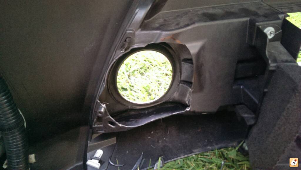

    The one Jay linked is the one I bought.
    The fogs are very large and do not match to any mounting points. Just a disclaimer, fitting the fogs on required me to permanently cut my bumper and create my own mounting brackets to make it fit. Without modifications, the fogs will not get even close to the bezel.
