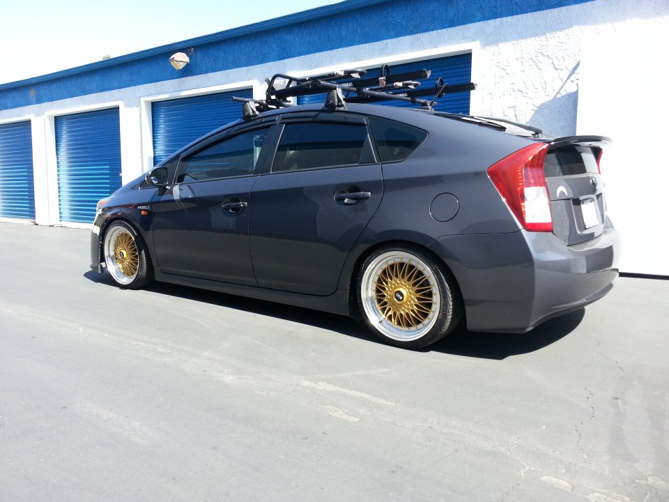

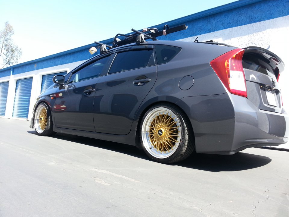

    Looks great!! Did you have to use spacers for the front/rear ? The wheels have a 30mm offset

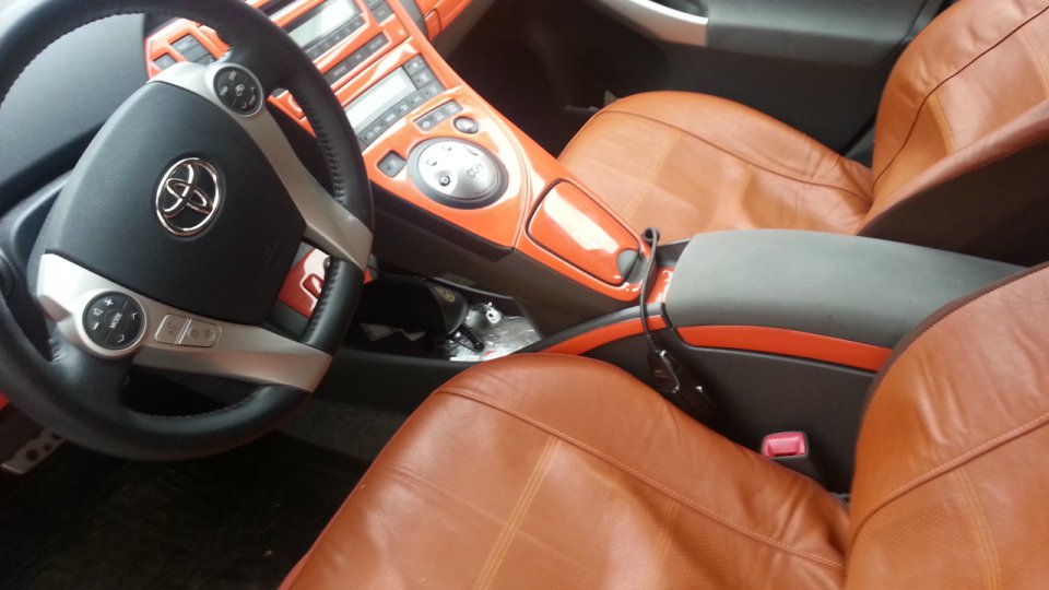

    Do you like it guys or not ?

    I have to say thats looks cool and unique, but I'm not sure I would want to drive it.

    That's right. Take a close look at this shot.
    Unless you have a well equipped machine shop at your command, fabricating these brackets on the cheap would probably make a cool mod uncool.

    Is the exterior orange as well :) ?

    I always have wondered what the bronze wheels would look like on the winter gray Prii... its different but looks pretty cool.

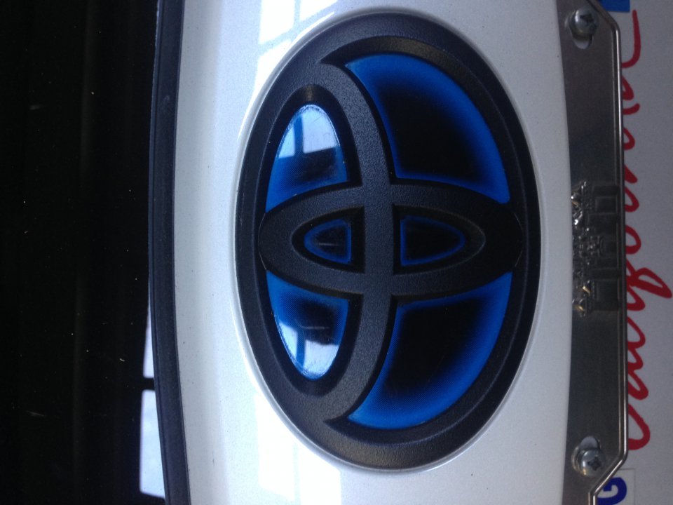

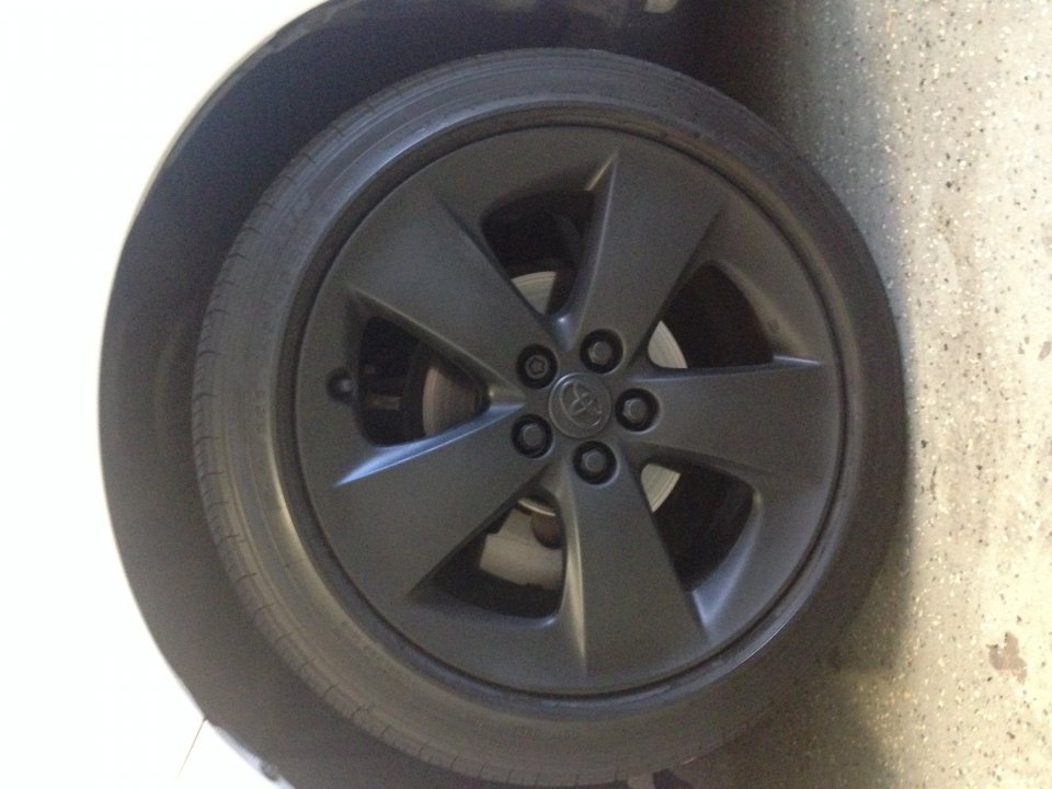

    I Plasti dip'd my wheels and emblems. A super inexpensive mod thats easily removable! (sorry the pictures are sideways) IMG_4112.JPG IMG_4115.JPG

    Thanks! It's very easy to do, there are plenty of videos on Youtube that show you how to step by step. It comes in a can like spray paint, which I bought at Lowes for like $6 each. It took 3 cans to do all the wheels and emblems. All you have to do is mask off the emblems about an inch all the way around. You spray about 5 coats and when your done you just peel off the excess and it cuts itself around the emblems. (If that makes sense?) I will post a couple of links for the wheels and emblems.

    How do you avoid getting in in your brakes when doing the wheels?

    Plastic bags and tape :) they have a video on their YouTube channel

    I just cut up trash bags to cover the brakes. I would also recommend putting some newspaper or plastic down by the bottom of the wheel to prevent overspray from getting on the ground. I didn't think of that until after I was done.

    If you cut a plastic garbage bag in half. Then, feed it through your spokes and wrap it around your brake drum. Any overspray on the tire can simply be peeled off.

    "All you have to do is mask off the emblems about an inch all the way around. You spray about 5 coats and when your done you just peel off the excess and it cuts itself around the emblems."
    so one doesn't have to make a real mask for the emblems?
    & they stay on the car all the time?
    how will that work with that "cuts itself"?

    But to answer your question:
    No, not an exact mask around the emblem. The way plasti dip works (literally removable/peel-able plastic in an aerosol can) is that when you spray on your 5 or so coats, you will remove the tape and begin to peel up the overspray. When you get to the edge of the emblem, the plastic will separate at the edge of the plastic-paint, creating a "cut" automatically. You'll see what I mean after a video or so. They have a specific video for emblems, I believe.
