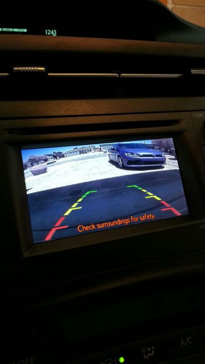

    Yeah they are static, they don't adjust with the wheel movement like my friends '14 Escalade :unsure: But at least I get way better MPG, haha.

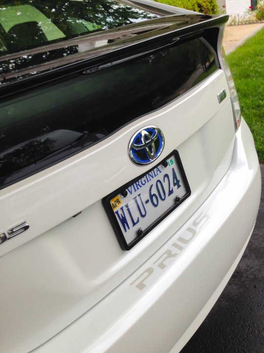

    Today I covered the front and rear toyota emblem so that they are now a black background with the chrome toyota symbol.
    I ordered the carbon fiber look film online and simply covered the blue/black original plate behind the chrome. It ended up being VERY easy and no disassembly of the car was necessary. I think getting the blue off the car was a good thing.

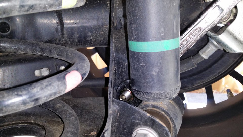

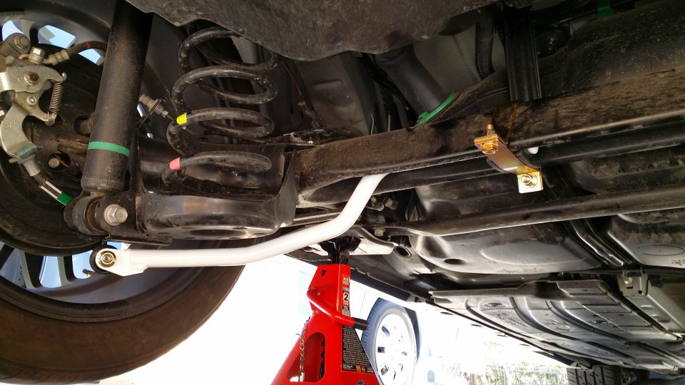

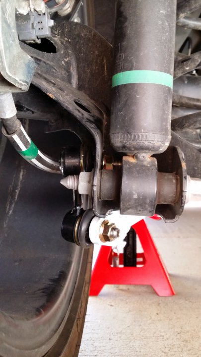

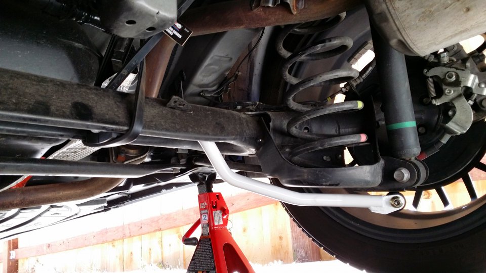

    I installed my TRD rear sway bar today.
    20140605_130824.jpg 20140605_130846.jpg 20140605_133658.jpg 20140605_133320.jpg
    A couple of notes:
    1) The instructions suggest using a bungie strap to hold the bar up during install. Great idea.
    2) The instructions suggest removing the lower shock mount bolts to give you better access for inserting and tightening the endlinks -- I found this wasn't necessary because I was able to gain access with my 15mm end wrench from above.
    UPDATE: I wasn't extremely optimistic that this sway bar would make a huge difference. Now I've had a few days to try this out. There were a few turns on my morning commute where I could easily scare myself with the roll. This TRD sway bar has eliminated that. No more scary rolls!

    You will definitely notice an improvement on your handling. Its fun and scary at the same time, but it feels so right :rolleyes:

    There is one particular freeway overpass on my daily commute that calls for this. This might be first time I've looked forward to going to work in the morning for a long time.

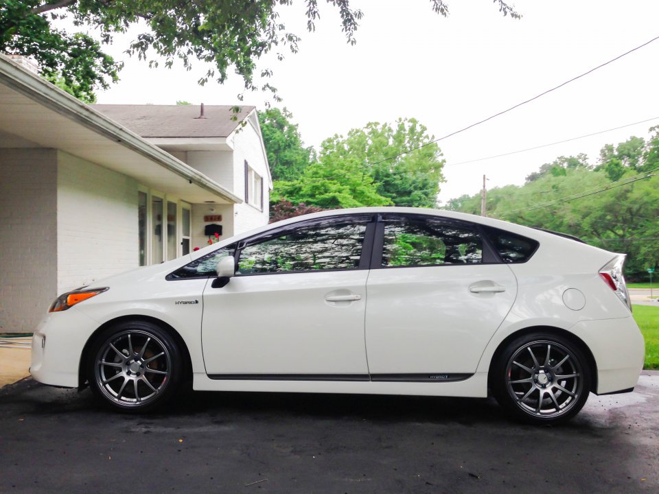

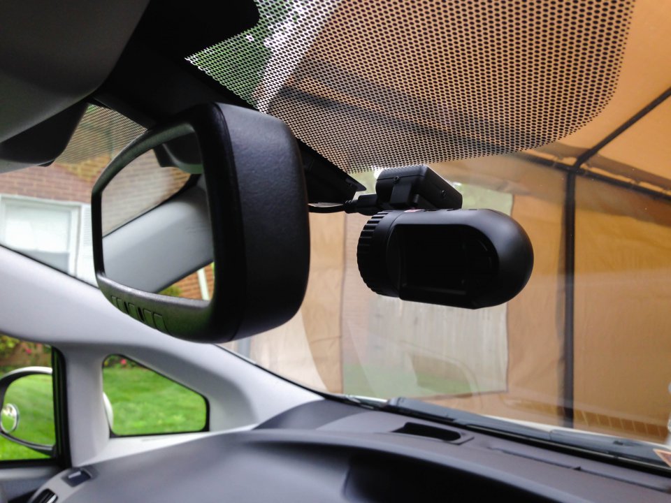

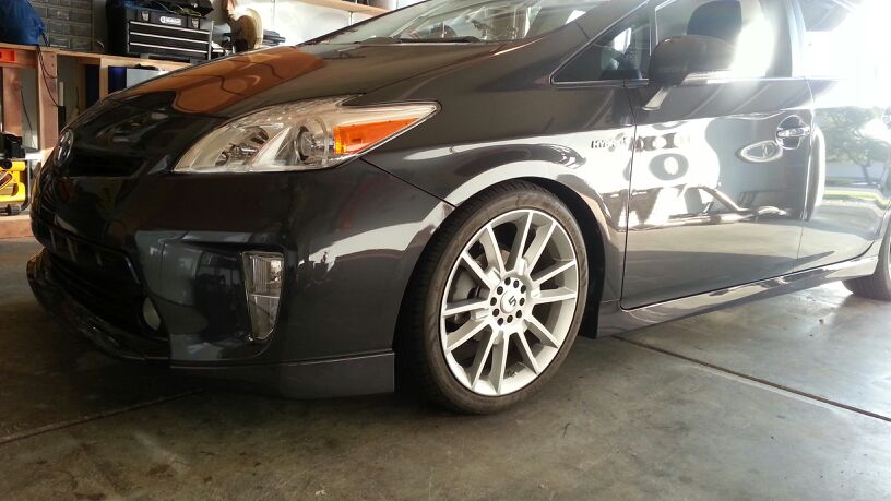

    Installed TRD lowering Springs, TRD Sway Bar, SSR GTV02 wheels, JDM window visors, Valenti 3rd brake light (smoked), Rear Bumper Applique, Dash Cam and quick car wash.

    wow looks great! your prius definitely got some love today!

    Love the dash cam !!! Two thumbs up !!!

    Tint the front windshield?? your asking for trouble haha.. I from Colonial Heights and I'm sure I'll get pulled pretty soon as I just did 20% all the way around! Give us some details on the dash cam. How it powers up and where u got it from etc... 20140604_170124.jpg
