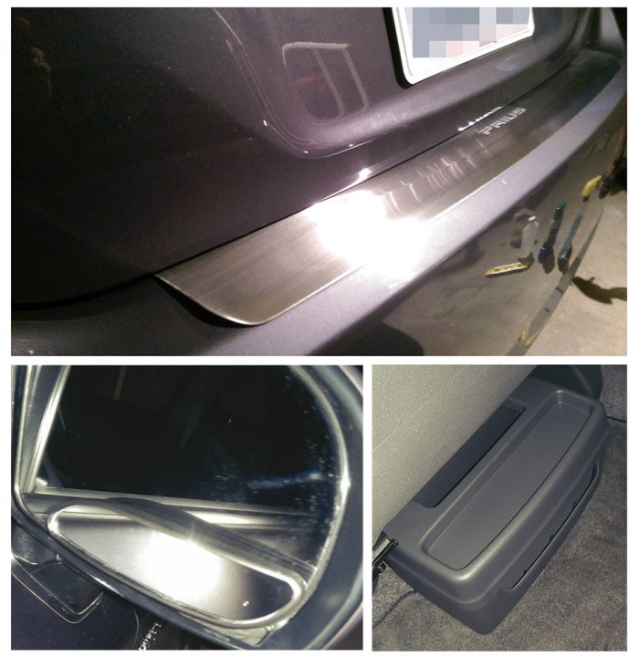

    Surprised to see my delivery from Japan on my doorstep when I got home. Couldn't wait to do some mods!
    Part # 08475-47030 - Rear bumper step guard, Carmate blind spot mirrors, Part #08471-00050-C0 - Rear multi-box.
    Got the JDM clean box (part # 08480-47050-C0), but didn't have time to install.

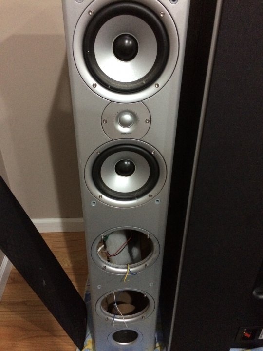

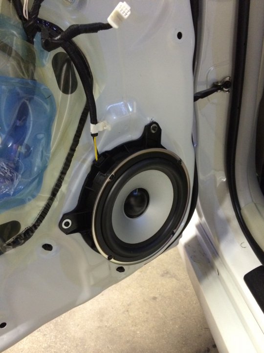

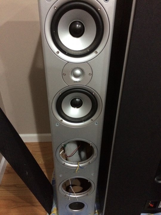

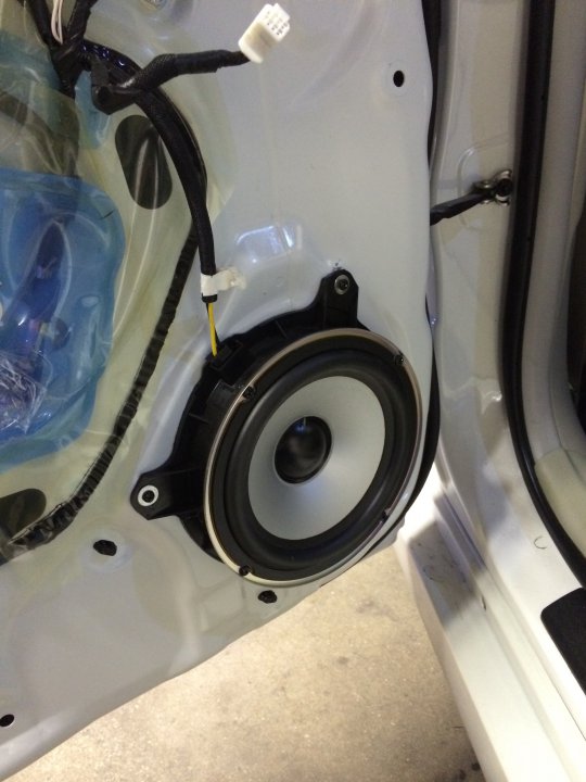

    Recycled my polk standing speaker which i bought few years ago for my prius speakers. Zero cost = great sound system. Who needs a sub with these speakers? I have 2 lift so will be installing for the front soon. image.jpg image.jpg

    Good luck, car audio speakers are designed to withstand heat, humidity, and vibration, which home systems don't usually encounter. Also, there may be impedance differences between home and car speakers.

    yes, be careful. most home speakers are 8 ohm I believe...and car speakers are 4 ohm. I'm not sure what this would do to the speaker in the long run. perhaps burn it out? But interesting to see how those polk speakers would sound in the prius !

    Probably won't hurt the speaker, now the amp may be another issue.

    when we were wiring up the mirrors and had the door panels off I noticed the jbl's were riveted in! Why in the world would they do that? How do u even switch them if u ever wanted to.. drill the rivet out?Then how do u re install some others?

    Ideally, you gotta drill out the rivets and either fabricate a new speaker mounting plate, or a pre-manufactured one if you are doing a speaker swap.
    Beats the heck out of me why Toyota did this. My old 89 Honda civic was a breeze to swap out the speakers.

    Yes, u would have to drill out the rivets.to reinstall just use new rivets

    Increasing the speaker resistance from 4 to 8 ohm should result in less of a load to the amplifier drawing half the current.

    Actually it is impedance , not resistance. Whole different ball game there.

    Never thought about it. Thanks for the input.

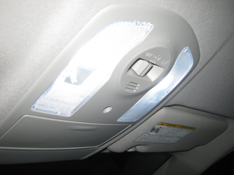

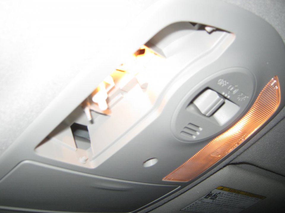

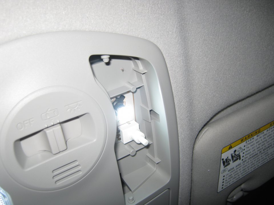

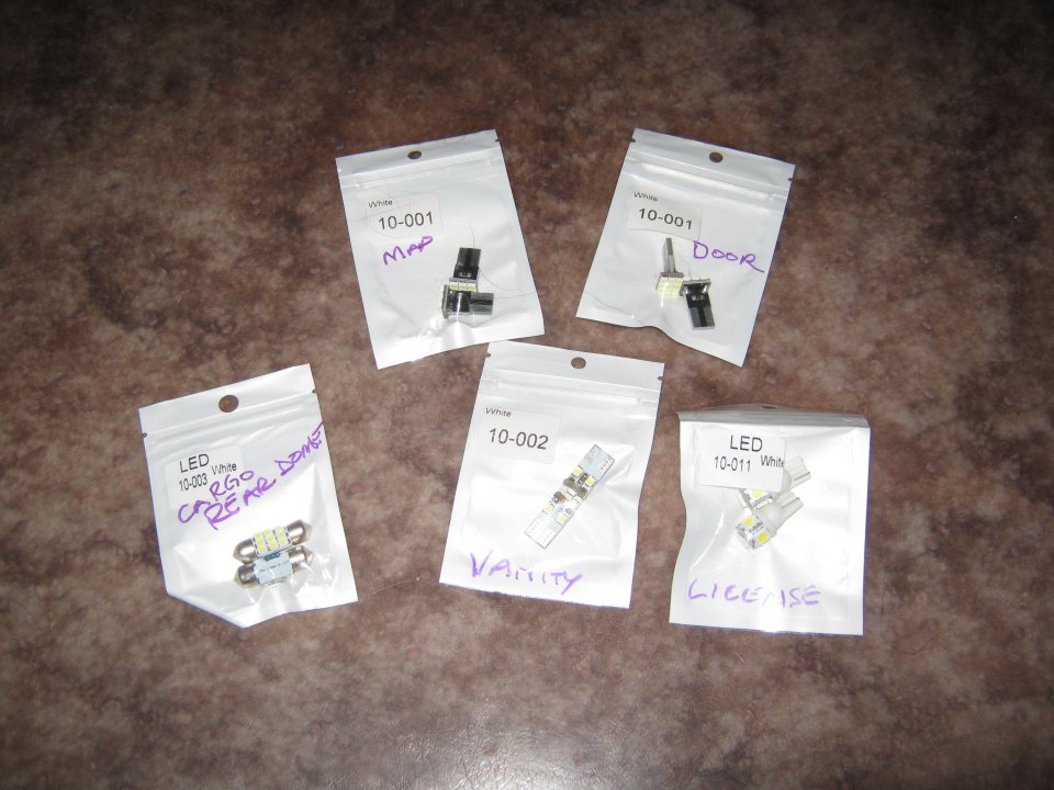

    First success, map light LED's installed in less than a minute without cracking or breaking the covers.
    ...except for the minor burn irritation from grabbing a HOT bulb with bare fingers. o_O
    Impressed with the amount of light emitted from the LED's.

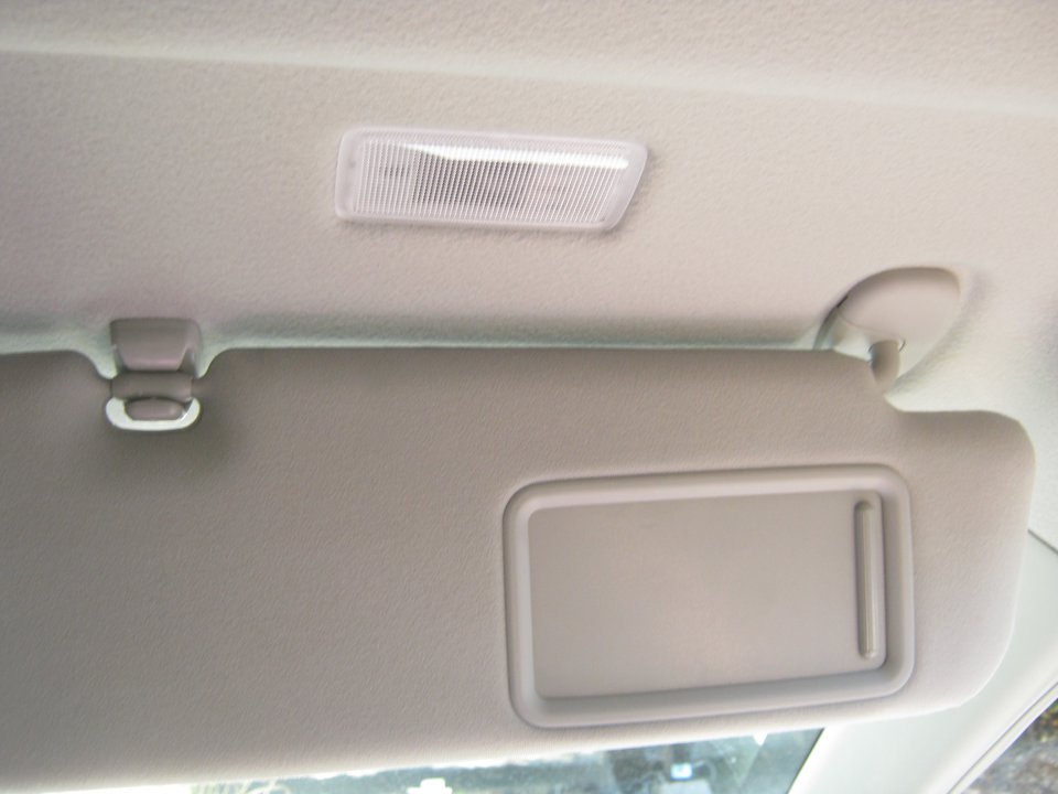

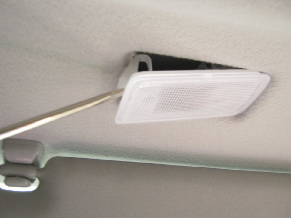

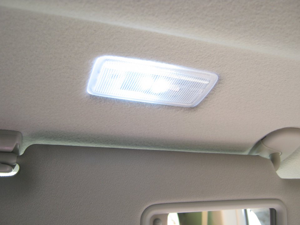

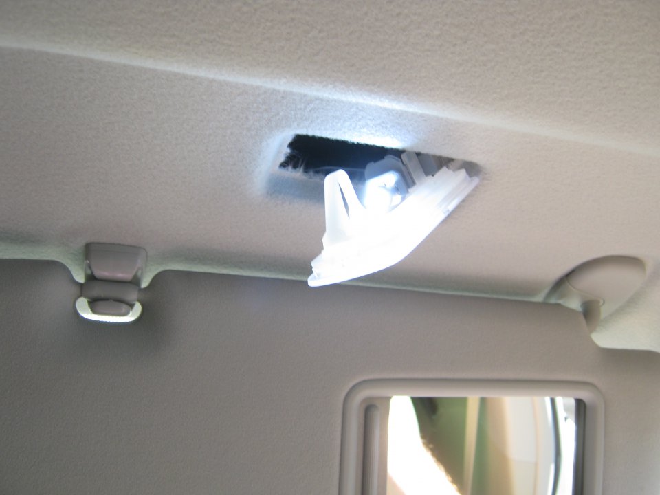

    Success!! Vanity LED's installed and not another burned finger or cracked/broken cover.

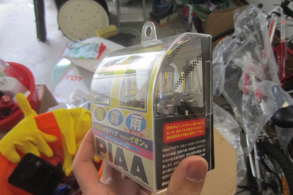

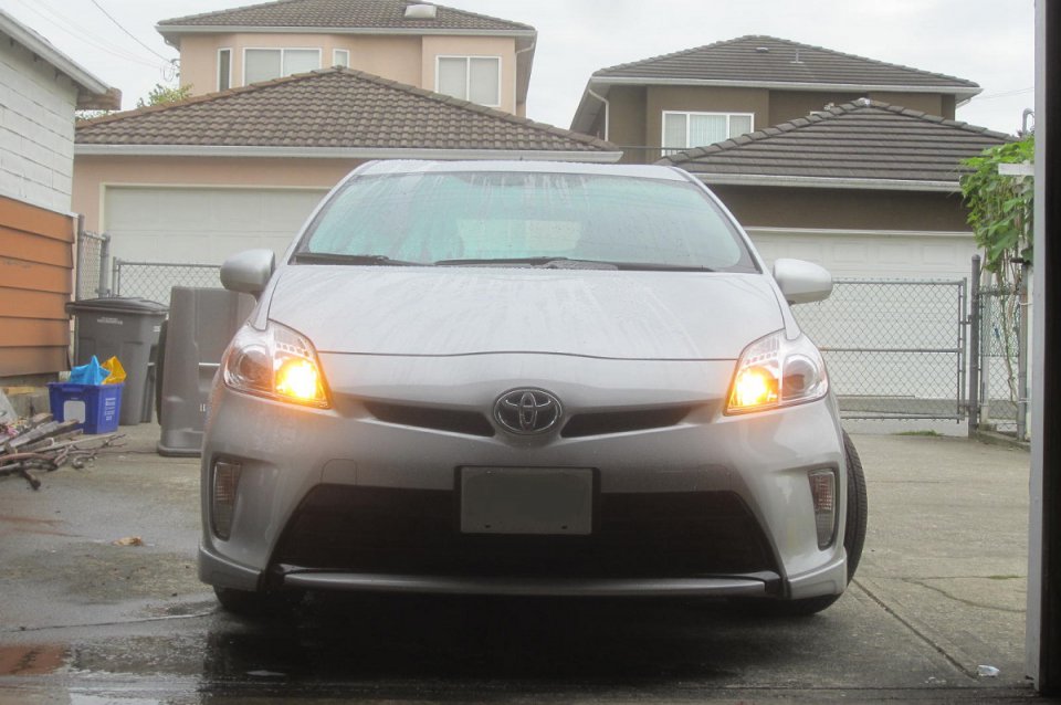

    I bought some high quality (supposedly!) PIAA bulbs to replace my DRL high beam bulbs. These are yellow; so rumoured to be better for fog / inclement weather. I highly doubt it although IMO, it makes the car look a little different than every other car out there :). When spring and summer time rolls around, I will change back to OEM bulbs.
    The last time I purchased aftermarket "colored" bulbs for the car was over 10 years ago when I had my 89 civic. Right after the install, I turned on the headlights only to find that one had immediately exploded in the lens, ruining their reflective design (I made absolutely sure that there was no fingerprints on them before installing!). So this time, I went with a higher priced, higher quality product. No guarantees these won't blow but they are made in Japan. I was weary about buying the Nokya ones which are 4x cheaper.
    Now there is just one more mod to do on the Prius before I call it quits... :)
