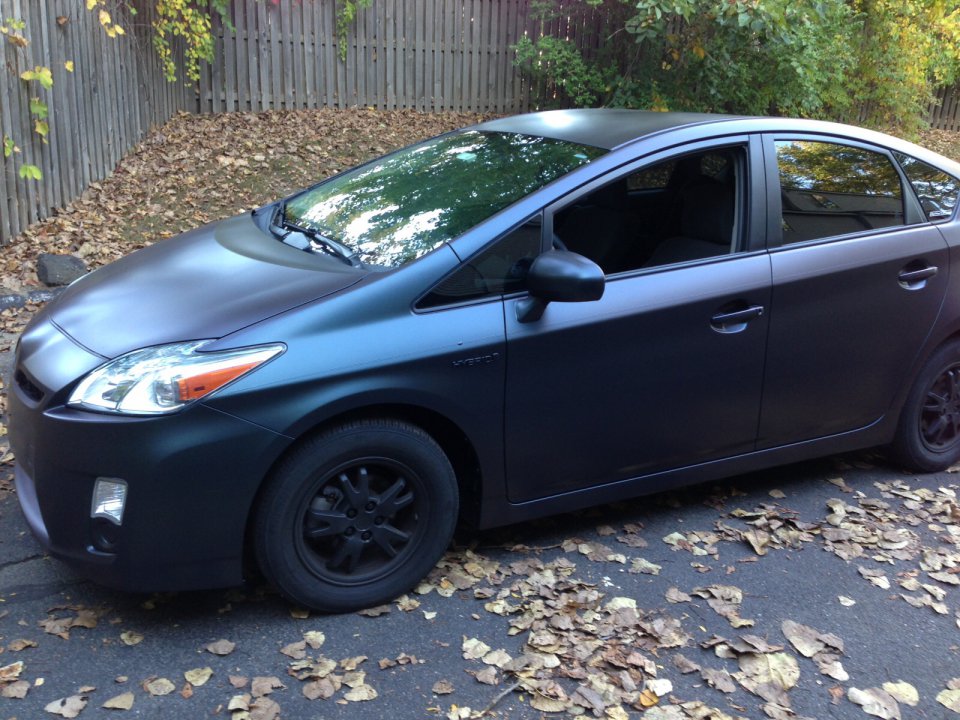

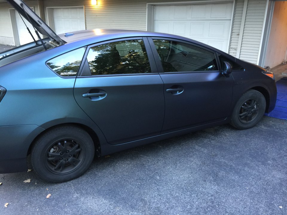

    The plasti dip looks great! nice work. i haven't seen one in person. does it look as good as a good vinyl wrap?

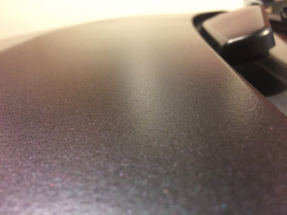

    Thanks, I haven't seen a vinyl wrap car so I don't have a comparison.... But if u use rattle cans on big surfaces there is a lot of texture, but if u use the proper hvlp gun like I did it comes out pretty smooth. image.jpg

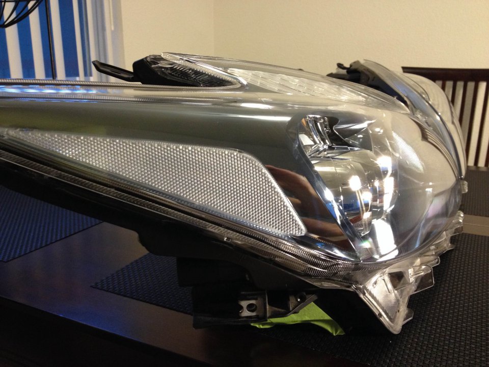

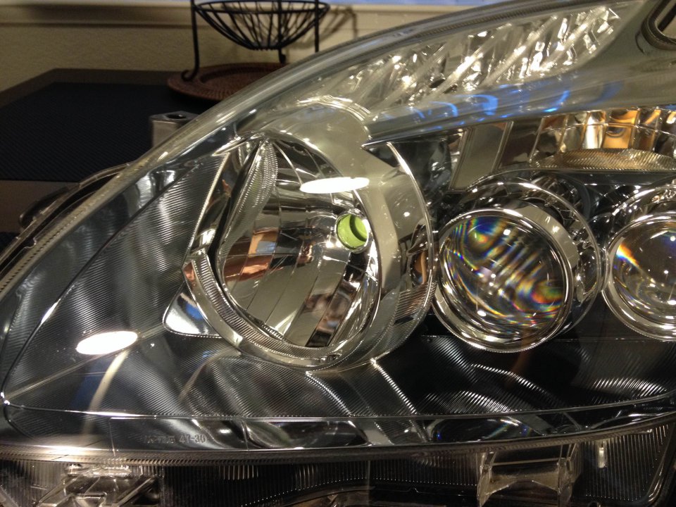

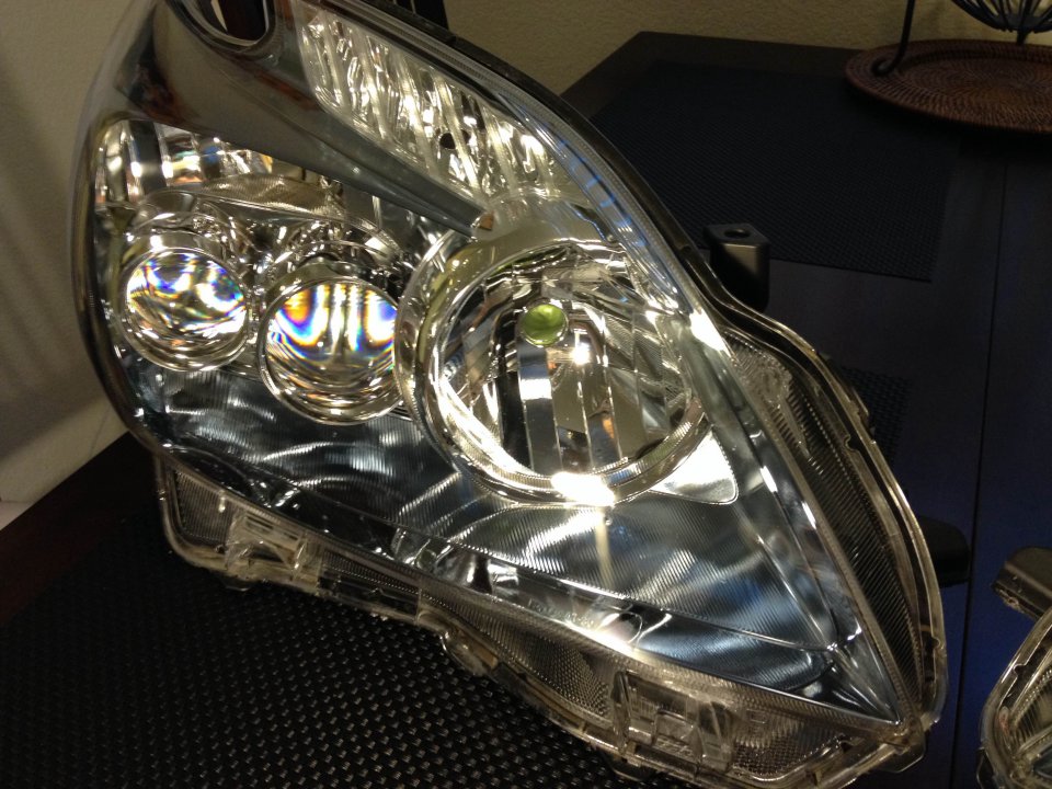

    Picked up the JDM LED headlights from restoration.
