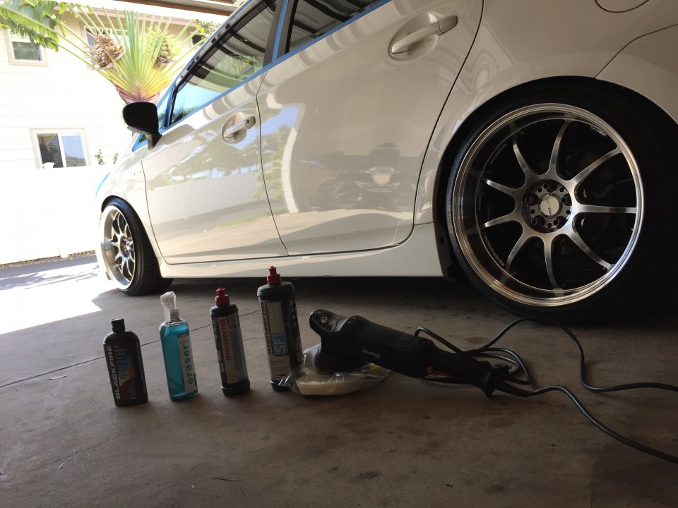

    Washed and clayed yesterday, now time for polish, polish again, then throw some black fire sealant on :) WEKFEST prep so much fun..... Haha image.jpg

    Sean! Good luck at Wekfest. Funny thing, I was just asking some local Prius owners what they use to wash/clean their cars. What products do you have laid out there and what do they do if you don't mind me asking? Thanks!

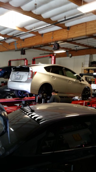

    Getting camber bolts and camber shims installed and realignment by Speed Element. 20150128_144902.jpg

    For regular washing I use Meguiars ultimate wash and wax. For detailing what I had laid out was a menzerna 2500 which is a medium cut to remove swirls and scratches and 4500 which is for finishing it's very light cut polish. Also "Eraser" which will remove all the oils from the polish prior to putting the last product shown on which is black fire wet diamond paint protector. That's what I use as my sealant it's much better then wax and lasts a lot longer.

    Why are you getting all this work done? Installing larger wheels?

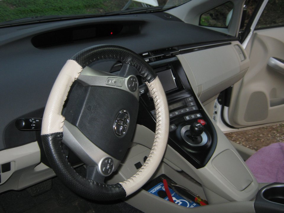

    Ruh roh... :oops:
    OCD is acting up again... :eek:
    ...that black HU adapter against the gray dash is still bothering me... :(

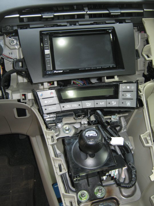

    ...and all I was going to do was make the 12v plug under the flying bridge hot 24/7... :p

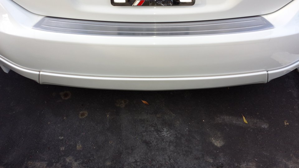

    3M is my friend. Installed jdm stainless steel rear bumper protector.

    Matching HU adapter and center console... (y)
    Through the magic of Photoshop... :whistle:
    Not... :p

    No, when Speed Element did the original alignment after lowering it, they tried to get it to true 0 but was off a couple of degrees. So they recommended camber bolts for the front & camber shims for the rear to get the alignment to true 0 alignment. Without these, my tires would've worn faster.

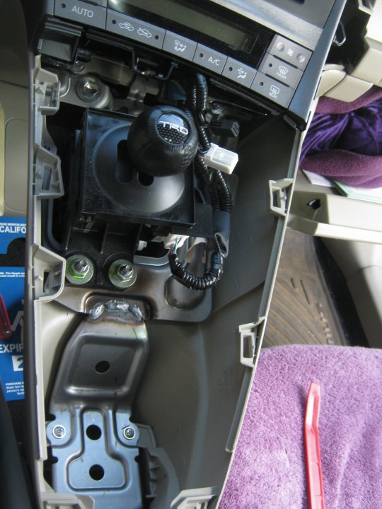

    Hi sfprankster, how hard was it to remove the original shifter? I tried to remove mine but pretty tough, I didn't want to break the whole thing. Just a thought because I want to get that TRD shifter you have. Cheers!
  14. sfprankster
    sfprankster Active Member
    Sep 25, 2014
    444
    490
    Santa Cruz Mountains, CA
    The shifter knob just unscrews counter clockwise. No need to remove anything else.
    The shifter bezel comes off with a gentle amount of leverage with a panel tool. I started on the edge nearest the driver's knee, and worked around the panel counter clockwise lifting up towards the rear view mirror/map lights.
    I do believe I'm the winner... :ROFLMAO:
    I found an actual weld in the Prius today...

    Oh. I guess My TRD lowering springs were a mild enough drop that alignment was still able to have it within oem specs.
