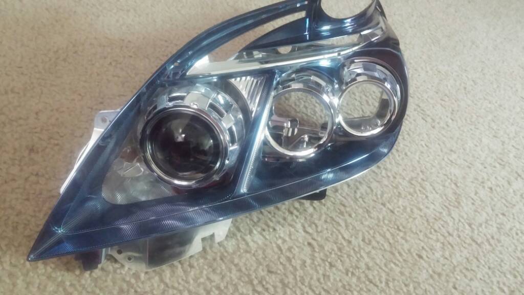

    I worked on this today.......these are just teasers
    More too come
    VS980 4G ?
    Tracksyde, Jayare, Burna J and 6 others like this.

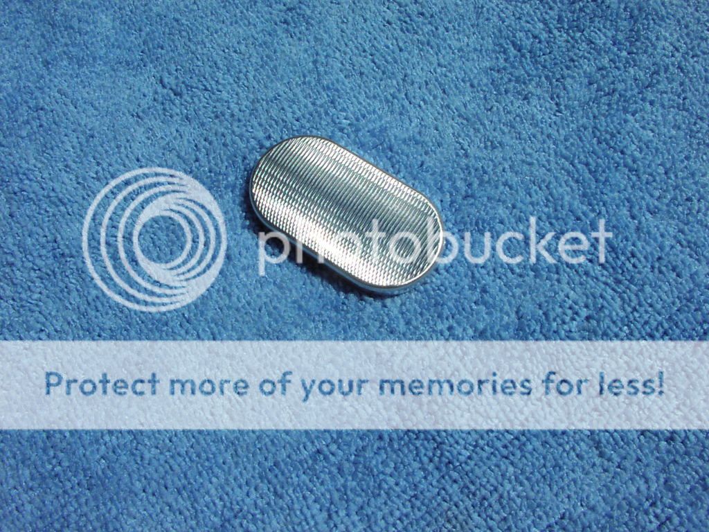

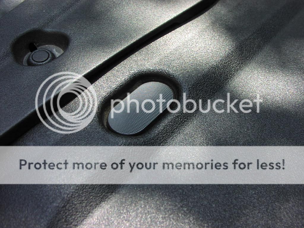

    Shortly after I posted this I realized that I put it in back to front. I was probably rushing the finish to beat sunset. Here's the morning after revision.
    Here's a few snapshots detailing how I fabricated the plug.
    20150417_164340.jpg 20150417_182516.jpg 20150417_183806.jpg 20150417_184806.jpg 20150417_191009.jpg
    I found a carriage bolt with a 1" head. Using an angle grinder and a dremel tool, I sculpted it to closely match overhead profile of the washer port. Then I hit it with a coat of primer, and a shot of 8V1, and installed it using he original gasket.

    No, that's the after pic.
    Perhaps "delete" is too strong of a term. Let's call this a washer port plug.
    It's using the original gasket from the washer port which keeps it raised a bit.

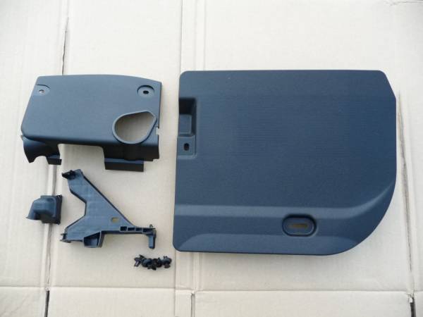

    Today's project: Inverter Cover (and Friends) Installation
    Before:
    After:
    The coolant bottle and the wiring harness covers were simple snap-ins. However, the inverter cover was made for Lexus & Prius v (a.k.a プリウスα). So it takes some tweaking to get this to fit in the ZVW30 just right.
    The inverter cover has three issues.
    1. There's a grounding bracket that interferes on the corner near the fuse box.
    2. There's a mounting hole which has nothing for the push-pin to push into.
    3. The radiator cover doesn't play nice with the forward edge of the inverter cover.
    The grounding bracket issue took a little work with a cutting wheel and some touch up work with a dremel sanding drum.
    For the mounting hole issue, I fabricated a fake backing for it. It's purely cosmetic.
    For the case of the interference between the radiator cover and the inverter cover ...
    I used my dremel sanding drum to shave the radiator cover a bit.
    There, it is.
