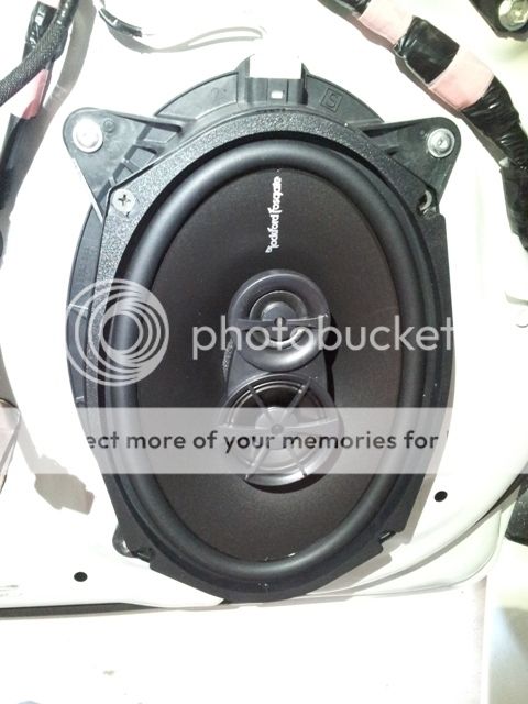

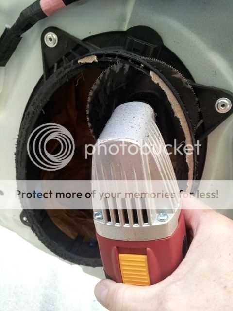

    Swapped out the front door speakers today.
    I used the stock speakers as mounts, which required trimming them so they're about 5mm shallower depth in order for the door panel to fit with these new speakers.
    This vibrating "multi-purpose" cutter made short work of that task. Took about 30 seconds to do what would have taken me 30 minutes with the dremel.
    The new speakers are RF R169x3 and they sound great together with the new dash speakers.

    Nice! Did you have to solder anything?

    I used the wires inside the stock speakers - I soldered female speaker connectors to the stock wires so they'd plug into the new speakers. Those wires are an uncovered copper braid, so I also slipped heatshrink tubing over them before soldering the connectors on.

    Search the audio forum here too. There are a couple of posts in there with more info and pics on hacking the stock speakers to use them as mounts.
    Honestly, it's probably easier to just use Metra mounts and wiring adapters. I just like fabbing stuff (or maybe a glutton for punishment) :sick:

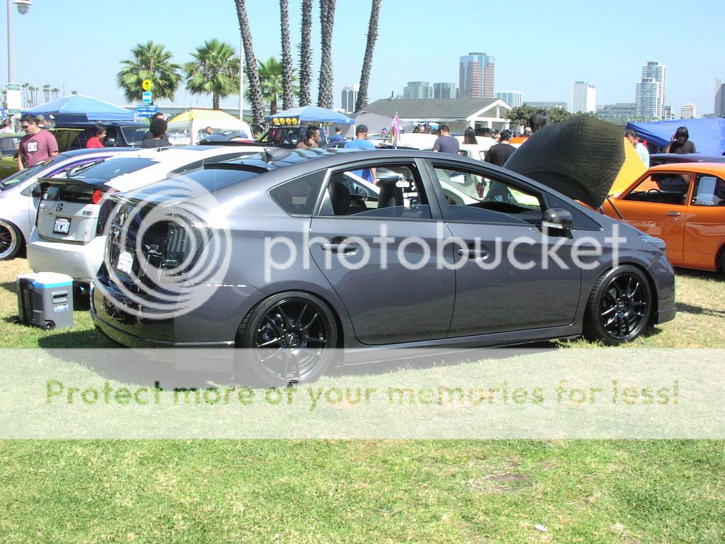

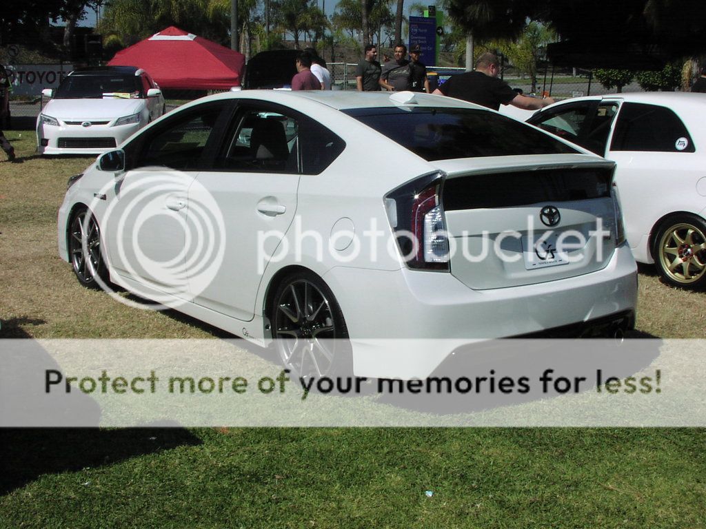

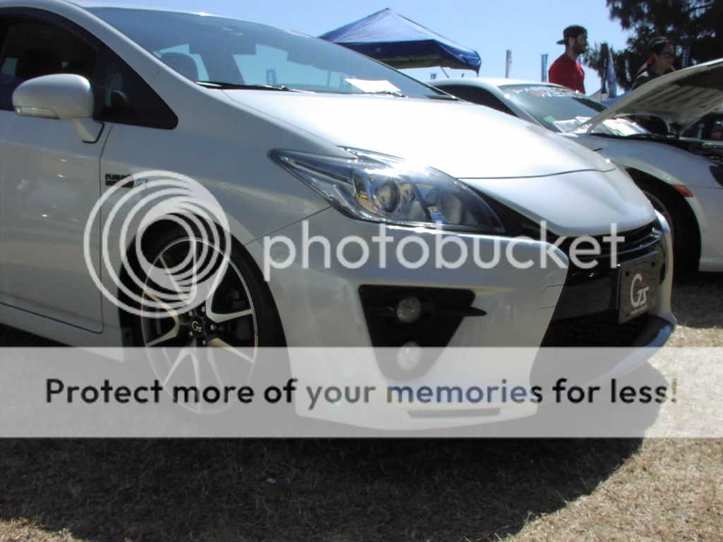

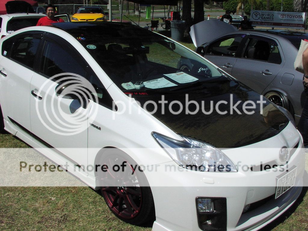

    Well after yesterdays all night Modd Party...... :):confused::sleep::sleep:
    Got up early this morning to meet up with @bino and @RightOnTime for the 20th Toyotafest car show, here in Long Beach.
    Congratulations to RightOnTime and his Beautiful Prius G' taking 1st. place. (y)(y)
