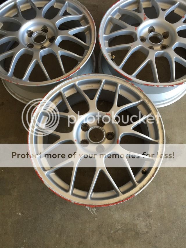

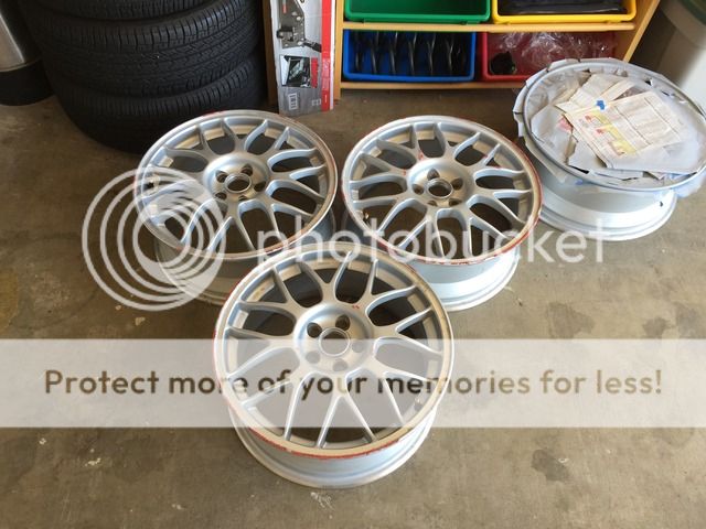

    This BBS wheel project is taking forever, but I think I'm finally going to test paint 1 of the wheels tomorrow on my day off.
    Here are some pics of the bondo work on the road rash and some gashes on the wheels. These wheels have been through a lot. They look a lot better now after a thorough sanding, cleaning and repair. Keep you guys posted!

    I'm worried all your hard work isn't going to hold up. Wheel repair like you are doing is normally filled in with metal, like brazing? In your case, maybe even something like epoxy putty or JB Weld would be more durable than the plastic body filler you are using? :unsure:
    These HTS-2000 brazing rods are available on ebay:
    Aluminum Steel Wheel Repair | AluminumRepair.com

    Hey bud, thanks for your concern and advice! I searched a lot about rash repair and read multiple forums. I used bondo spot and glazing putty for metal. A lot of the damage was multiple mini rashes (nothing super deep).
    Everything is smoothed out now. I'll update you guys with a pic of 1 painted wheel when it's done.

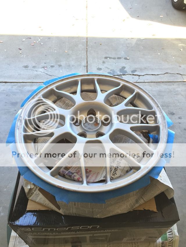

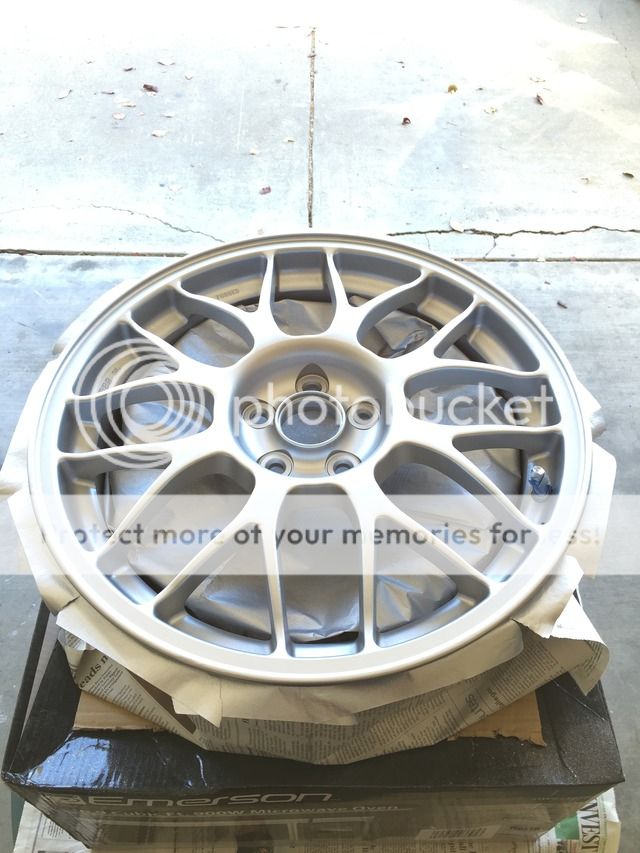

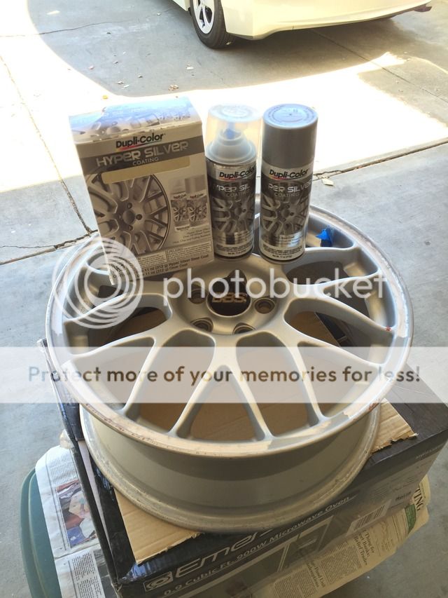

    Wheel #1 in progress...
    I'm using Duplicolor Hyper Silver color wheel paint and clear coat.
    Before painting.
    After 3 light coats. I will let this dry, pick up my son from school and apply a few coats of clear coat and report back later. Looks way better than before. Not bad for rattle can wheel paint!
