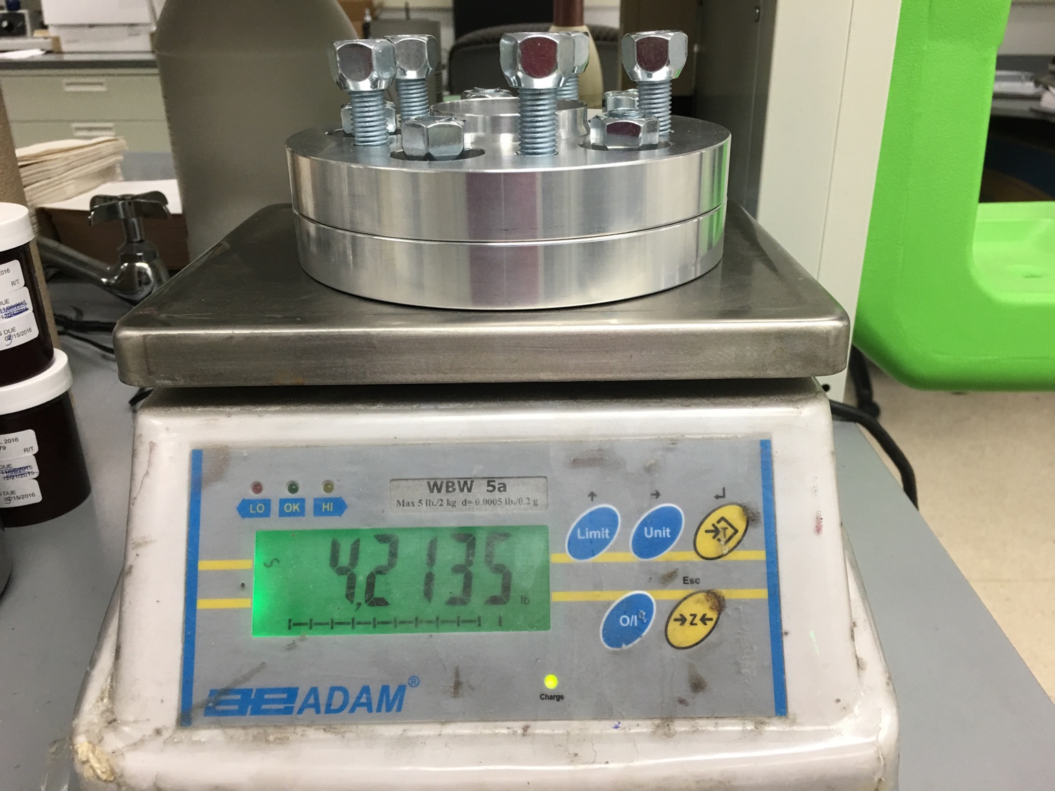

    Looks to be about 2.107 lbs per hub
    Negative.....just the rear

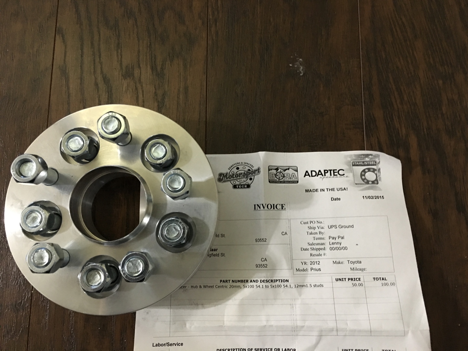

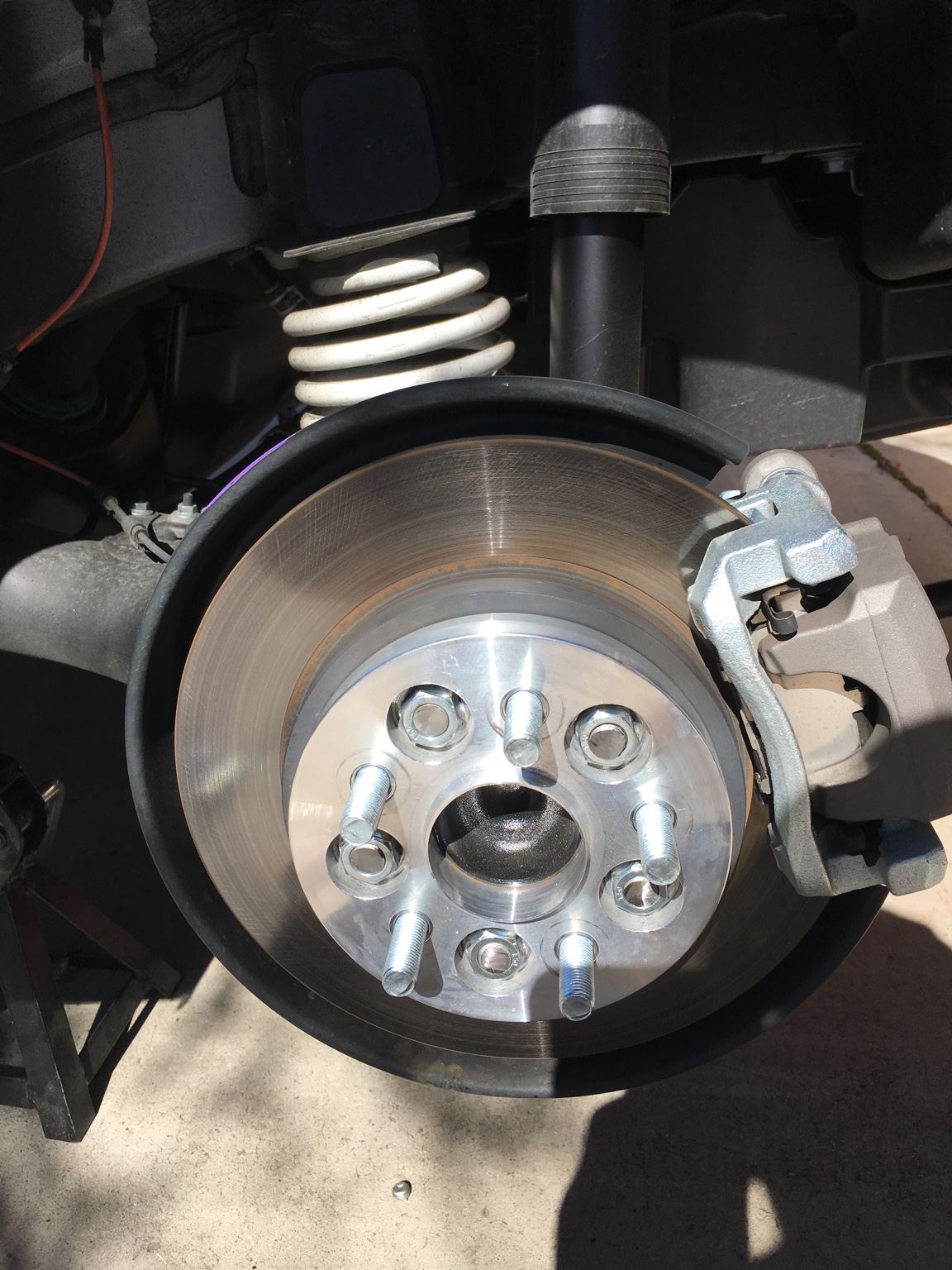

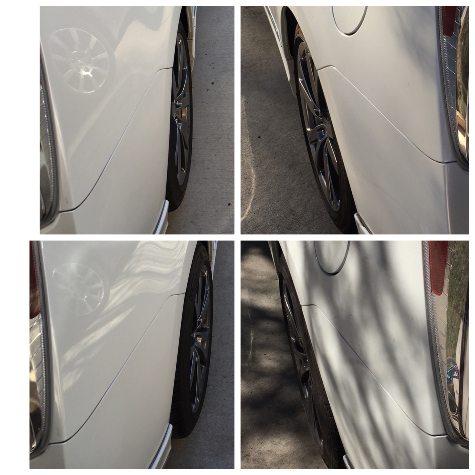

    I got the spacers on today before SuperBowl started.
    [​IMG][​IMG]

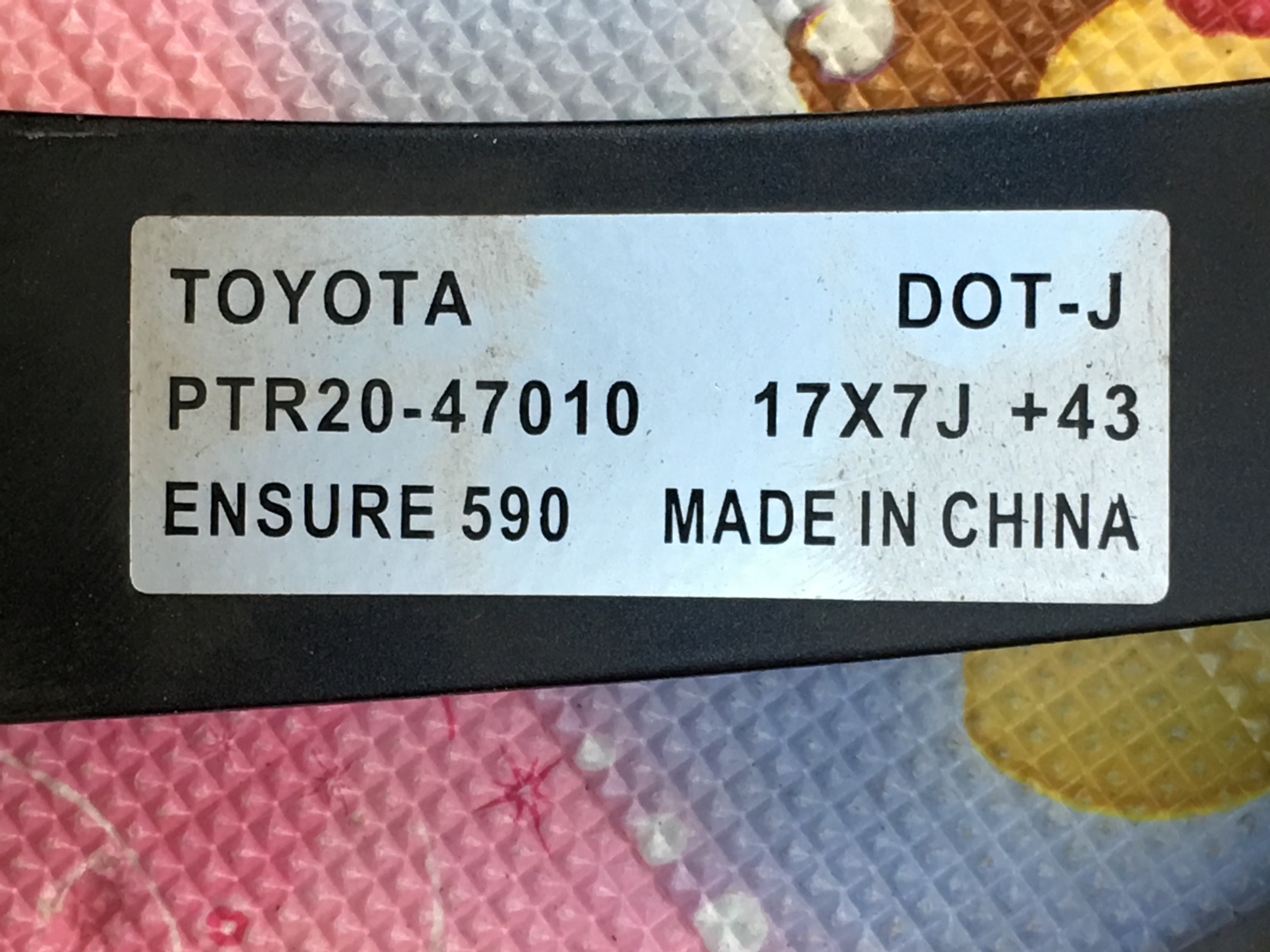

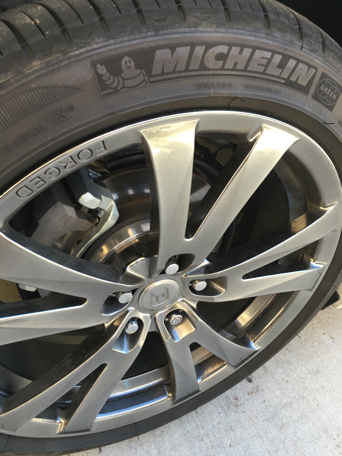

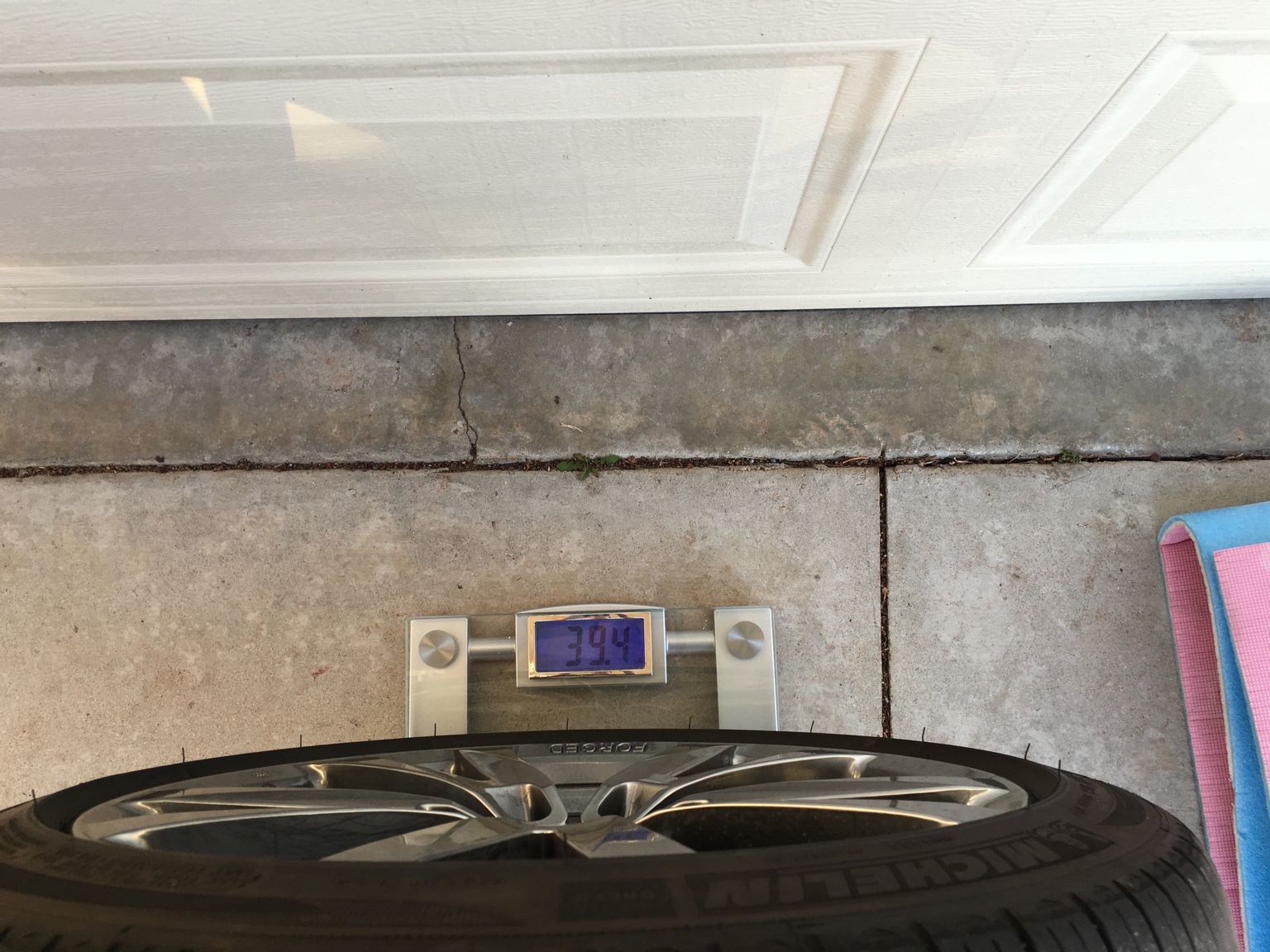

    Here are the specs for the Forged PPP wheels
    [​IMG][​IMG]
    I needed to shorten the OEM studs to clear the rim
    Top pics are before. Bottom are with

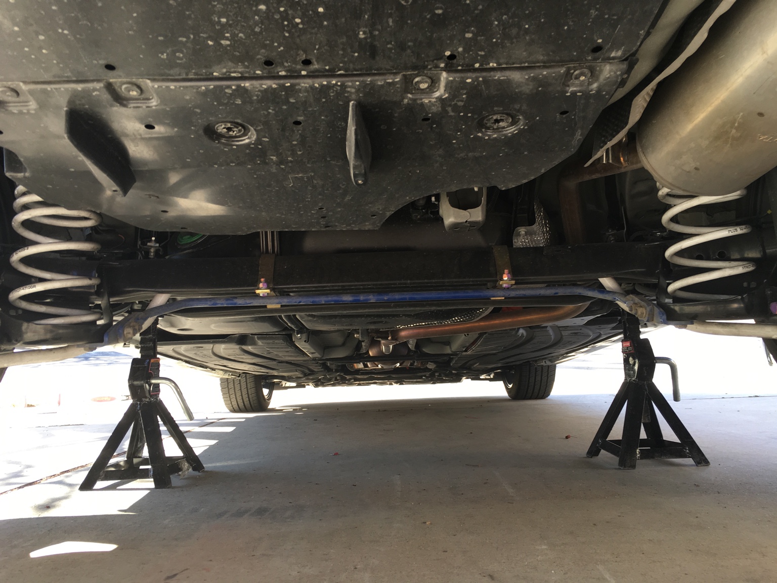

    While there I re-installed my Cusco Rear Sway Bar. So I have both the PPP & the Cusco Rear Sway Bars.

    How much did you need to trim the lugs?
    I was just checking out motorsport-tech.com. Everything I'm seeing there (camry, yaris, matrix) is 5x114.3 -- where your invoice reads 5x100. I am seeing the 5x100 20mm spacer listed for Scion FR-S.

    I needed to trim off 3 threads off each lug
