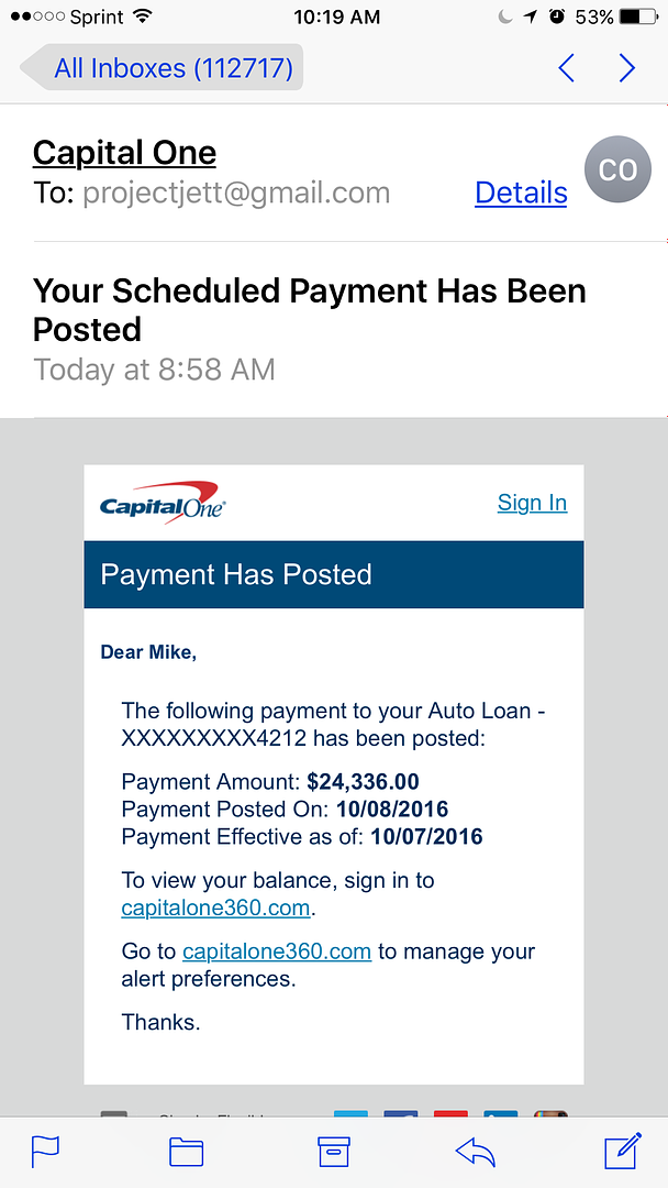

    the best modification to my prius..paid off...now its mine.
    Rebound, Lit Lit, HelloHybrid and 6 others like this.
  11. apt5020
    apt5020 Senior Member
    Jun 26, 2014
    881
    1,294
    Prius City, CA
    With 0 APR why rush the payment?
    Bluegrassman likes this.
  12. SubCode
    SubCode Senior Member
    Apr 22, 2015
    739
    1,341
    reducing my monthly over head frees up income to do other things...kids college fund, insurance, retirement....I actually bought the car @ 1.9%...so even that
    save 3000.00 and no more monthly payments...on a 1.9% loan

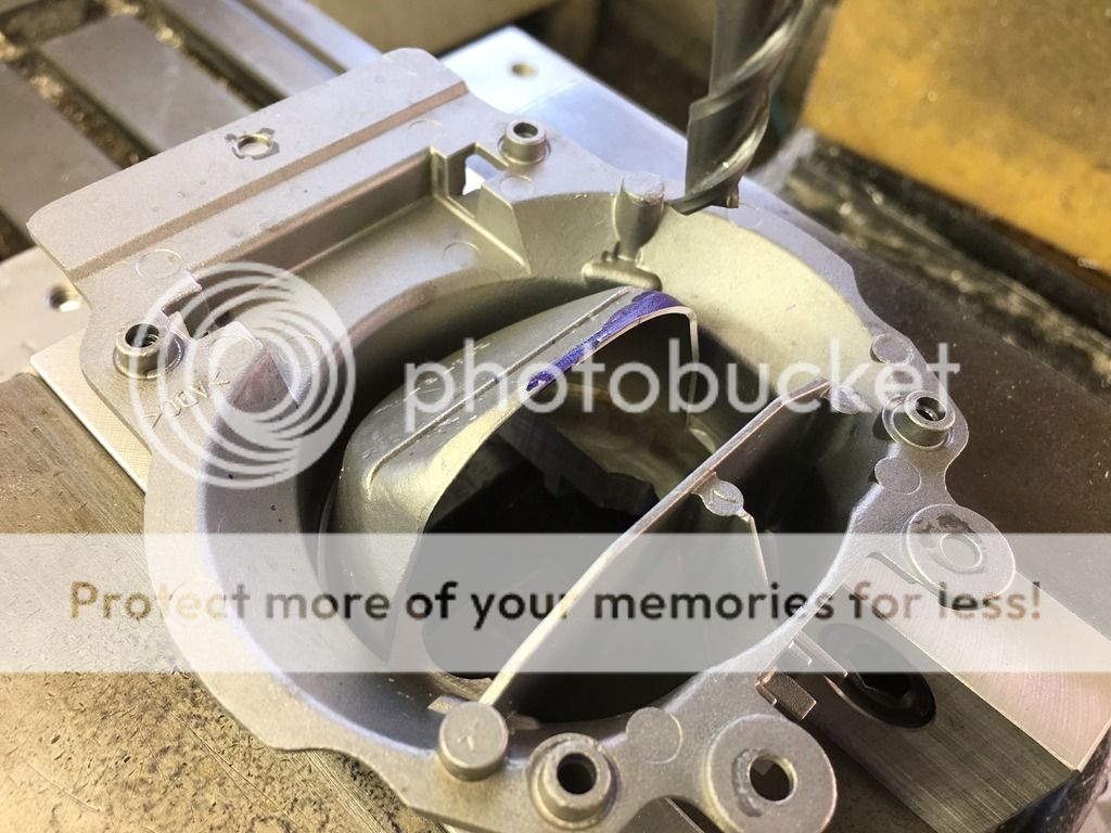

    Today's Project: Headlight Modding
    After some experimentation on some beater lights I got on eBay, I decided that I finally have the stones to bake my beautiful G's lights.
    These Koito 47-52 units are awesome. They look super cool on the car, and they put out a great spread of HID light. As a matter of fact, a lot of headlight modding jobs are to make USDM headlights as awesome as these.

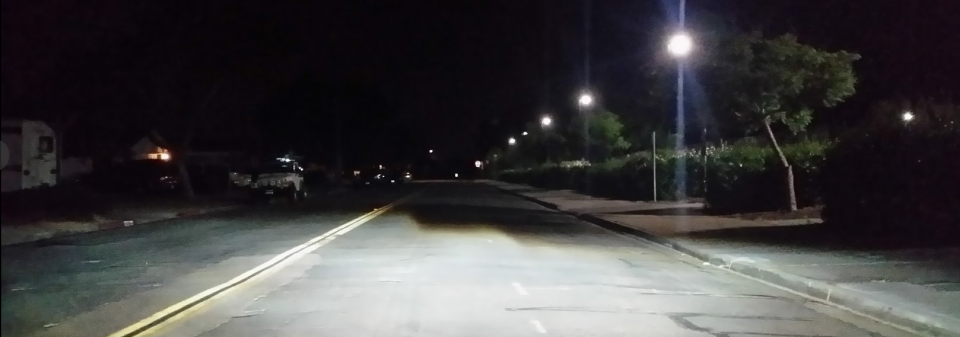

    But here's the problem.
    The JDM style cutoff for the HID beam is stair-stepped up to the left. That's great in Japan, where the oncoming traffic is on your right and the pedestrians, bicycles, and road signs are on the left. But on US roads this cutoff pattern is perfect for blinding oncoming traffic. To compensate I dialed down the height a bit. On dark roads at night this is scary.
    So, I'm on a mission to fix the cutoff.
    I ordered some extra Koito 47-52 projector guts ...
    Disassembled them ...
    And then handed the housings over to @Burna J for some machine work ...
    ... and voila!

    And here's the finished product:
    So much better. :whistle:

    Nice job bro. Interested to see what the cutoff looks like on a wall 25ft away
