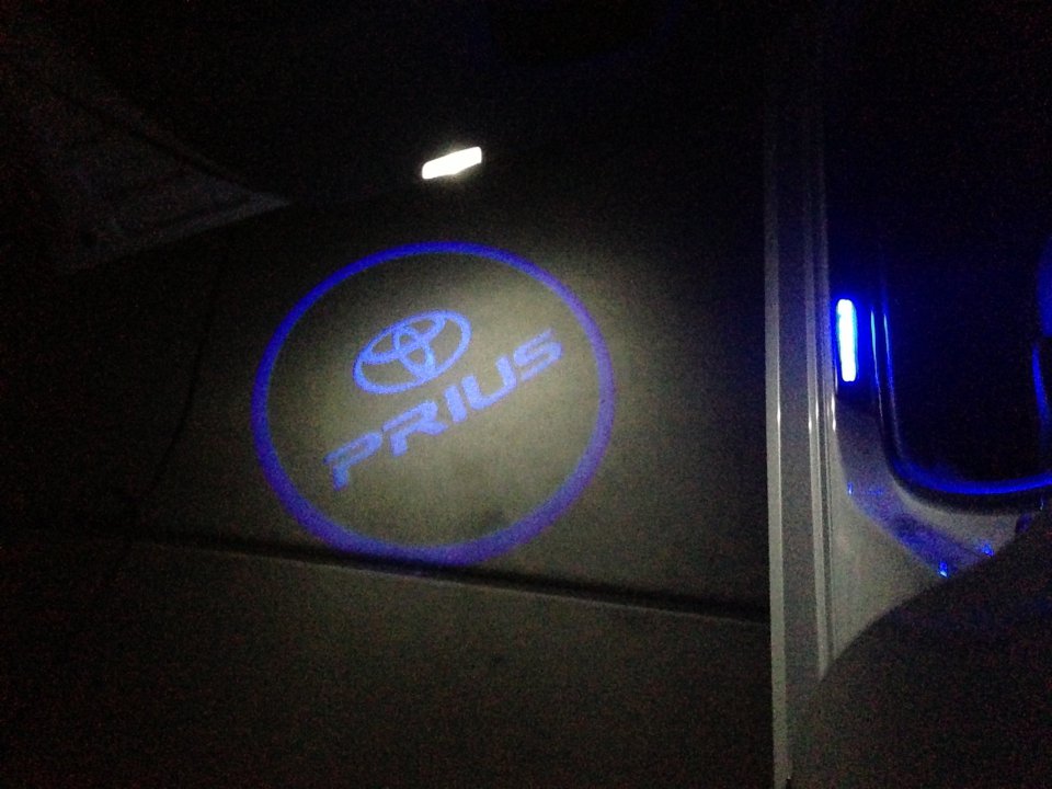

  12. D_H
    D_H Junior Member
    Jan 30, 2019
    Seattle area
    Hello Dawit,
    I know you've sold your Prius but could you tell me where you purchase LED Ghost Shadow Lights w/ the Prius logo? The lights on Ebay & Amazon only have the Toyota logo. Also can you give me details on the logo for that glove box I'm thinking of doing something similar? Thanks.
    Burna J likes this.
