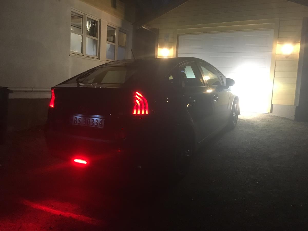

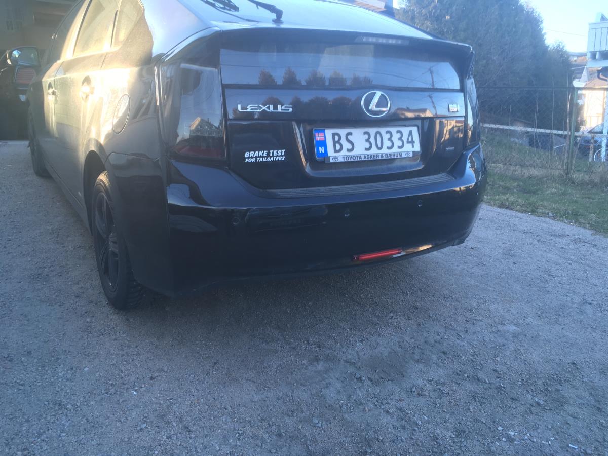

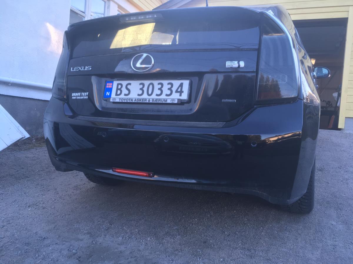

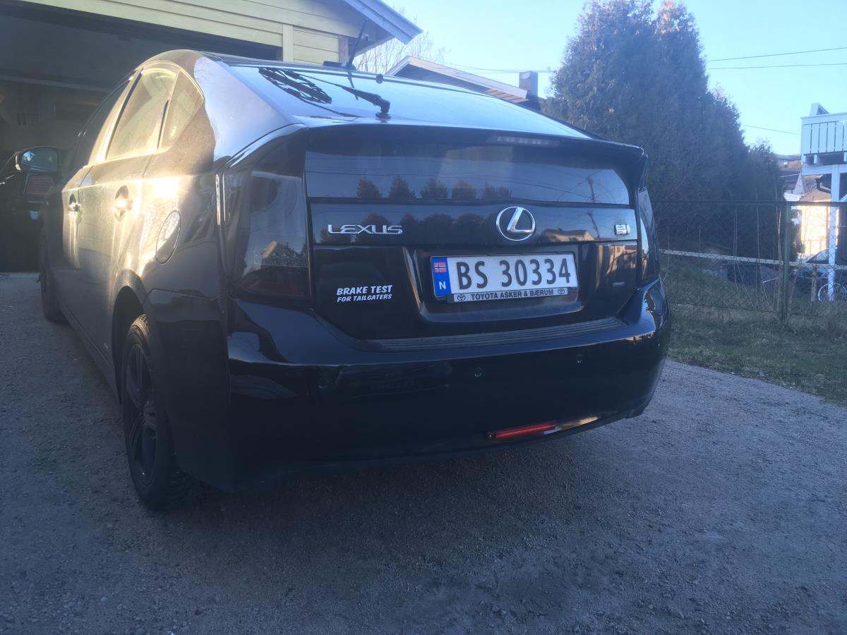

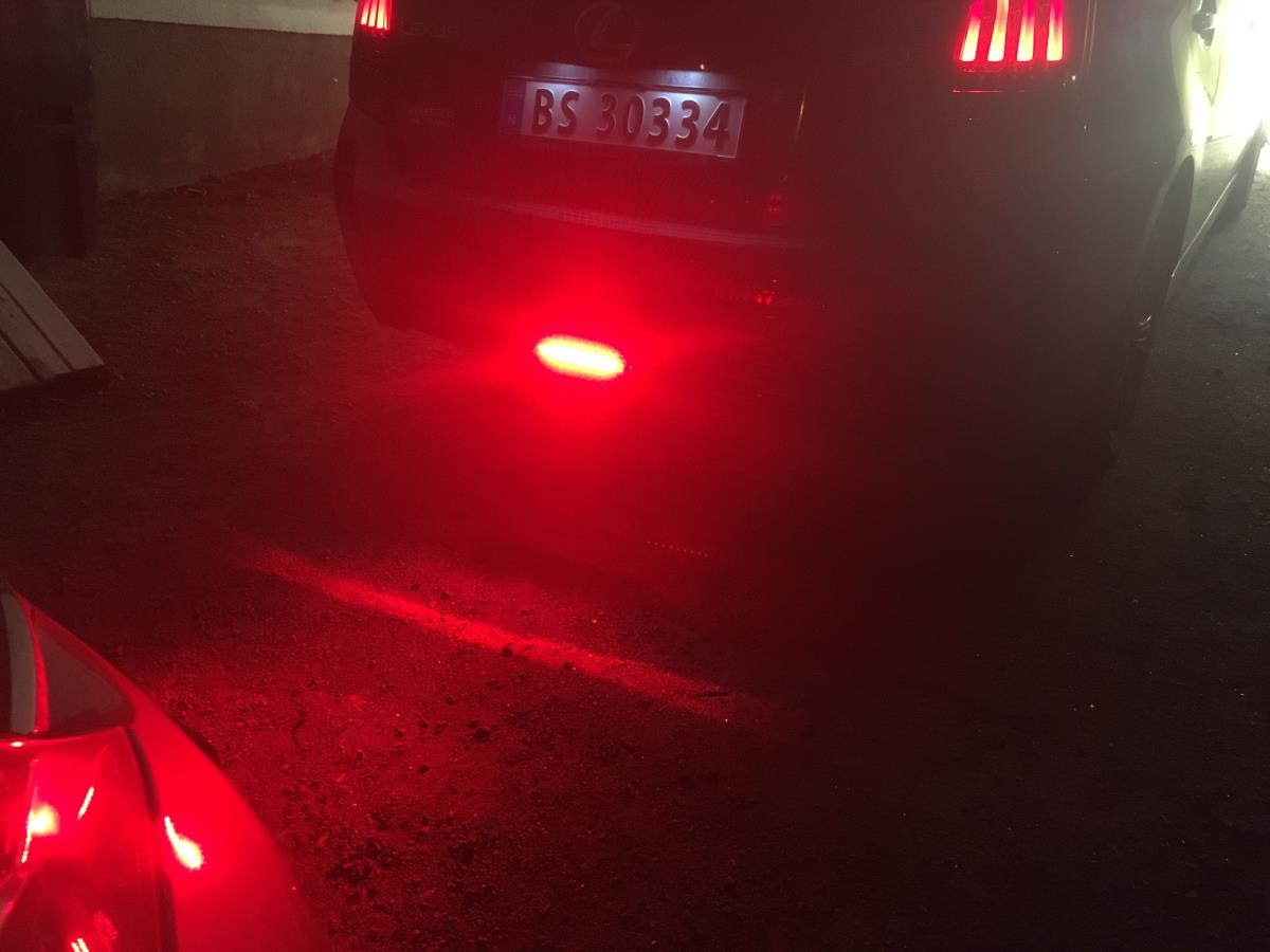

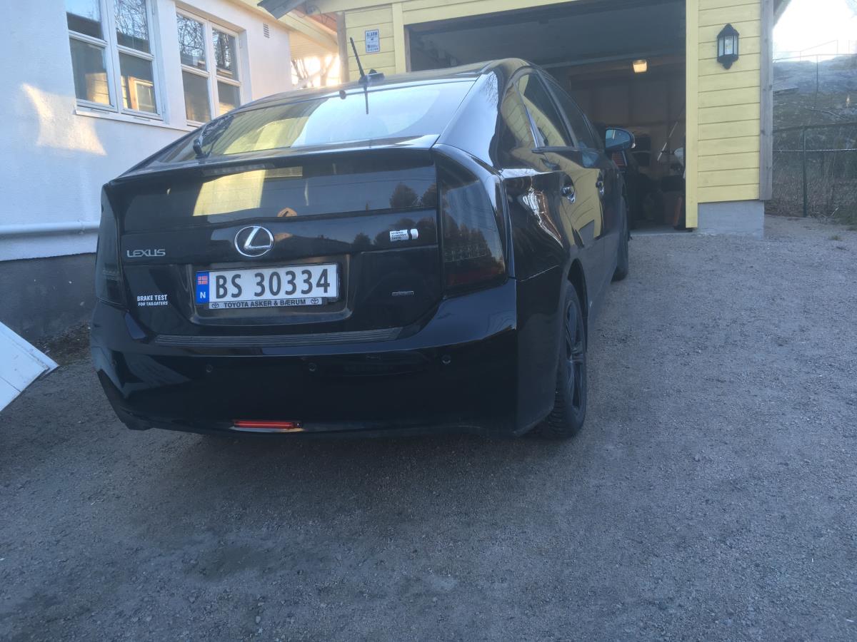

    Added a rear fog light strip today, the toyota dealership doing the PVC (periodic vehicle control) didnt like that my Prius didnt have any rear fog light even tho its not mandatory in Norway....... So i had to put one on, luckily i found a rear fog light strip thats E-certified as rear fog light. And connected it to what would give power to the original rear fog light in the original taillight, so the original rear fog light switch on the stalk turns it on and off. (really easy, i just put a scotch lock on the wire on the tailight connector, so it now steals power to the strip instead)
    light i used: 1x REAR RED FOG LED LAMP MULTIVOLT LIGHT E-MARKED 12V/24V TRUCK CAR VAN BUS CAB | eBay
