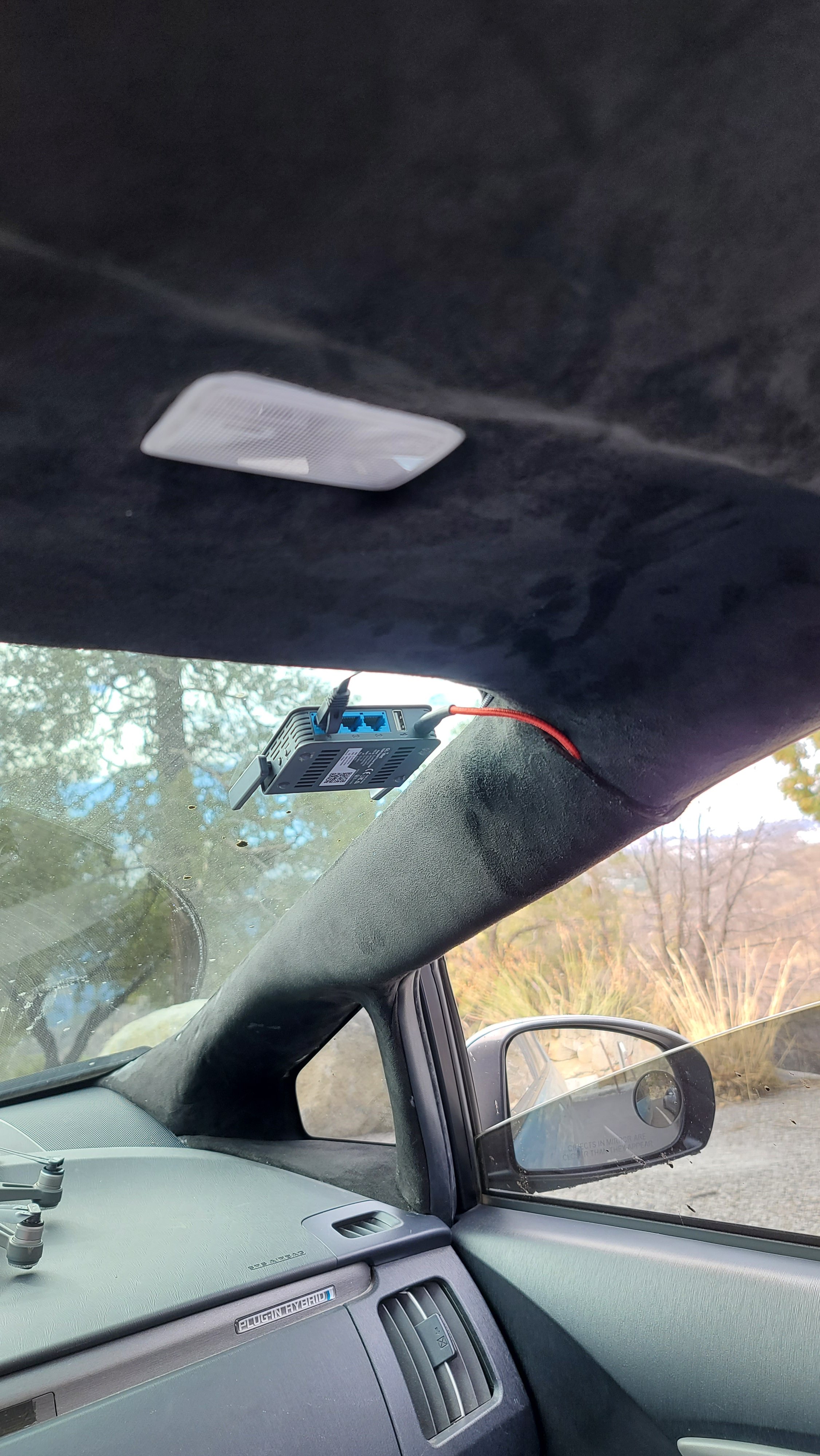

    Added black suede to the headliner, and pillars after adding sound deadening matt and foam padding to the ceiling. Also sprayed expanding foam in the various cracks/holes in the roof. The nose from the roof rack, basket and LED light bar was way too loud! Next up is to add sound deadening to the floor under the seats and the doors.
