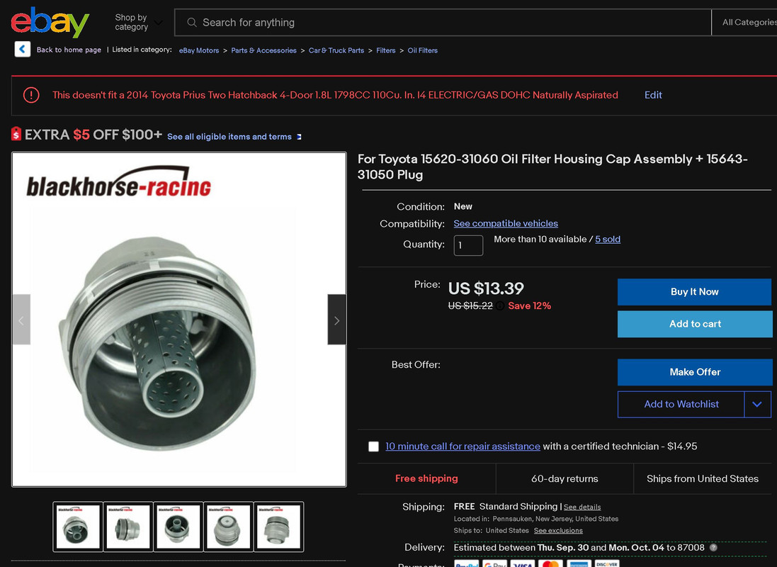

  10. xliderider
    xliderider Senior Member
    Apr 19, 2012
    8,140
    3,277
    Honolulu, HI
  11. StarCaller
    StarCaller Senior Member
    Feb 15, 2014
    1,283
    732
    Cedar Crest, NM, USA
    says it doesn't fit a gen3 prius /
  12. xliderider
    Apr 19, 2012
    8,140
    3,277
    Honolulu, HI
    Look in item description, there's a list, including Prius, Prius v, CT200h, Corolla, etc.
  13. ASRDogman
    ASRDogman Senior Member
    May 29, 2018
    7,899
    4,018
    You should write to the seller and ask if it WILL fit the Prius.
    If he says yes, and it doesn't, he gets to pay the return postage and give you a refund.
    If it doesn't fit, you're good to go!
    drbtz likes this.
  14. xliderider
    Apr 19, 2012
    8,140
    3,277
    Honolulu, HI
    The eBay "will it fit" guide is well known for saying it doesn't fit or isn't compatible when it is.
    Raytheeagle likes this.
  15. drbtz
    drbtz Member
    Feb 11, 2021
    102
    51
    United States
    I got one for $10USD. Also that one you linked has a center bolt which is similar to the RAV4 hybrid but my current cap has no bolt so I chose a model that didn't have one either.
    Here's the one I bought
