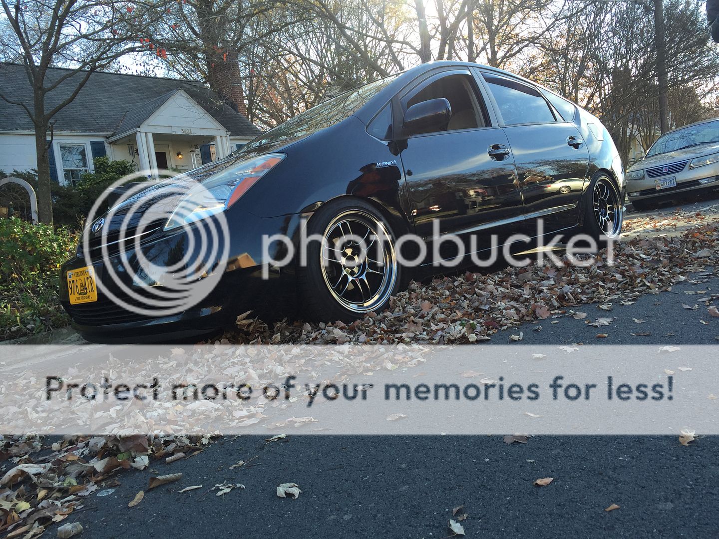

  15. Knightrider
    Knightrider Member
    Feb 21, 2019
    150
    36
    Kansas
    I just upgraded to an 05 rear Matrix sway bar- its amazing the difference it's had. Swapping thr front later in week. Front is from an 05 Celica.
    NOLA_Akita likes this.
  16. Knightrider
    Knightrider Member
    Feb 21, 2019
    150
    36
    Kansas
    What wheel setup is this??
    Suspention?>

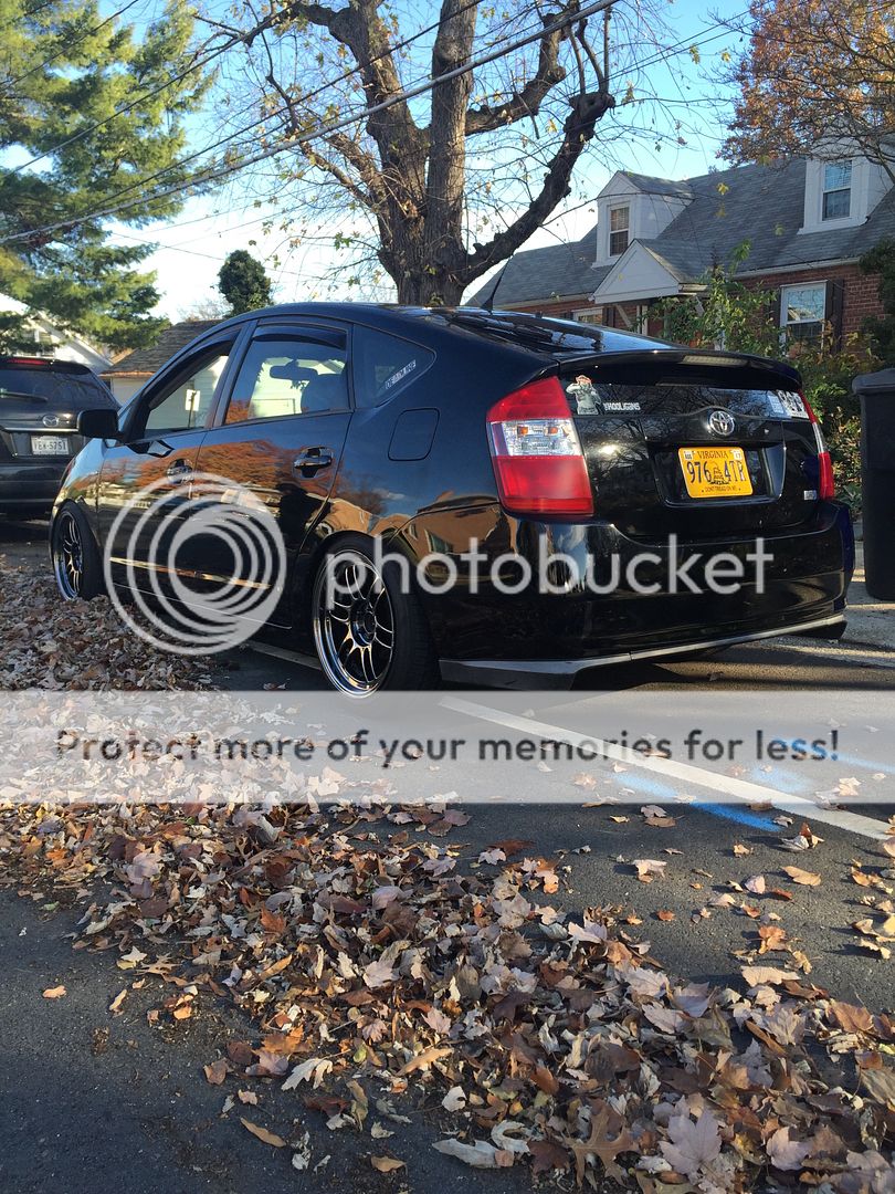

  20. Knightrider
    Knightrider Member
    Feb 21, 2019
    150
    36
    Kansas
    I am hoping I will be able to use a lift and get it swapped soon.
