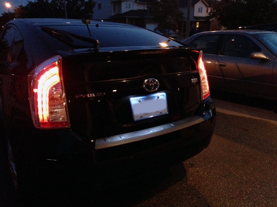

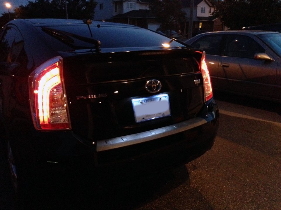

    Installed Toyota Hybrid Nation badge. You know, to show how dorky I REALLY am...

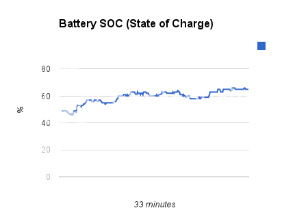

    So, on to the battery test results from 1994 seconds (33 minutes) of commute to work. Mostly flat, slow moving traffic but not much stop and go:
    Battery SOC (state of charge)
    Looks right. Would like to capture some data coming home the other way where you can regen to what seems to be 100% on the battery bar graph. It would be interesting to see how much charge truly accumulates.

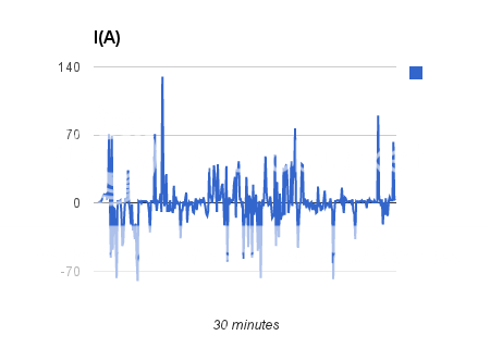

    I believe this is amps going in and out of the traction battery / motor-generator. Also curious to see what this does on a long regen downhill.

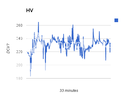

    HV. Battery total charge. Seems to be mostly between 220-240V with only a few excursions. Predictably loosely tied to the state of charge graph.

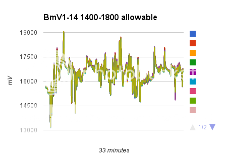

    This next graph is the more telling graph for battery condition. There are actually 14 cells here graphed one on top of each other. Mainly what you're looking for here is one cell that deviates from the others. They all coincide pretty closely so that's a good sign. (NOTE: As expected this graph is identical to the HV graph as this is just a breakdown of the individual cell voltages. (Multiply these volts by 14 to get the HV voltage at any point along the graph))
    In the previous chart there is visually some slight deviation but it's hard to tell how much, so I did an experiment to see what just a 2% deviation would look like. I took one cell's data and skewed all it's values down two percent and re-graphed it.
    2% turns out to be really noticeable so seeing a cell going bad would be easy with this device.

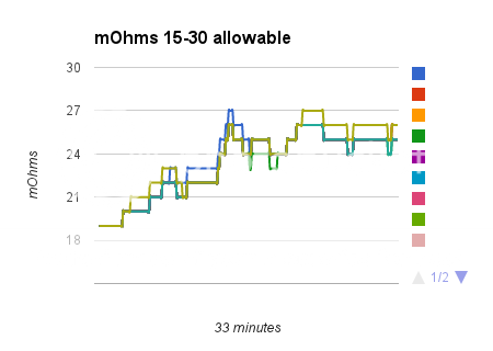

    Here are the 14 individual HV cell resistance readings all together. This is apparently a strong indicator of battery cell health. These are well within the allowable range. You can see the values start going up and topping out as the battery warms up. If a cell starts going bad, it's resistance will increase in all conditions and deviate from the others. This is caused by 'sulfates' / deposits / breakdown of the cell's inner structure. You would probably start to notice a spike in temp in that region of the battery pack too.

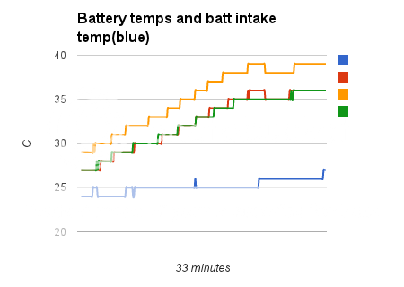

    Battery temp graphs. The blue line is the incoming temp to the battery. It went up a couple of degrees, probably due to the latter part of the drive that went into the valley where the temp is significantly warmer. The three battery temps are pretty close to each other, 1 and 3 being identical, my guess is that they are on either end of the pack. The number 2 temp is probably the temp in the middle of the battery pack so understandably warmer.

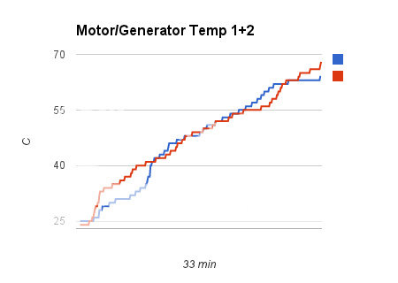

    Here's the motor/generator temps. Until now I thought there was only one traction motor...maybe there's two or there are two windings that are monitored. They looked to be leveling off, but it would have been interesting to see where they would top out on a longer drive. This data could be good to compare from one historical reading to the next and see if the motor windings are breaking down, rising in resistance and heating up over time.

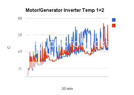

    These are the temps of the inverters that supply the motor/generators. Pretty spiky, this looks to be load dependent in an immediate way. Otherwise, not sure how interpret the data. Could be useful to see mass increase in temp in the same way as the motor/generator temp data.

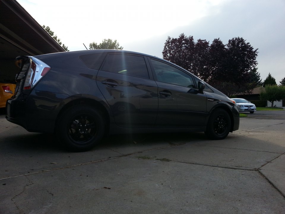

    Tinted the windows with Formula One Pinnacle(5% on the back and legal 50% on the front), Removed the wheels covers and painted and installed the 1 1/2" hub covers.

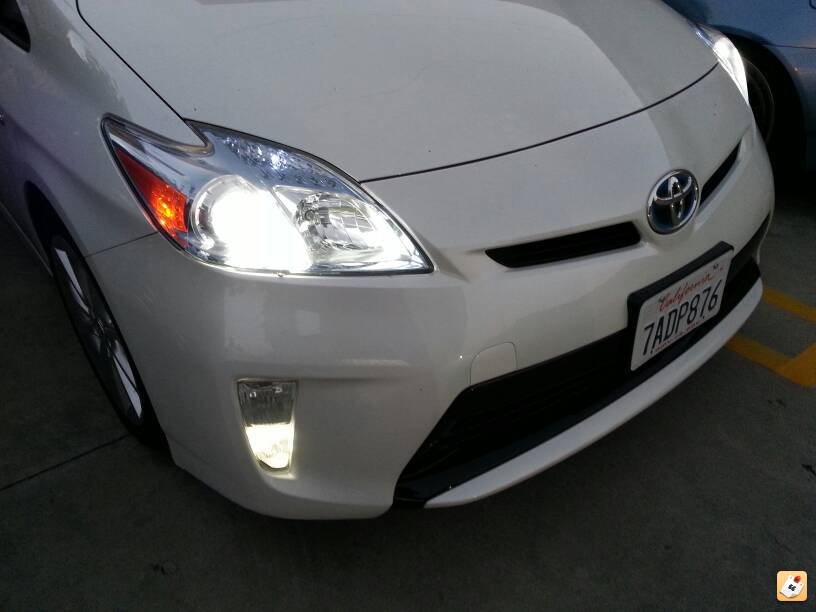

    Installed my HID kit. 4300k to match my drls.

    Those DRLs are at reduced power, right? Didn't you rewire them with a control module?

    Yes the drl is at reduced power.
