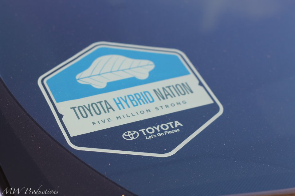

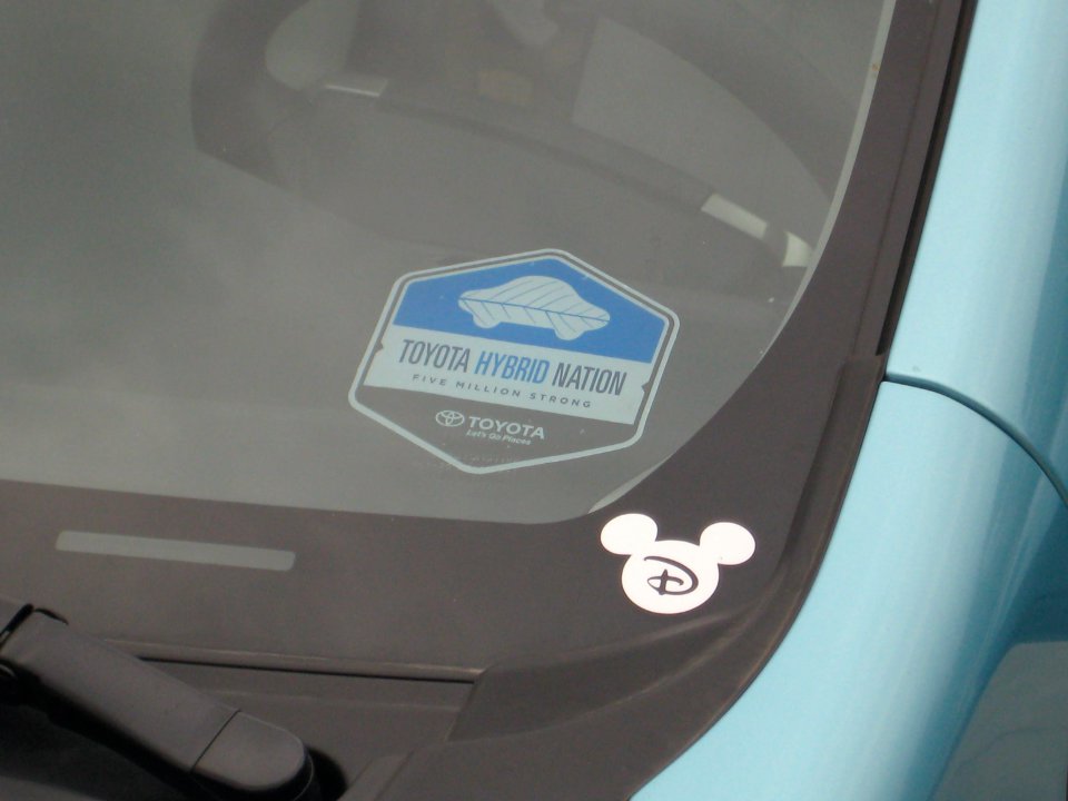

    Added my Hybrid Nation badges!
    Here's one of them... Sorry for all the dust particles... hadn't washed the Flyer yet lol

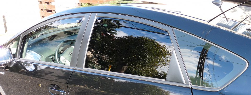

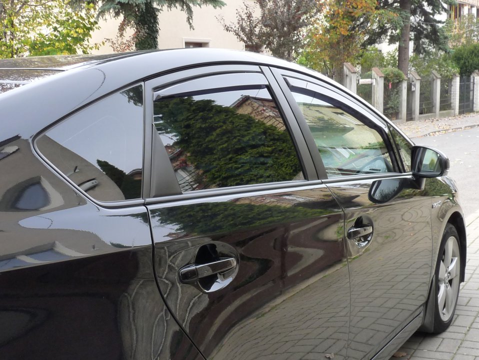

    1. Couple days ago I installed windows deflectors. Rainy season is coming - I hope they'll be very useful during fall and winter. Original Toyota deflectors in local dealershop costs ca.250 USD. Found Internet shop in Poland - similar items for 30USD only. Looks good, also the material used seems to be good quality and they fit my dark tint on the rear :)

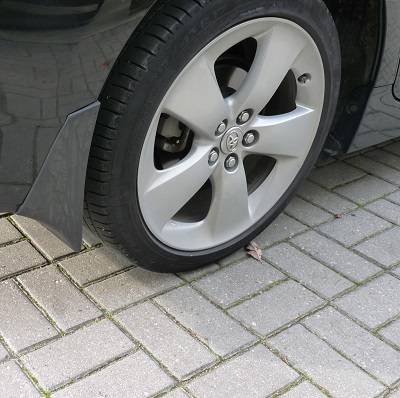

    2. Mudguards front and rear - done by Toyota - 100USD both pairs.

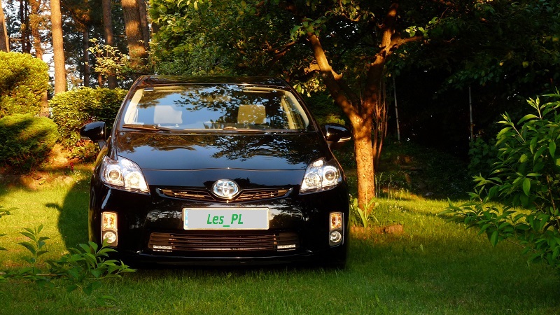

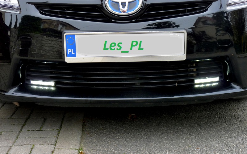

    3. Daylight LEDs by Philips DLII:
    4. From time to time using Mantis Instant Shine - enjoying the view in sunny and cloudy days :)

    Added my Hybrid Nation Badge to the C, now both Prii have their badges…

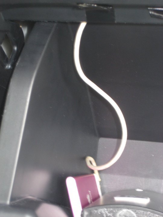

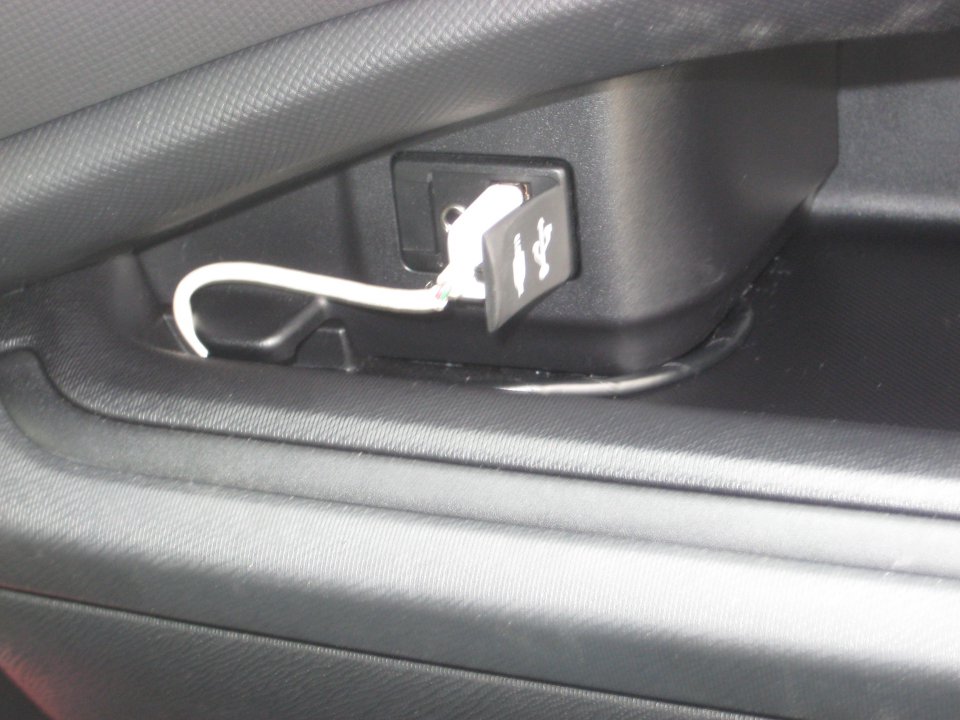

    Also ran the iPod cable through the dash… Got tired of the cable coming down the dash and then into the glove box… so annoying… lol… My OCD kicked in…

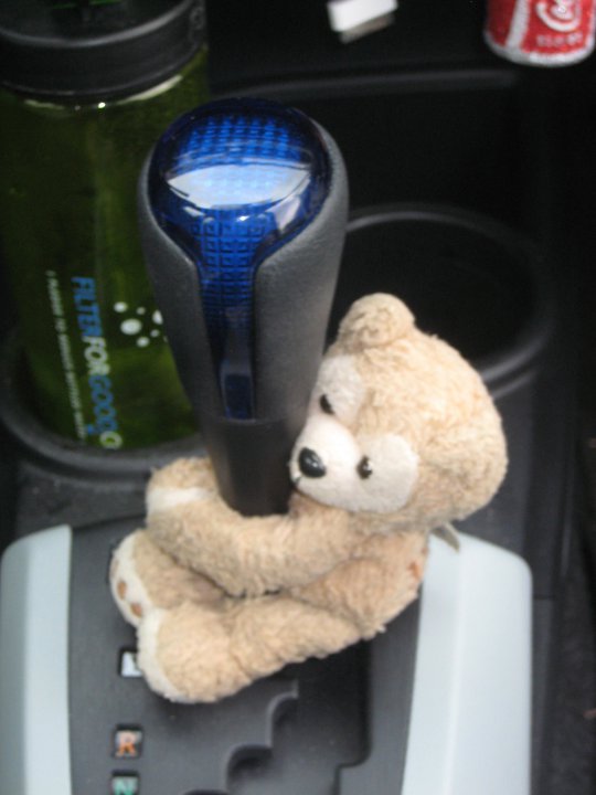

    Also added Duffy for the other half for commuting company LMAO…

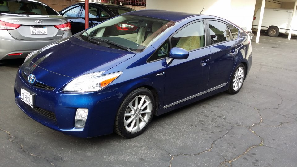

    Just installed 17" lexus CT200H rims on 205/50/17 yokohama tires, trd lowering springs.

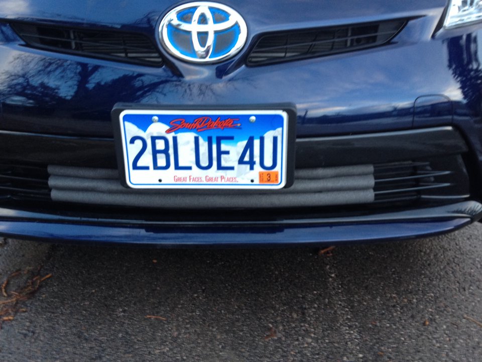

    Blocked the front grill. It was 45 degrees today, so I thought I would give it a shot. Total Cost $1.58 + 1 hour time.

    see my photo.

    nice, can you explain what you did there... i see you said you got a 7mpg gain by doing this... i could use a 7mpg gain... im all the way down to like 48mpg where as the summer i was over 50mpg :(

    The following is a short lesson on how to do the Gen 3 lower grill block. 1st step: Purchase 7-8 foot piece of 3/4 inch pipe foam with built in split. I purchased mine at Ace Hardware for $1.49 plus tax. You will need to make 4 pieces. The lower 2 pieces are approximately 2 1/2 feet long. The upper 2 pieces are each about 1 foot long. Step 2: Measure the lower 2 pieces for overall length needed and cut. Step 3: Insert 5 notches to line up with the verticals in the prius grill. Make notch about 3/4 of the way through the tubing. THE LOWER 2 PIECES ARE IDENTICAL. Step 4: Insert lower 2 tubes around the horizontal lattice of the grill. Do not insert BETWEEN the lattices. Notches should line up. When 1st tube is inserted, it will appear loose, but when 2nd one is inserted the fit will tighten snuggly. Step 5: For top 2 pieces, cut each tube 1/2-1 inch longer than necessary so part of it can tuck behind license frame. Only one notch is necessary. Step 6: Fit 2 upper tubes into place.

    Les_PL , I like the location and install of your DRL. Did you install it yourself?
