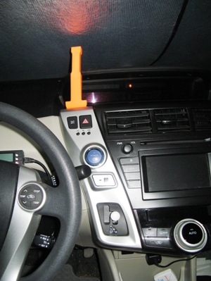

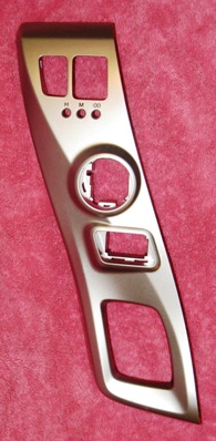

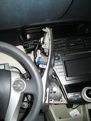

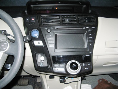

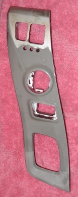

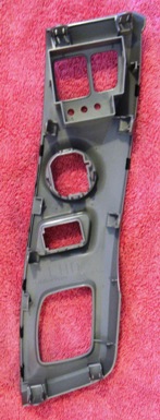

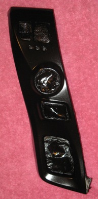

    I am going to start with my latest modification. I decided that the silver start, park, hazard and shifter surround panel would look better in black.
    The panel is very easy to remove. Just pry with a plastic wedge on the top to release the clips. The bottom comes off with your fingers pulling on it.
    The hazard switch pack, the start button and park switch wire connector blocks unclip from the back.
    The switched remove by releasing their own tabs.
    I sanded off the very thin silver paint coating with 400 wet or dry paper.
    After masking, painting and letting the paint to dry, reassembling took just five minutes.
